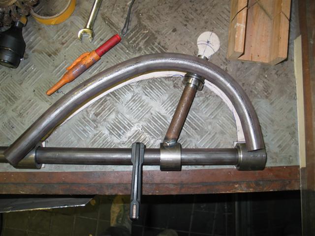

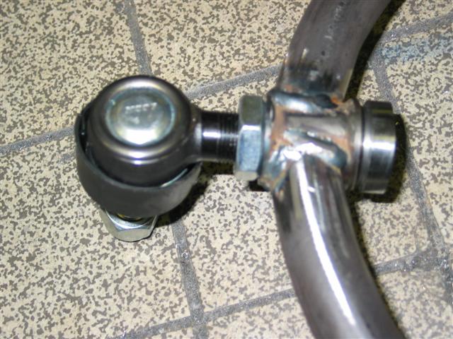

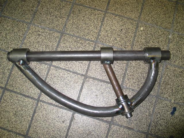

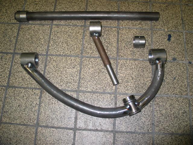

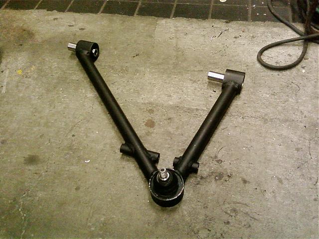

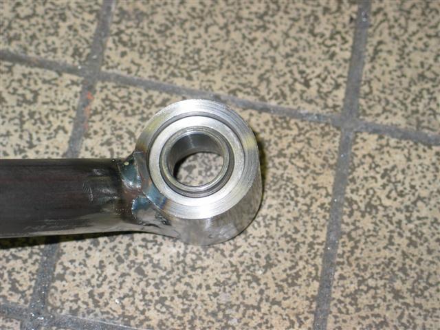

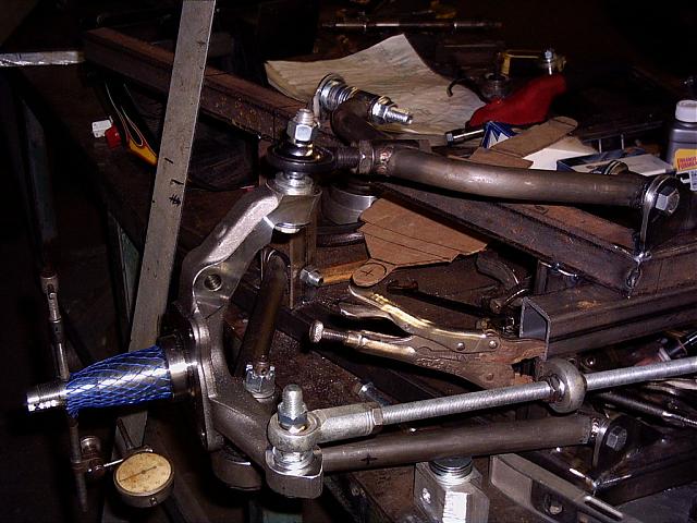

first upper arm almost ready

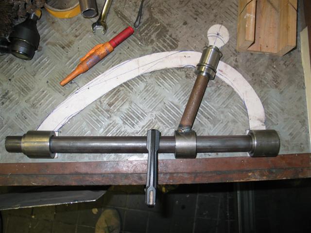

first made a welding mould ,did bend the tube (yes decided to do it myself )
i already made the tubes for the sphearical bearing
hope to have the front arms ready by the end of the week (try to work every evening)
i'll keep on posting as i progress

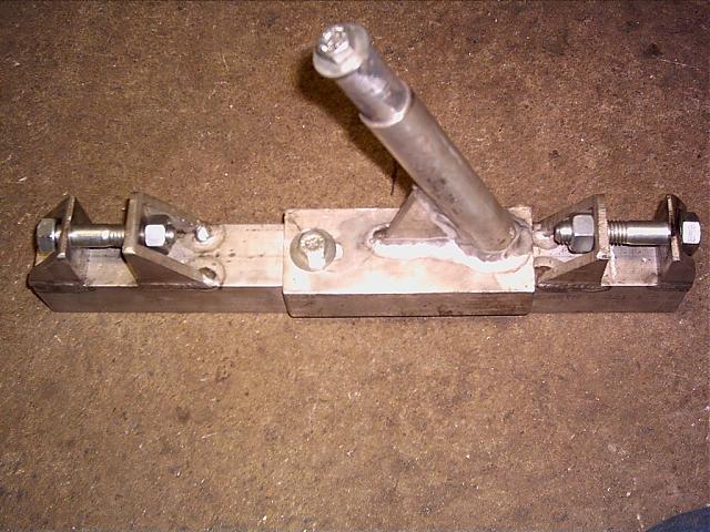

Frank;
Nice looking work.
I hope you don't mind if I make a few suggestions to possibly help a little.
I see the cross shaft in your fixture looks nice and solid..try to index the center sleeve so that your repeatability is there, and also if it needs to be moved in the future to create more or less caster.
If you use a rod end at the top of your upright you can shim it up or down to change virtual swingarm length and roll center...I have seen some high misalignment rod ends that will go 24 deg., plenty enough for full travel.
Please understand I am not criticizing here just throwing a few hints your way....your work looks great and the finished product should be good looking as well as strong the way you are progressing.
Phil

Hi Phil as i always say any help is welcome
i'will post a picture as it is going to be and if you can try to explain again what you mean because i don't get the picture

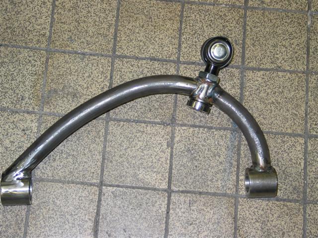

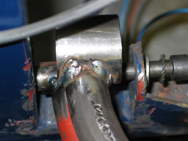

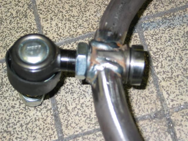

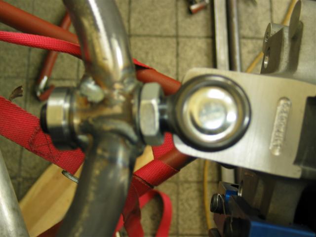

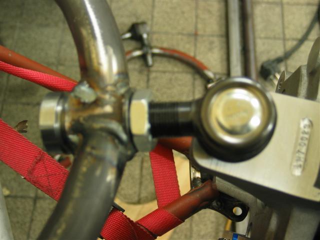

pictures with the balljoint and the bottompicture is a original upper arm

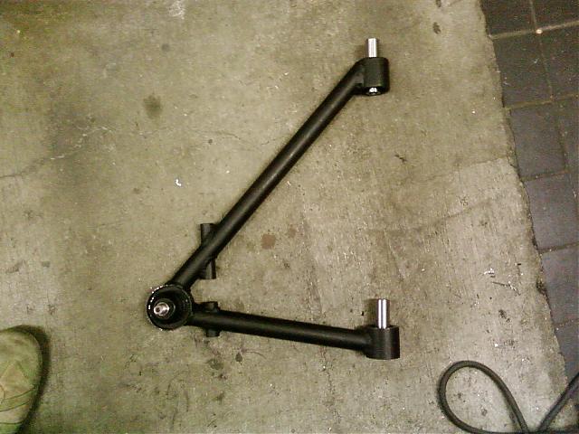

Name:	IMG_2822 (Small).jpg

Frank;
Sorry if I was not so clear, but what I was saying was to lock your center part of the fixture that locates the threaded sleeve for the upper joint, and if you can make sure it goes in the same place when making the opposite side. I have a fixture patterned after an original set of uppers, and it can be moved to fab arms that will add some more initial caster as some of the cars could not achieve enough by sliding the arm rearward..they simply hit the mounts on the tub.
Also I see your are using an upper ball joint similar to a tie rod end which has a taper bolt which is a nice fit but doesn't allow shimming to tune the roll center. I was suggesting a taper bolt for the upright, with a straight shaft on the other side. This will allow the use of a rod end which can be shimmed up or down to change your roll center. Maybe it would be easier if I posted a couple of photos?. I am working on a front end right now and I could take some photos and post them tommorrow (Thurs. for me).

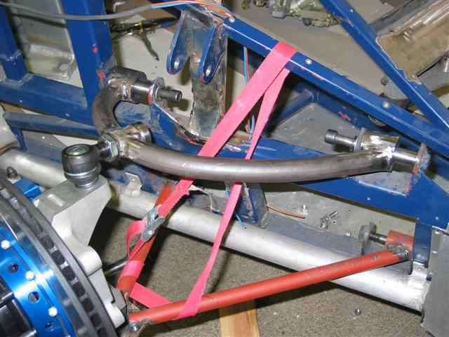

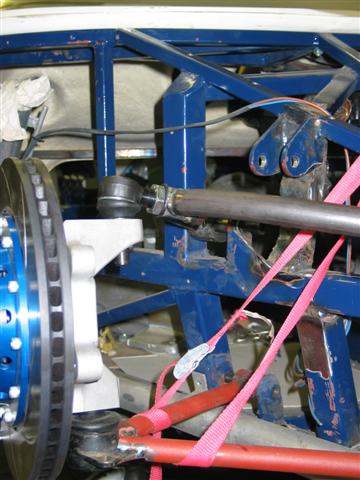

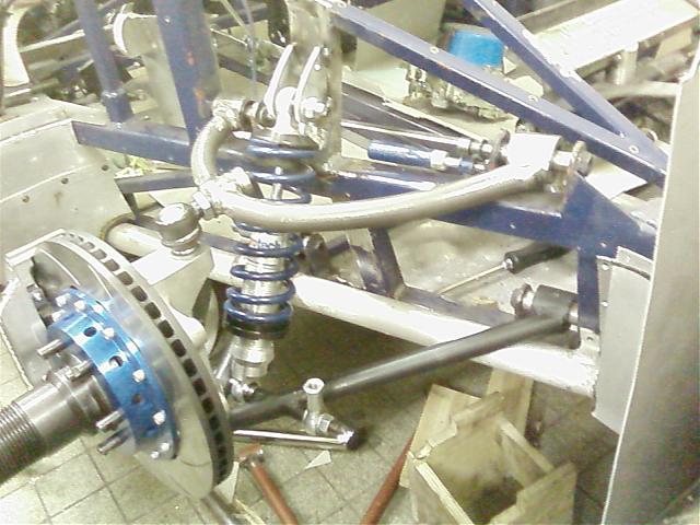

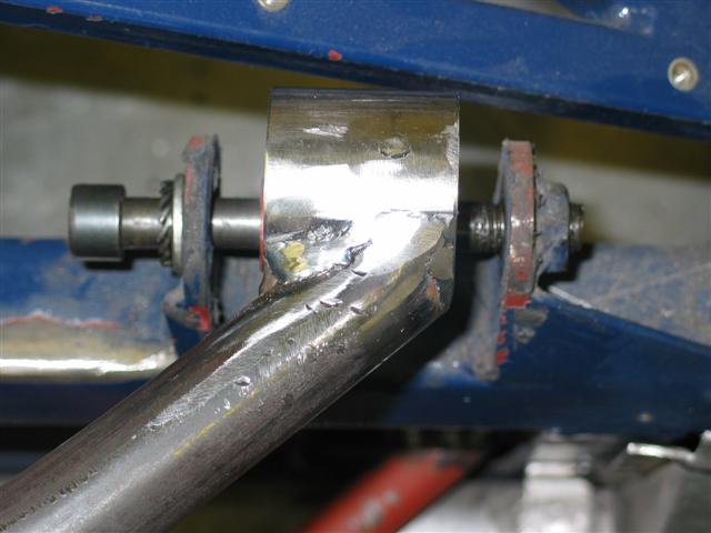

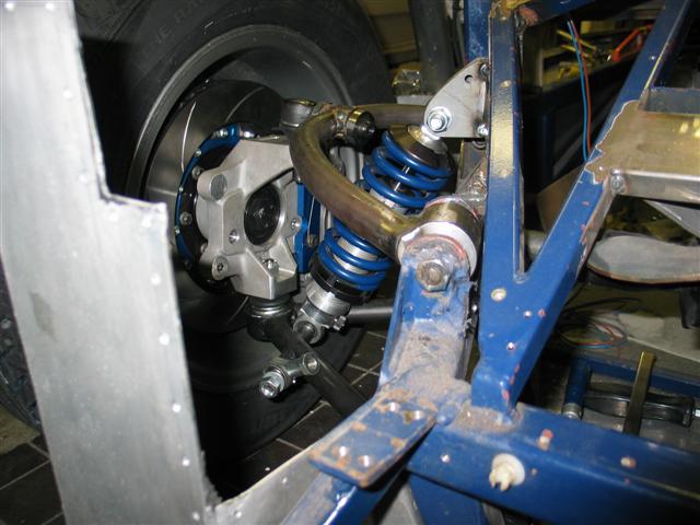

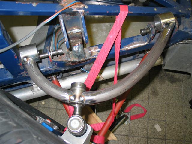

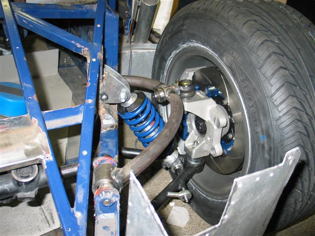

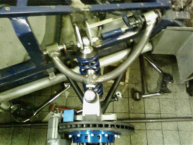

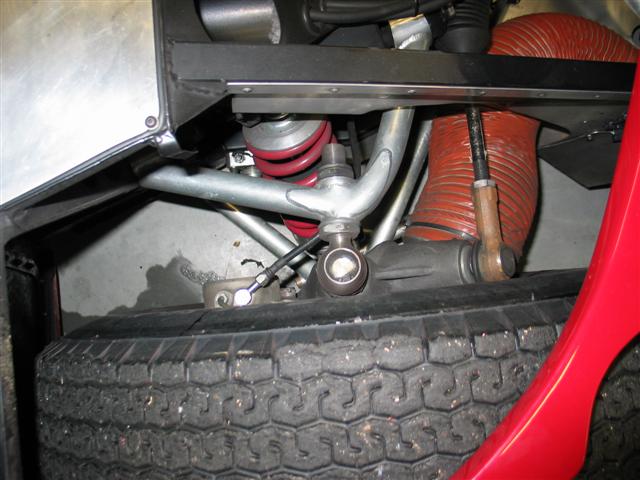

upper arm fitted
also pictures of the camberadjustment min and maximum

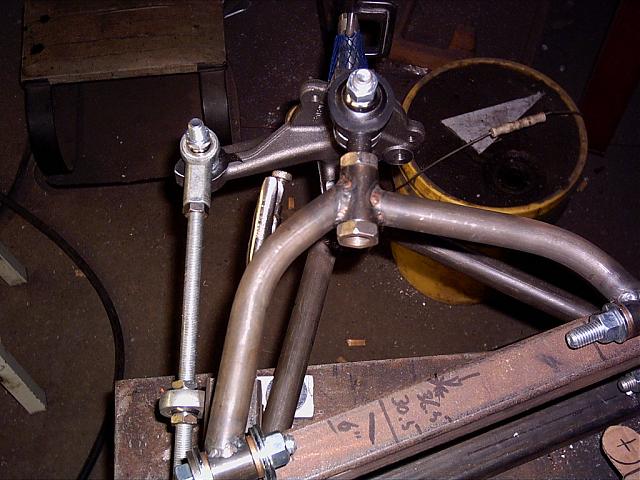

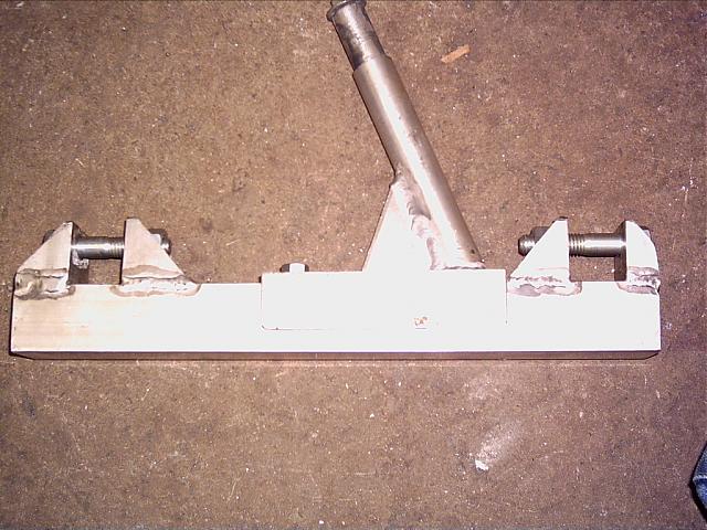

Frank:

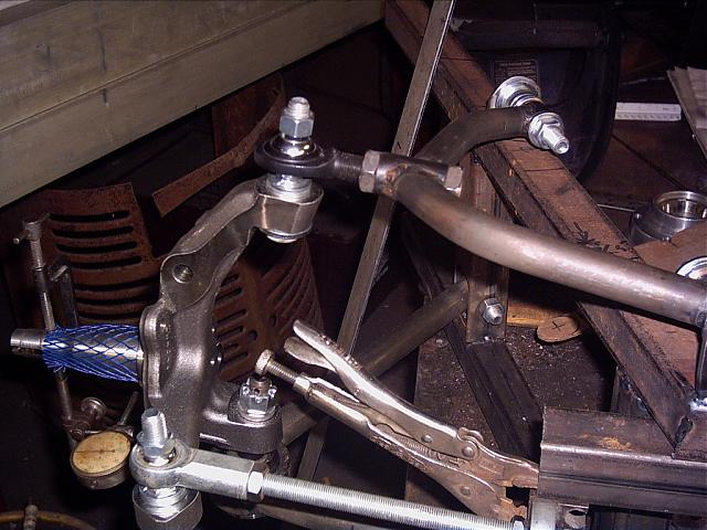

Sorry about the delay but I managed to delete all the photos I took while uploading from the camera..pot verdomme! But have them now.
What I was trying to say was to make sure that you have your fixture set so that you can repeat the arm with reasonable accuracy..locking that center sleeve for example, but also having the flexibility to move it rearward to add more built in caster as sometimes there is not sufficient travel within the mounts to accomplish this...I am posting a photo of my fixture, and it has a slider on it to accomplish this.
Also, I use a monobolt in the top of the upright...the photos I am sending show a plain bolt for now on a new chassis we are constructing, but the idea is the spherical part of the joint can be raised or lowered to change swingarm length and therefore roll center. Also using a rod end at the steer arm, which can be spaced up or down is helpful in resolving bump steer issues.
I think it is great that you are fabbing your own stuff, its much more satisfying than just buying and bolting up, and I look forward to these kinds of posts.
Keep up the good work

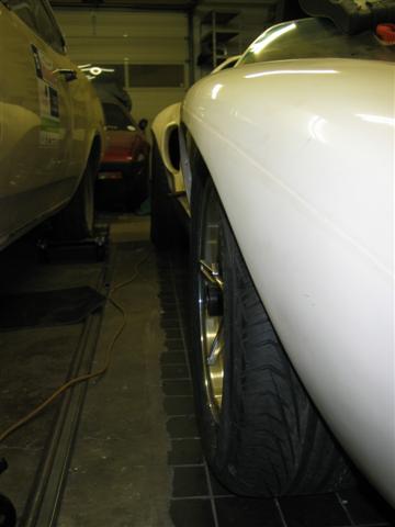

The car is standing on its own wheels again since 2 years
the front finaly all the parts fitted and test wealded
next thing is caster and then steeringarms
