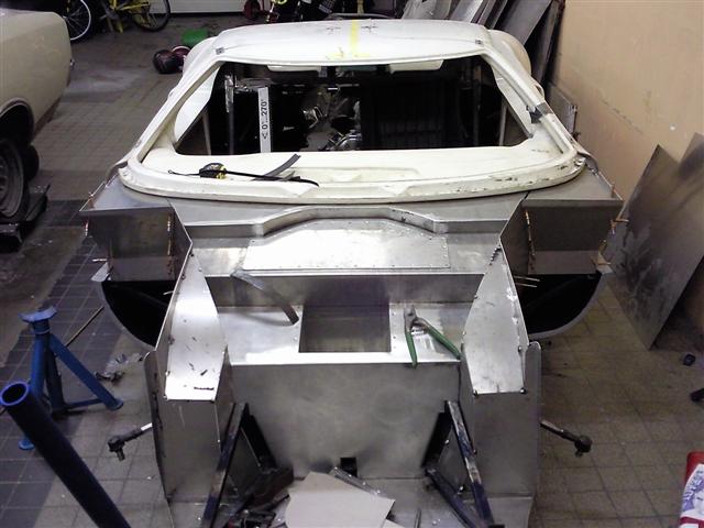

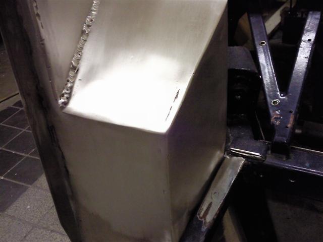

Re: Frank's KVA Build

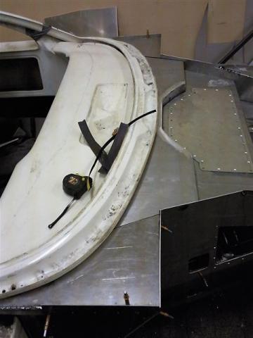

Finished the frontpaneling, still needs final attaching
started on the panneling of the doorcorners and the base for the fuelcap when i noticed after finishing the right corner that the body was'nt mounted correctly on the chassis so i decided to first putt the suspension on the front and allign the wheels correctly and then the rear wheels
If the wheels are ok then i will allign the body and fix the hingepoints again (but then on the right spot)
After that i'll remake the doorcorner

some new pics
they speak for themself

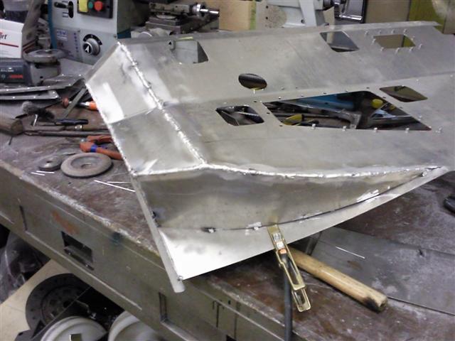

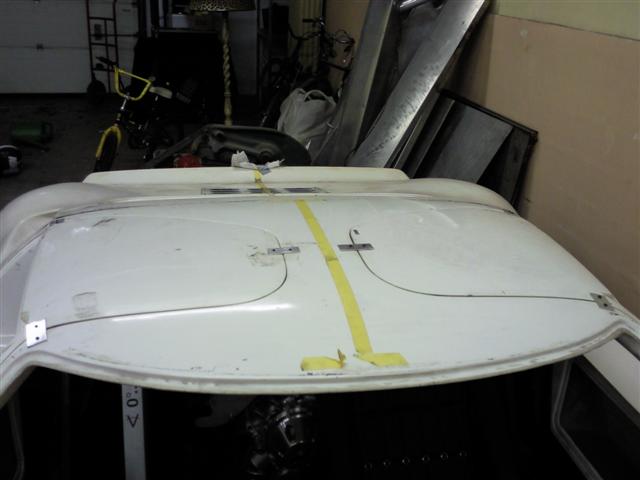

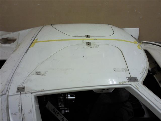

You can see what someone can do with a bit of imaginenation,cardboard,a knife,alluminium sheet ,metalcutter,metalfoulder,and Andy it's not a tig but a mig/mag welder (but I'm still looking for one)
Frank

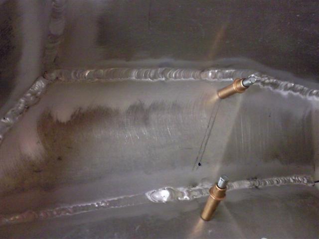

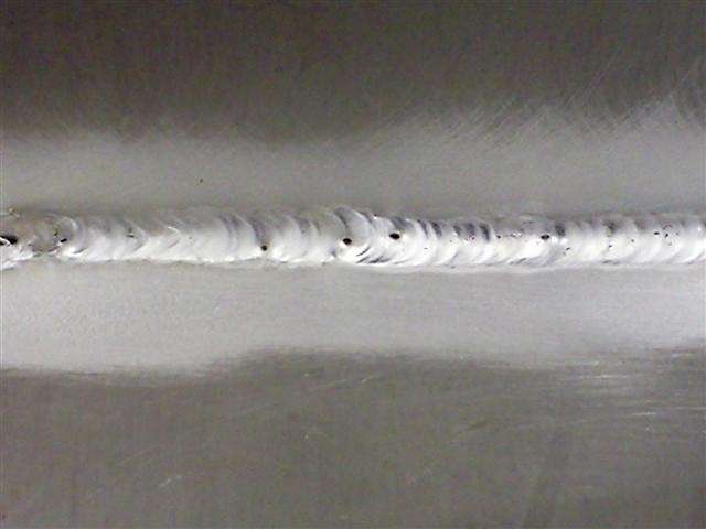

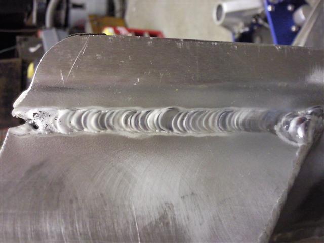

I always enjoy looking at your posts..you have done a super job of fitting and measuring your panels.
I was wondering if you are experiencing any problems feeding the alum. wire in your mig gun, and what alloy you are using. I currently only use mig on thicker sections, and depending on the finished application either 4043 or 5356 wire, maybe the specs are different in Europe.
I used to spool-gun all of the alum welds on thicker sections, but now we use a push-pull gun which eliminates all the bird nesting, and the finished product is much cleaner.

I'm just using 0.8 mm alu wire don't know the specs have to look it up at the spool (I will this week)
And yes i've got problems with the wire feed because i don't have a push pull gun, I've got a machine witch can be used with a push pull but they are asking a lot of money for the gun (750 euro) so what i did was loosening the pushwheel in the machine so it won't fold.
I attached the doors to the spider so it's easier to measure it

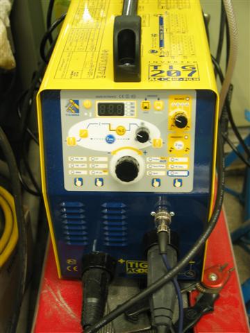

Finaly can start working on the car again.
Bought myself a present
a ac/dc tig welder so i can weld the alu proper
Eddy came over today from leiden to help me get started with the tig (picture)
and now just a lot of practising before i can weld my panneling
not so easy to learn
but with practice it is getting a bit better every time
