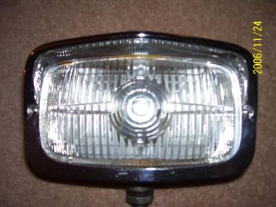

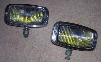

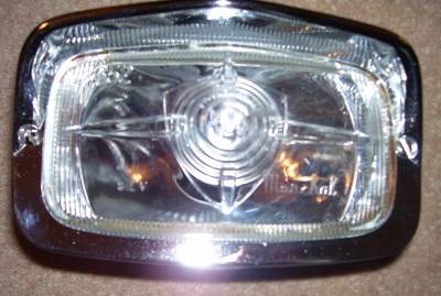

I spent ages looking for suitable lamps, the best of them I ended up with was a pair of Rectilux 650 one of each 652 and 653, I gave up on these and bought a pair of lens only 653 NOS items, a bit pricy but nice!
I have attached pics of the lamps They look fine but the NOS items are so much brighter.

Thanks Steve, they look nice - can you just use a better bulb with them?

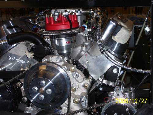

To ginger up the lights I have been checking out the aftermarket Xenon replacement bulbs that are available in the UK for both headlaps and spots. The Marchal units have a strange three pin bayonet that seems to fox the supplier, lots of time yet to find something.
The engine is in place and is very tight in every direction, the ZF mount puts the engine low and forward. Lots of clearance to the low side areas but the MSD billet distributor supplied with the Edelbrock EFI is too big to clear the engine bulkhead opening. In fact the cap could not be fitted.
After lots of contact with Edelbrock I find the diz is a special 'hall effect' unit in the MSD body, the only other compatible unit was a Mallory unit with a smaller cap but a similar height.
So drastic measures needed, I have chopped out 25mm (1"), the unit nw fits nicely under the frame and I can keep the big cap.
Before and after pic attached
This was a bit of a mind block but now I can move on to othe bits. I found a MkII oil cooler and am looking for a second 11" unit.
Has anyone details of the oil circuit that has been used; I was thinking of using a thermostatic take off plate under the filter then to the cooler which is the non coagulating type with the internal bypass normaly controled by a thermostat in the base plate/ Continental engine. Then what series or parallel? I have no base plate so I will fit the feed and return in the plate I have made, the slot in the plate is to allow feed to the bypass.

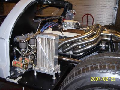

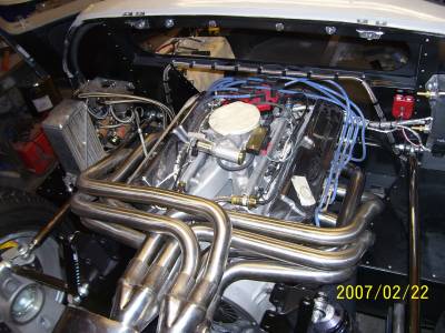

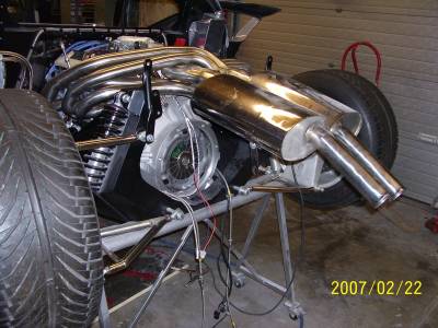

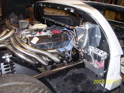

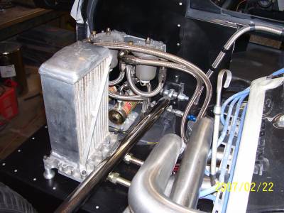

Here are a few update pictures, I have been trial fitting the exhaust and fuel system swirlpot and pipework etc. I am trying to get the location of all the pipes cables hoses in place, then take the engine out and final fix them.
Delays in finding parts for the ZF have held up the gearbox, hope to have it in place in a couple of weeks.
I am aiming for a driveable chassis then concentrate on the bodywork

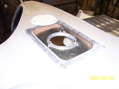

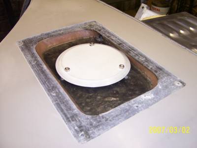

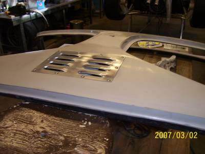

The roof vent is now in place with a labrinth seal to try to keep out the UK weather.
Steve

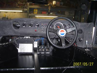

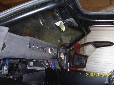

Update time, I've been spendig some time on things that seem to take ages with not much to show.
The dash is shaping up with the SW instruments, the dip switch on a prevous car was not easy to find quickly in the dark so I have made a dead pedal with a foot dipper switch.
Steve

Steve,
Is that Alcantara you've trimmed you dash with? If so, who did it. Thanks

Brett
Yes it's Alcantara. The trimmers are the MDA's regular supplier, Mark at MDA arranged to have it done for me. You need to be careful with the colour choice and err on the side of darker as the nap on the fabric shows up lighter than the sample. I am well pleased with the result.

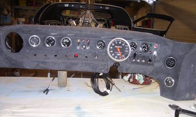

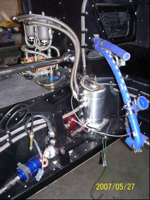

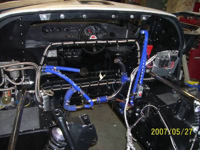

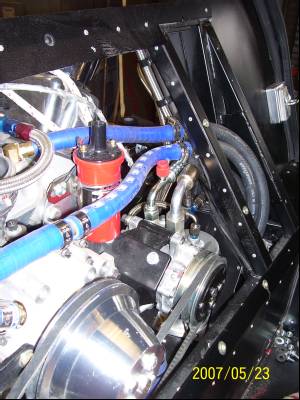

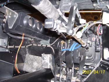

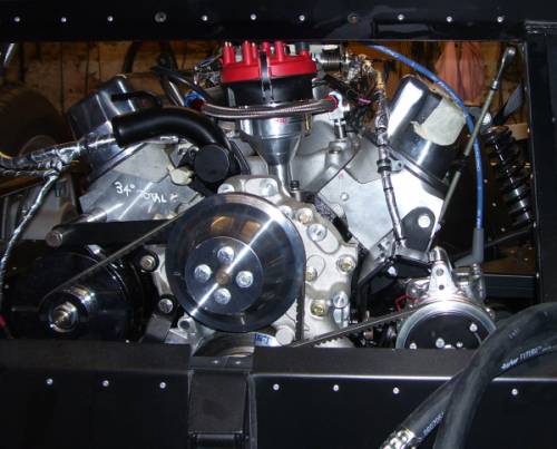

Progress is two steps forward and one back, the engine has bee in place several times to place pipe and wiring positions. There's a shot of the empty compartment reay for the engine and gearbox fit ( last time I hope).
I changed the heater pipes from the center section to pass down the LH sill, his gave a little more clearance for the crank pulley that is very low and forward as I'm using a ZF .
The dash is set out and wired, I am waiing for a chrome bezel speedo to match the SW instruments.

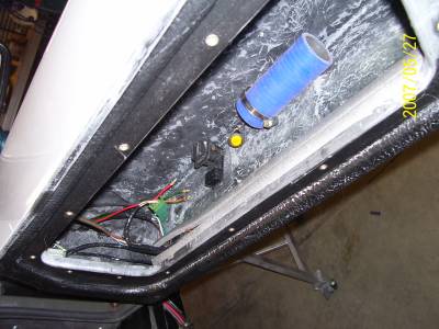

The doors have lots of wires for the electric mirrors/ heated mirror central locking and courtsey light switches etc, some closed cell pipe insulation fixed with some dabs of Sikaflex made a nice way of stoping them rattling about.
I am aiming for a driveable chassis then tackle the body
Steve

I notice your fuel filters have metal 'bowls' as opposed to the glass ones, do you have a part number and source for those??
Mine are the glass type & I'm told scrutineers are not happy with the glass bowls, it would be very convenient if they were interchangeable with the ally ones.

The metal bowl filters are the standard MDA item as supplied, I think they are listed in Demon Tweeks and others

Thanks for your words of encouragement, much appreciated.
Martin,
Having you all to see the progress so far was very reasuring, I think we all learned a bit from each other!
In particular your observation on the rad mounting was spot on and I have modified the mountings per the pictures. I had not appreciated the ali rad core was affected by stress/ vibration fatigue cracking, the rubber mounts should do the trick.
I would appreciate contact details by PM for you all as I forgot to write anything down.
Steve
Name:	Rad mount 1.jpg
ID:	20534   Click image for larger version
Name:	Rad mount 2.jpg
