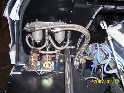

Chris
I've used the bellhousing and gearbox top as supplied by MDA to mount the engine, I have gone for a 347 Ford Racing unit as the option to build one appears to me to be confusing so many options!! Maybe later.
As it is a MKII that did not use multiple Webers I've opted to use the Edelbrock injection set up as it looks a bit like the four barrel carb but will give better management for emmissons control. I have worked out a simple fuel supply system for the feed and return to the tanks, there is a layout on the attached spreadsheet.
There is a photo of the layout that shows the rh tank return under the bulkhead window .
When I have a running chassis I wil start the bodywork, I hope it's not a mistake to build this way round, as I read that its better to fit the body when the fiberglass is still 'green' as you have.... we will see soon!

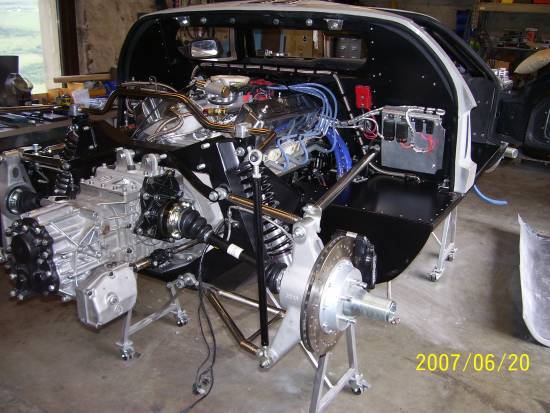

The engine and g/box are in finally and the driveshafts rollbar etc are making the back end look more business like. The gearshiff will need fine adjustment but has a nice positive feel.
The S/W fuel gauges I used need an O ohm empty and 90 ohm full sender unfortunatly the reverse of he standard sender. I have found a VDO unit that is the right way round, as soon as they are here the fuel system can be completed ..... then perhaps some real Brrumm Brrumm s

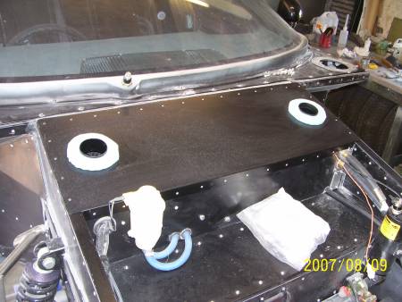

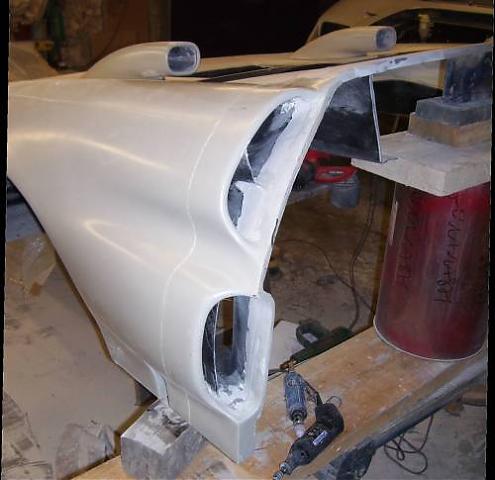

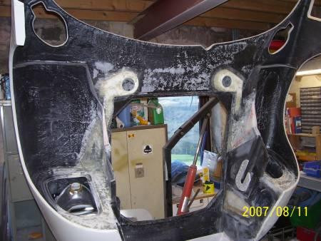

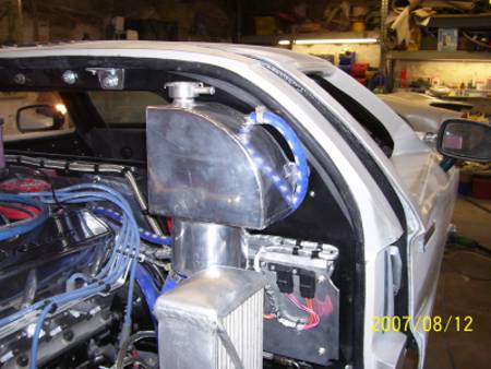

Some more progress, the header tank is now made up and fitted. The NACCA ducts have been opened up and ducting bonded in place with bulkhead intakes. Here are a few potos.

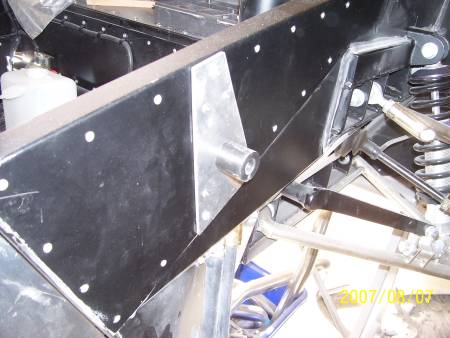

The front clip mounting is also now in place as used in the original MkII.
Steve

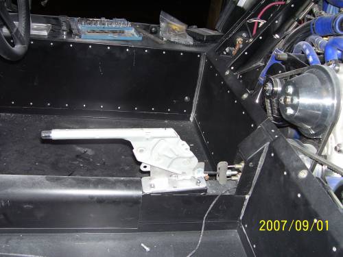

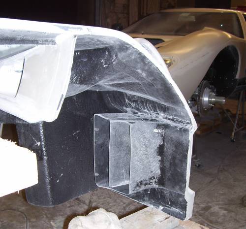

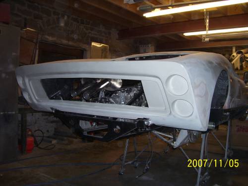

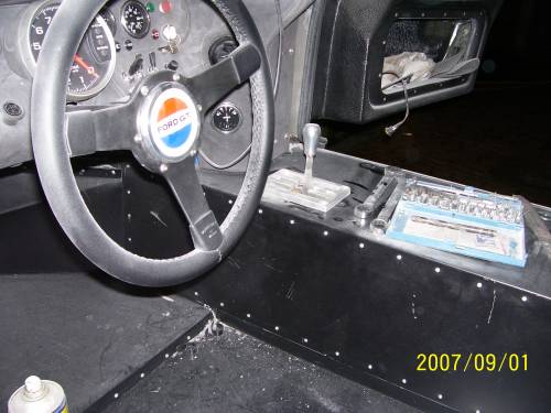

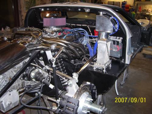

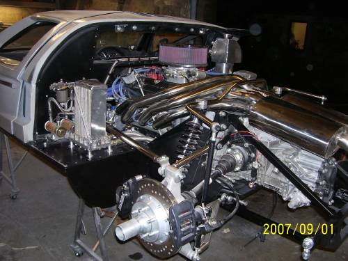

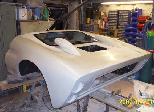

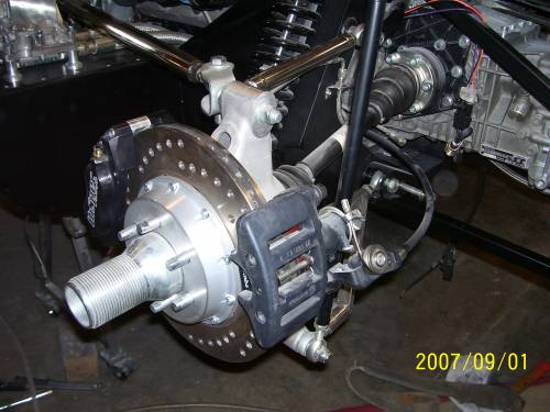

Here is a quick update.
The fuel senders are on the way with matching gauges, the S/W 'Intelesensors' senders have to be specialy made, I should have them in about a month.
John at Automotiveengineering was very helpful in sorting this out Automotive Engineering (1-800-284-3551) TOLL FREE # 800-284-3551
The handbrake calipers and cables have been fitted , nice setup with a smooth action. I have posted a few shots of the the engine compartment, gear shift gate and brakes.
I have started to tweek the rear clip to take a standard glass rear window as used on the MkI this should be better for the SVA test.
The clip now has all the air ducting vents in place, the vents need some cleaning up of the tracts to blend them into the clip openings.
The dust gets everywhere!!

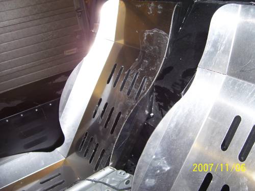

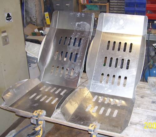

Hi,

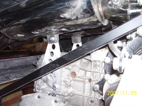

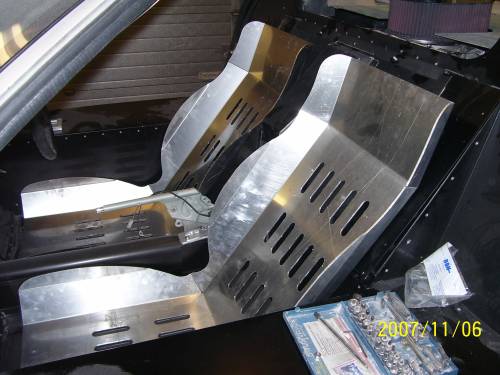

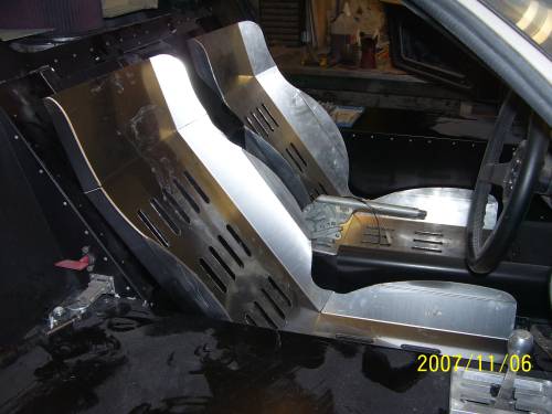

An update of recent progress has not had much to show, lots of setting panels and mechanicals making good previous trial fits. The exhausts are now in place, quite a tight fit due to the low ZF configuration, the fabricated brackets work well.
I have made up some seat frames that will fit either side of the waterpump bump and are not handed untll upholstered, just have to decide on materials and colour.
A few photos are attached
Steve

Hi Steve,
builds looking really good, a good inspiration to get on with my Torndao.
The seat frames look good, what thickness of aluminuim are you using. Do you have any drawings that you wouldn't mind passing on, as this would be then one less thing I have to design & mock-up
Thanks in advance

Steve - those seat frames look really nice, let me know what material you're going to use and some pics of the seat construction when you get to it. You must be closer to finishing your build, great job as per usual!

Chris , Andy
Thanks for your comments.
The frames are in 3mm ali.
Because my engine gearbox combination is very low and forward there is a bigger bump than normal in the engine cover, so I had to amend the standard seat frame from MDA. I took the route to make a frame that will fit left or right seat and have a beveled sides to accomodate the 'bump'.
Mark at MDA loaned me a standard frame as a guide and I made a cardboard replica with the shaped sides then folded it flat for the patern.
Colours... The dash is grey Alcantara so the door pockets will be the same, carpet set will be the same shade of grey with edge bindings in the seat colour which will be a lighter grey leather in the MDA patern.
The car will be the Shelby Guardsman blue with the white stripes, hope it will be a good combination.
Anybody know the paint code / ref for the blue and white.
My long running saga to get the S.W fuel guage senders is resolved, the senders are fitted and work correctly
