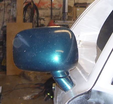

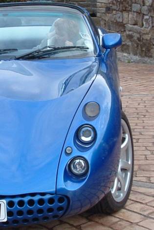

I had a MkI and the rear vision was very poor so I spent some time finding a mirror that would give a good view line as the MkII has more obstruction.
The one I have gone for is off a VW Corrado also used on the McLaren F1 and my TVR Tuscan. It is heated and electric operation. The controls are from the same car and the Canadian Corrado owners club have the wiring diagram on their website.
I have posted pix of the cars
The base of the mirror needed to be trimmed to the angle of the door profile
Hope this helps

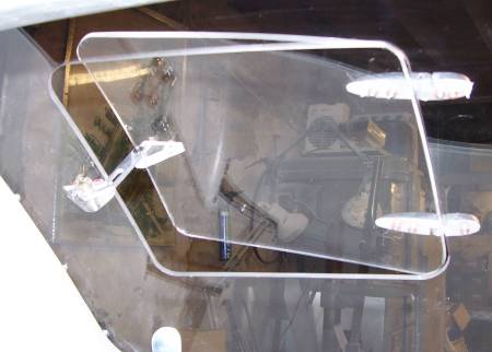

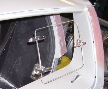

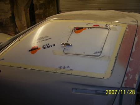

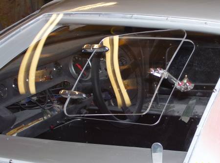

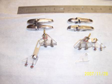

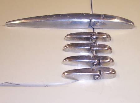

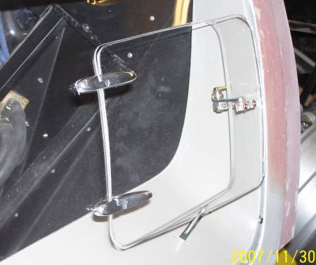

Hi, here are a few pics of the side windows I am fitting.
The rebates need to be increased in depth for the 4mm moulded side windows that MDA provide, they also provided some nice hinge hardware similar to original equipment in acrylic.
The set up was for the hinge to be on the inside however this needs a gap of 4+mm and possible beveling at the hinge edge to allow the window to open without binding on the main window edge; if the hinge is on the outside the gap conversly opens up as the window opens
The gap would let in quite a lot of Yorkshire rain in ( a very wet type), so I opted for the outside hinge.
I made some hinges to 'match' the hinges on the front vent. I have also made a clamp to lock the window open, also the heel of the mounting bracket for the stay to make it project past the edge of the window opening to act as a stop for the window when closed.
I will fit them then set aside till after SVA.
Steve

The windows need some tweeks to get the final fit to give a close fit in the opening these are the pictures.
The next jobs will be preparing for SVA . Some replacement fuel fillers suitable for the test are the first item then edges and light positions etc.
Steve

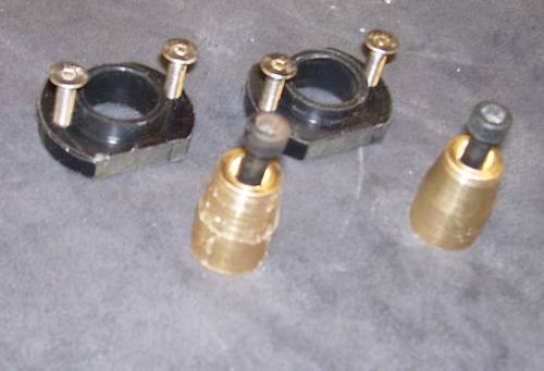

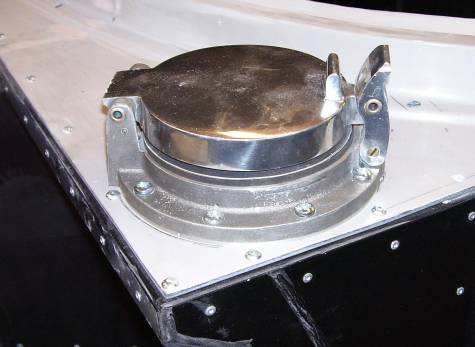

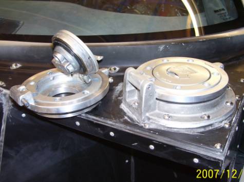

The original type fuel fillers are not suitable for SVA without covers or lots of radius work so I have made some exchange caps from a couple of motorcycle filler caps from the bike breakers. Just a little radius work and that should do it.
They just mount on the standard MDA filler base and the original caps can be just dropped back on after the test.
Before and after shots attached
Steve

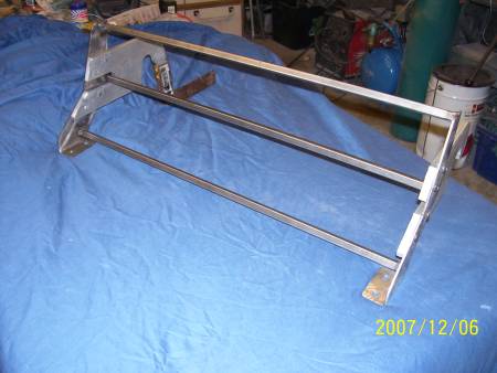

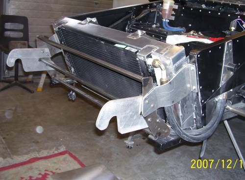

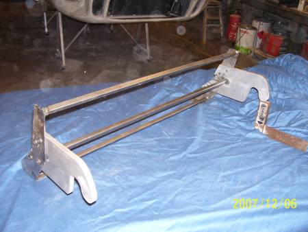

I need to have a mesh grille to protect the radiator but also for SVA to shield the interior parts. I also want the jacking / lifting brackets after SVA, so I have made a frame to carry the grille and brackets.
The frame fits on the hinge mounts for the front clip, I need to make a brace bracket to support the top back to the chassis at the side of the radiator.
I have found some stainless mesh and need to choose square or diamond effect. The bracket is off to powdercoat next before fitting the mesh.
I plan to use the same mesh for the rear of the MKII..

Old 12-11-07, 05:04 PM   #77 (permalink)
SteveBarker's Avatar
SteveBarker
Silver Supporter
Join Date: Sep 2003
Location: Yorkshire UK
GT40: MDA GT40MkII
Posts: 189
Rep Power: 6 SteveBarker is on a distinguished road
Re: SteveB MDA MKII Build Diary
The frame is now in place waiting for the s/s mesh.
Steve
