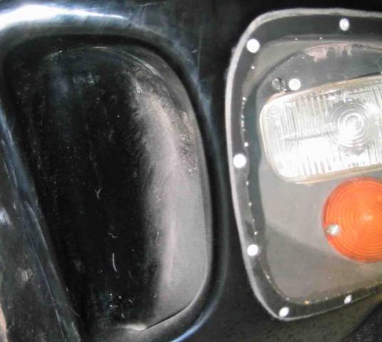

Is the Mustang light the original fitment, I've been trying to identify the light used. I want the two screw fix lens like the attached photo.
If you have the lights, what is the overall diameter?
Steve

eBay Motors: 65 66 Mustang Parking Park Light Lamp Complete Kit (item 280186431461 end time May-21-08 14:29:47 PDT)
I tried just looking for the lenses but gave up after a while and bought the whole deal.
Lights are at Nick's so will see if he can measure and let you know.
Dave

Thanks for your help on this one. I presume you will use the lens and the bulb holder base cut down to the bare size of the amber lens and abandon the chrome bits.

Exactly. The chrome trim comes off with relative ease leaving the rear bulb holder and mounting gaskets.

The MkII used a lamp that secures with two screws through the lens not the Lucas type. Space is limited the ones in the UK are too big so the Mustang item could be the one.
I have attached the only other photo of the item I have.

Yes, I see what you mean. I gave up my search and used the Lucas lights and if the lower light pod mounting face area is the same size for the MK I & II's I can safely say that what I did fit just fine and looks to me anyway, close the original cars. As you say, space is tight but the Lucas type are a 2-screw and just fit under my Marchal's.
Curious to know more of the Mustang type if you get more info-

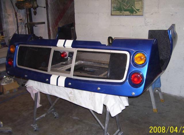

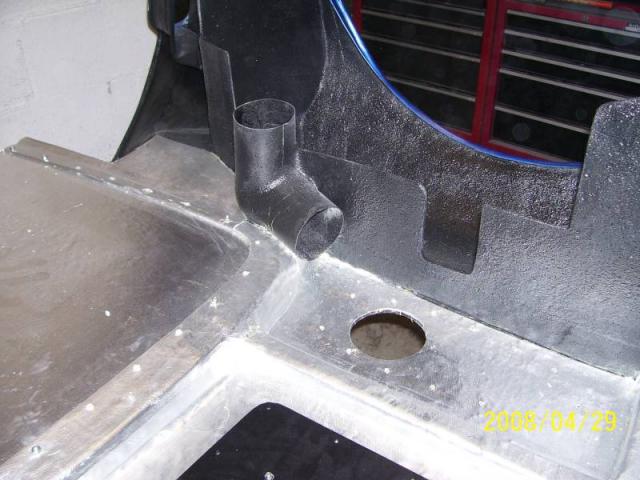

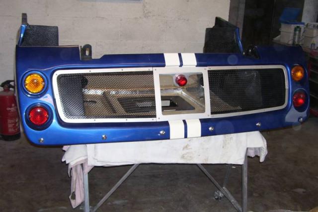

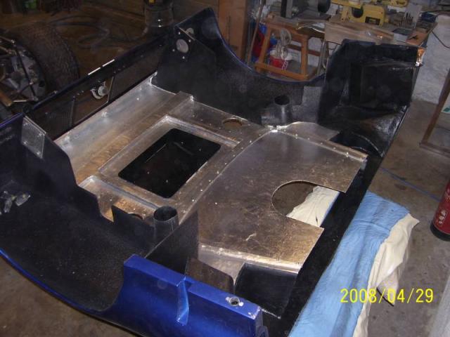

There has been progress on fitting out the rear clip with the temporary SVA rear lights, the heat protection for the underside and the final position for the snorkel ducting that will be linked with flex duct.
Here are a few shots. Wire them up next

That is looking REALLY good!! I love the MkII rear lights and grilles.
What thermal protection are you using on the inside of the rear clip? And what adhesive are you using to install it?
Thanks, and keep the pics coming.

The stuff I used under the clip is a glassfibre woven fabric with a bonded aluminised facing. It is supplied by an industrial consumables supplier, the catalogue page is attached. It is available in two weights. I thought it was inexpensive compared to motorsport branded offers
The glue is a 3M product 'Scotch-grip' 1300L, I've used it before on a TVR Griffith that had an insulation panel that detached when things got hot. It stayed in place afer using this stuff . Like most 3M it is expensive but it works!
If you would like an off-cut sample email me your address

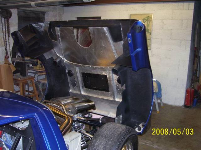

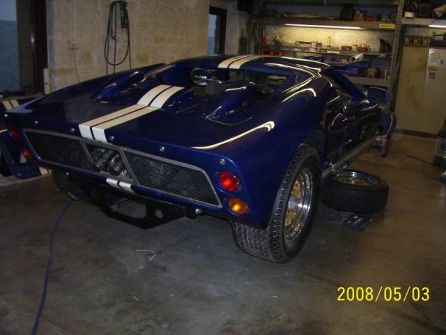

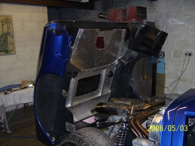

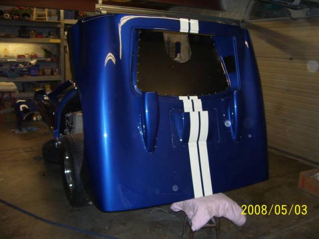

The rear clip gets heavier as it is built up, and now its painted I can't single handed lift it into place.
Fortunately I had a little help from friends. Martin Mike and Alan came over from Lancashire for a visit, they assisted, thanks guys!
Here are a few shots of it in place

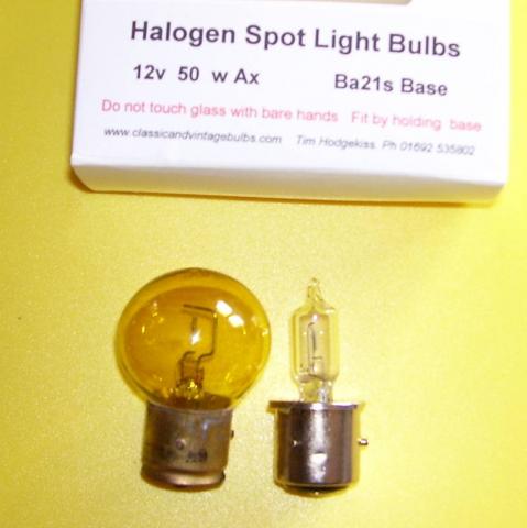

I have been looking for an upgrade in the performance of the Marchal driving lamps. I had yellow bulbs, clear would be better. however I have found some 50w Halogen bulbs with the three pin base suitable for these lamps.
They are available from Page Title UK phone 01692 535802.
