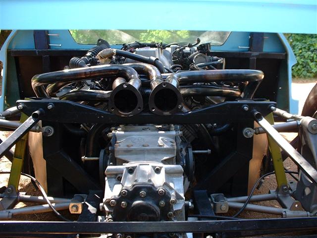

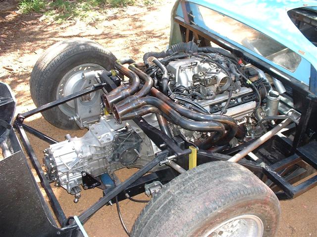

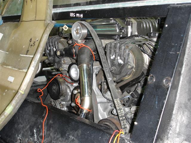

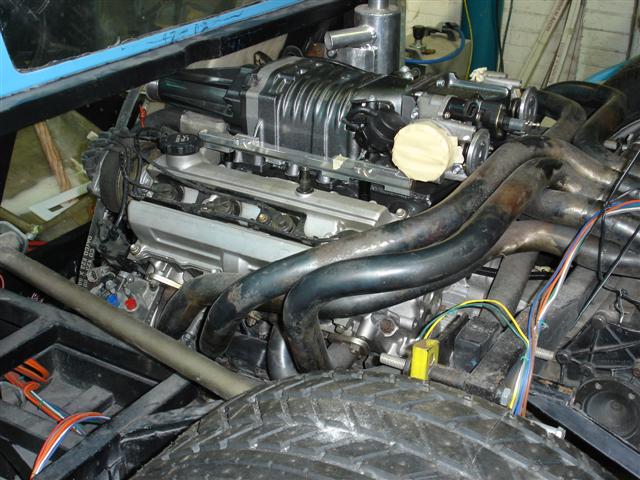

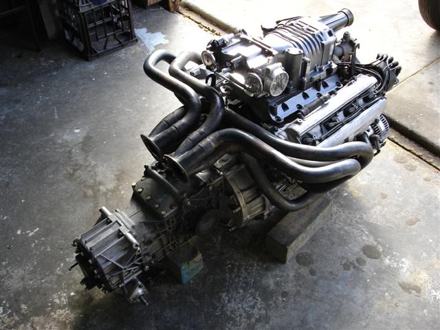

  • When I noted that GT103 had the Indy motor in it, I decided to go quad cam as well. I looked at a few motors (Ford modular (too big and expensive), Porsche (too expensive), I was even offered a Ferrari V8! (now that would have been sacrilege)), but the 1UZ-FE Toyota V8 kept coming out on top in most comparisons. Compact size, low weight, modern technology, alloy, quad cam, quad valve, 6 bolt mains, cheap and easy to purchase, good references.
  • The Bullet supercar people then came out with their supercharged 1UZ-FE powered sportscar and it seemed only reasonable to go that way. One of the guys working on my car had connections with the company and they very nicely helped us with information on my installation. For anyone that is thinking of going the same way, make sure you get the low fabricated manifold, otherwise it won’t fit. This was before the new GT came out with blown quad cam power. How did they find out what I was up to?
  • The engine has been mounted low enough in the chassis so that the blower drive clears the cross brace at the bulkhead which in turn means the sump is a bit too low for peace of mind. Rather than modify the wet sump, we decided to convert it to a dry sump motor. We’re using a BDG pump for the scavenge circuit and the standard pump for the supply. The only mods are to the sump pan so that, if I ‘lose’ a motor, the bits can be swapped on to another block with no mods. We’ve pressed up a windage tray with louvres and gutted the standard power steering pump to convert it into a layshaft to drive the scavenge pump. Locating the pump was the hardest part of the exercise. There’s just not much room to spare. The usual locations didn’t work.

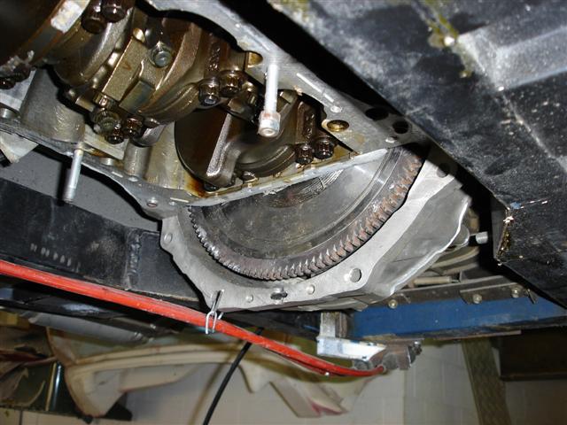

  • The standard Soarer bellhousing was cut and a flange to suit the ZF gearbox welded on. Twin plate GT Falcon clutch inside. Central gear stick with a Lotus Esprit cable gearshift used. I believe GTD based theirs on this design. It’s quite a clever example of Chapman’s engineering in lightness.
  • The catalysts will be modified and built into the fabricated mufflers. Each muffler will be D-shaped in cross section and bolted together to form an oval, then wrapped in heat insulation. The exhausts dump through 2 ½" pipes at the rear.

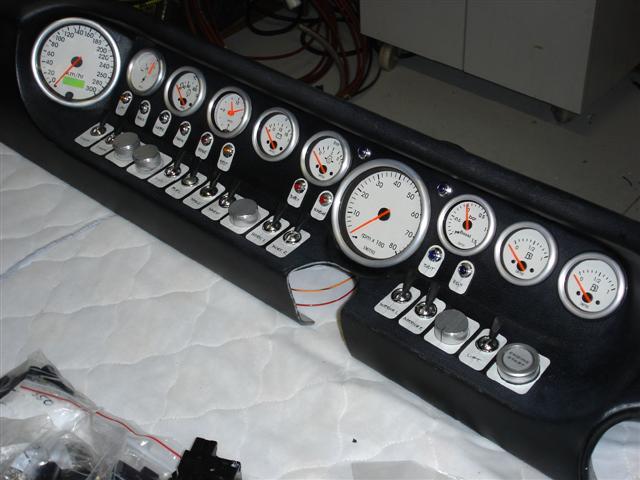

  • As I’ve mentioned elsewhere on this forum, my view is that the biggest failing of any kit car is the dash. The car looks great, until you look at the dash, and it looks half built. I feel they should look ‘busy’. When it came time to do mine I went for plenty of instruments and switches in order to get an aircraft cockpit quality about it. I’m using Smiths Telemetrix instruments, Rover toggles with MkII Jaguar blades, engine start button from Demon Tweeks with audio control knobs to match for AC control, hazard and Bluetooth phone connection. I’m using engraved plastic labels for the switches. They’ll be silver to match the instrument bezels with the engraved names showing in black. Everyone that’s seen it likes it.
  • I’m using an AP500 cruise control by Command, Paralyser 785 alarm by Dynamco complete with door remotes, battery kill switch mounted in a glove compartment between the seats.

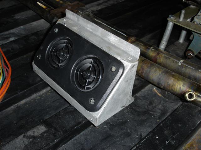

  • I’m installing a reasonable sound system. The head unit is inside the passenger door controlled by a remote control with an infra red repeater on the dashboard. Amp behind driver’s seat and 6 speakers. Subs in the doors (only place with enough volume), tweeters and woofers in the footwell side trim panels. I’ll be interested to see if I can hear it over the ‘music’ coming from behind the bulkhead.

  • As the fuel tank pick up points are so close to the engine in a GT40 (unlike most cars), we’re proposing to use dual submersible high pressure pumps and circuits with no low pressure pumps. The pumps will each be in a surge pot / sump which the return circuits will dump into. This simplifies the fuel system, but retains full redundancy.
  • Fuel level sensors are by Turotest and will also live in surge pots for damping. They will probably be electronically damped as well.

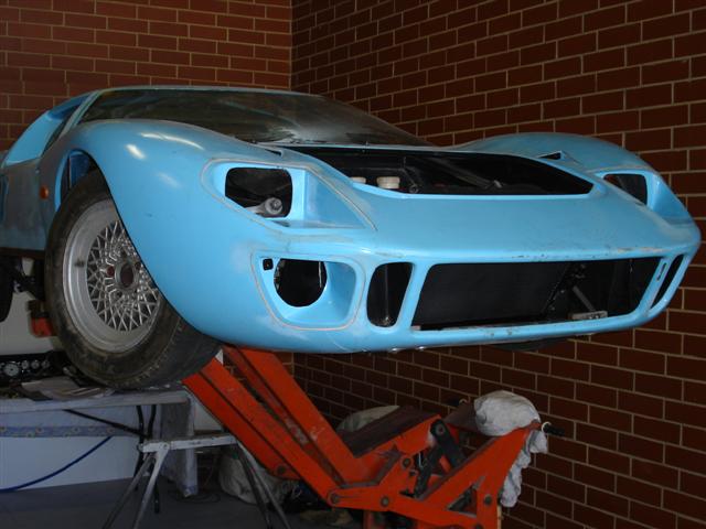

  • I’ve always liked the look of the wide rear body, but this wasn’t an option when I purchased my car. I’m widening the body to suit the 335 Pirellis and black Simmons FZ17 wheels and it looks great. The photos don’t do the wheels justice. The most common word used is: "Stunning".
  • The front clip vents will all be used. The wing vents feed fresh air into an under dash plenum which supplies the cockpit and AC / heater system. The central vent will feed cool air into the area under the front clip to stop heat build up.
  • I’m going with a single nostril front vent. It will incorporate a shroud to seal behind the radiator and fans.
  • I like the look of the cars with the full size round driving lights. The biggest I could fit into mine were 135mm diameter. I note that other cars have used 150mm diameter driving lights. In true GT40 fashion, they must all have different sized nacelles, because this size wouldn’t come close in mine.
  • I’ve used side indicator repeaters for front indicators and have replaced the globe holders with 21W types. It’s amazing how nice they look in your hand and how small they look on the car. I don’t know if I’ll get them passed, but nothing bigger (that was the right shape), would fit so I’ll see how I go.
  • The supercharger front pulley sits between your shoulders. I’m installing a Perspex window in the alloy bulkhead so that it can be seen from inside the cabin, noise permitting. Seeing the engine spin up so close to their shoulder should stir up the passengers .

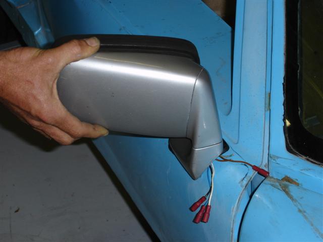

  • I wanted a particular look for the wing mirrors. They had to be door mounted and with good vision past the wide rear guards. I also wanted them to be rectangular with rounded corners. After much research I am using the mirrors from a Porsche 911SC of around 1980 vintage. They are visually a bit chunkier than I had in mind due to the rubber surrounds, but this won’t ‘read’ with the burgundy body colour I’m using. They’re alloy, designed for high speeds, electric and heated for those of you from cold climes. Note that they come in right and left hand drive versions.

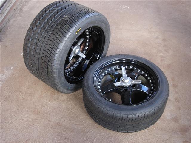

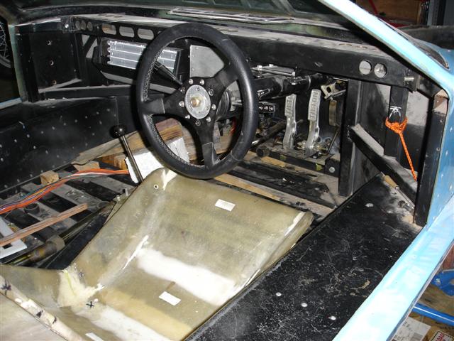

  • As I’m 1.9m tall, but didn’t want a Gurney bubble, I had an extended footwell built into the chassis. This also allows adjustment access to the pedals from under the front clip. I’ve gone with Tilton floor mounted pedals in a custom pedal box. I was going to use an aluminium cover plate but, as the pedals look so nice, I thought to go with a Perspex cover, so they’re on display.

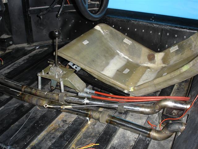

  • The steering column has been raised as far as possible, in order to get over my feet. This was achieved, although it then clashed with the wiper motor, which had to be moved around and a new bracket made.
  • I’m dropping the driver’s seat as far as possible, while still keeping the underside flush. The seat is raised at the front for thigh support and the angle means that the seat can be lowered by removing one rib and chamfering the top off the next one. The seat rails will stiffen up the structure.
  • The seat has been lengthened and modified to suit my body. I’m a wide body model, so the driver’s seat has been installed about 50mm to the left. This helps reduce the pedal offsets and gives better room for the handbrake on the right hand side of the seat. The passengers’ room is restricted a bit, but I take the view that they’re lucky to be there and must put up with what’s left! We’ve taken an effort to make sure the seat back is parallel to, and hard up against the bulkhead to maximise the room inside and for entry.
  • I’m installing a removable steering wheel to make it easier to get in and out of, therefore, I didn’t want a horn button. I’m using an XD Falcon upper steering column which fits on to the Toyota lower steering column. All the controls (Ford Escort) are stalk mounted.

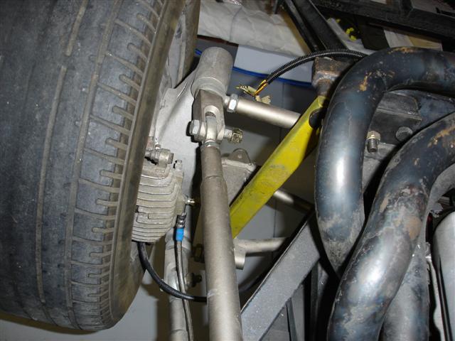

  • Simmons FZ17 rims are used, all in black with alloy spinners. I looked at a pin drive conversion, but just couldn’t justify the cost.

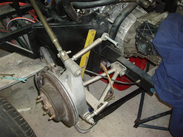

  • The standard Corvette front brakes have been replaced with larger rotors and twin piston calipers. The old front calipers have now been installed on the rear as calcs showed this was best for the weight distribution, etc. Not too many people would even pick it.
  • Porsche CV joints are to be used to mate the commodore axles to the ZF gearbox.
  • I work in the offshore oil industry and checked with the materials guys for advice on suspension coatings. Based on their advice I had the suspension trailing arms and other components electroless nickel plated. It’s a durable coating for the use and the frosted look gives it an alloy appearance.

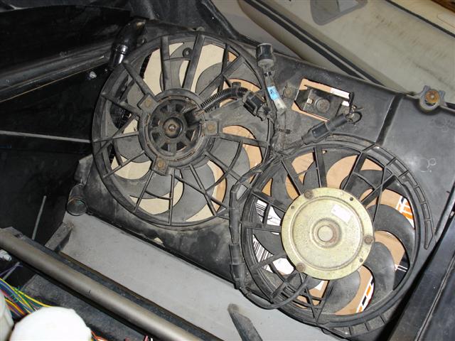

  • The standard Holden Commodore radiator has been converted to dual pass to put both connections on one side to help clear the shroud. A bleed point has been installed at the closed off connection, which is the high point for the radiator. I’ll see how it goes and may go for an aluminium radiator next time round. ,The fans and shroud are from a Ford Mondeo (I think), but the late model Falcon twin fan unit will also fit.

Lance,I like the layout of the cooling pipes. A little different. Does that arrangement measure out to be the same width as the original tunnel. Hope so, cause that may limit you on seat selection.

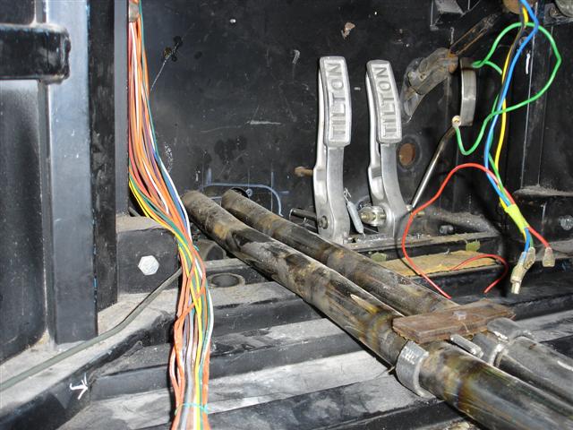

I notice you went with the Tilton double pedal setup. What did you use for the accelerator pedal?

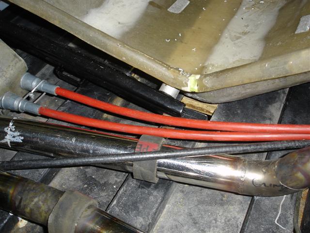

The water pipes are wider than the tunnel, but this is acceptable because they can now fit under the raised edges of the passenger seat. I’m using the fibreglass seats that came with the kit. It all fits OK, even with the seats, etc all being mounted to the left in the cockpit.

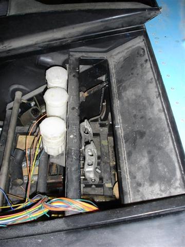

I purchased the Tilton pedals only and we fabricated the pedal box and accelerator pedal.
WES
We didn’t have any problems with the engine. The engine was mounted as low as practical in the chassis, in order to keep the CoG low and we worked to a dimension required to clear the blower snout under the chassis cross member up front. The sump stuck down too far, which is why the engine has been converted to dry sump, and the bellhousing protrudes about 12mm below the chassis. Although it’s between the wheels, it will be covered with a bash plate, for a bit of extra protection. I’ve seen them mounted higher than mine.
Chassis differences may be an issue. These photos were taken when I had the stock engine sitting in the chassis. The engine mounts even lined up. We just shortened them to suit.
I’m not sure if that helps at all, but if you’d like any particular information, I’d be pleased to help out. Just let me know.

Re: Lance's Build Part 5
Lance,
I noticed that your pipes are welded at the collectors, how hard are they to put on or take off.
Peter
Roaring Forties #80
306CUI, SBF,8 Stack Injection
Motec M800 ECU
Audi 5N with 3.22 Ring and pinion
17 inch Vintage Wheels
Florida Plate # GT40 MK1
porsche93 is offline
Old 11-09-06, 08:09 AM   #16 (permalink)
Lumpy's Avatar
Lumpy
Join Date: Jul 2006
Location: Perth, Australia
GT40: DRB
Posts: 48
Rep Power: 2 Lumpy is on a distinguished road
Peter,
The photo is deceptive. The collectors are actually slip ons, not welded. The pipes also have individual flanges at the other ends in order to allow fitting.
Lance
