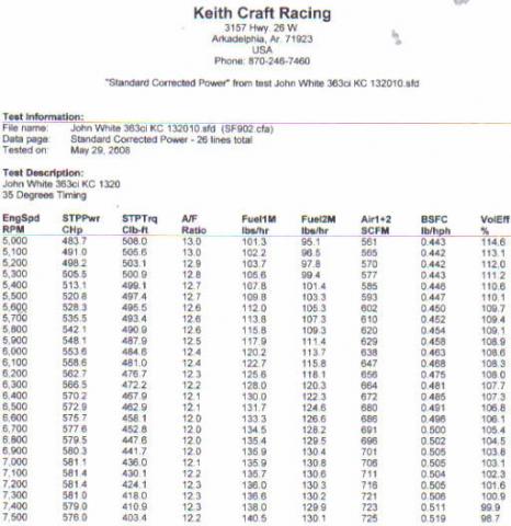

Race Engine: Keith Craft 302w stroked to 363.5, dart 4 bolt block, solid roller cam, AFR 205(ported) heads, zero balanced. Engine has been test dyno'd with 581.4HP@7100rpm, 508 lb/ft. Will be fitted with TWM Throttle Bodies & Autronic SM4 ecu and will be producing over 600HP after tuning.

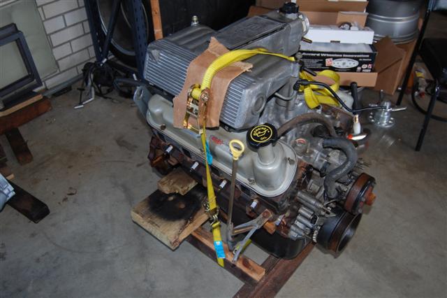

1st photo: Engine after it was stripped accessories, loom etc. The block and heads were never painted by the factory.

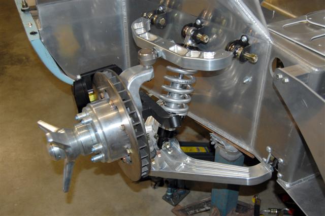

2nd photo: Some of the RCR bling. CNC billet arms, uprights, QA1 Springs & Double Adjustable Shocks, brakes. Check out the welds on the chassis, beautiful stuff.

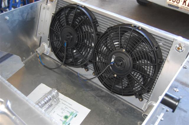

3rd photo: RCR supplied alloy Radiator & Thermo fans mounted and installed. Used rubber washers to insulate from chassis. Very quick & easy to install.

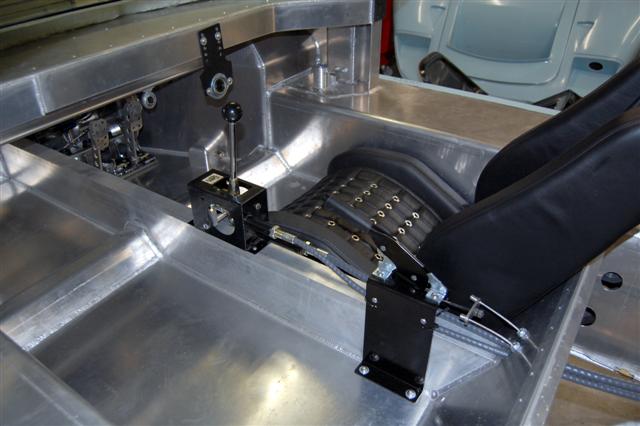

4th photo: RCR supplied shift and hand brake assembly installed. Gone with centre shift. Just installed the cockpit stuff and threaded cables through chassis etc. Again very quick & easy.

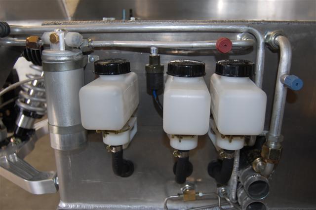

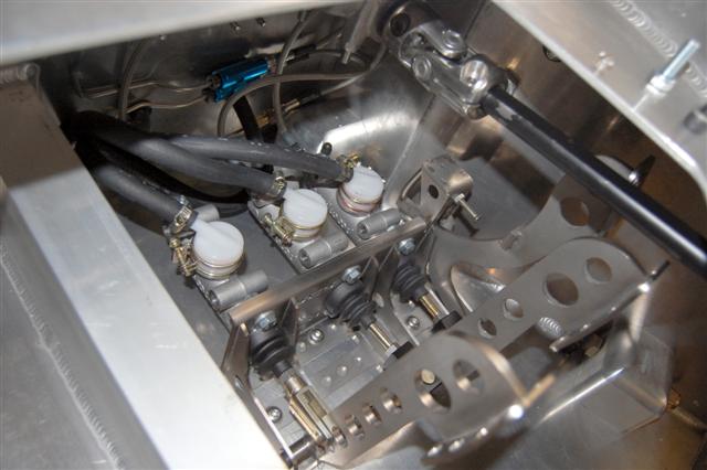

5th/6th photos: RCR supplied brake assembly installed - pedal box, remote reservoirs, mounted brakes lines(not much to do there).

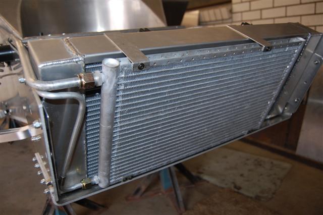

7th photo: Started installing RCR air con - condenser, hard lines, soft lines, air dryer/receiver etc. Also photo 6.

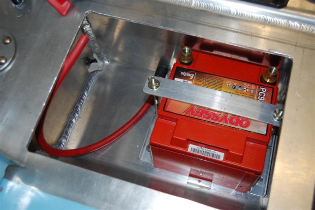

8th photo: Battery installed in the left-hand side of the chassis. Also ran the battery cable through the chassis to the rear.

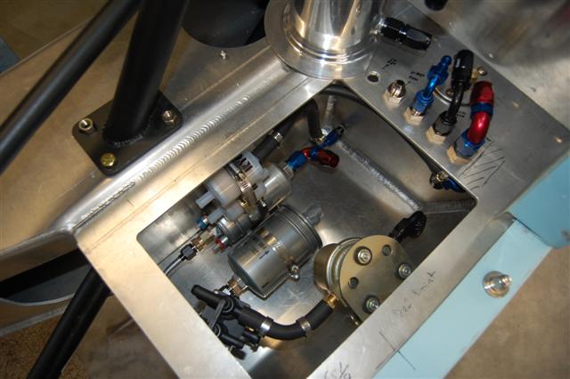

9th/10th photo: Fuel system install. Not finished yet as this is a major project. Installed in the chassis on the right-hand side. Low pressure filters, lift pump, high pressure filter, efi pump, fuel changeover switch. Also ran hard line from the opposite fuel tank for feed & return line.

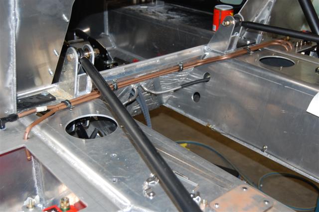

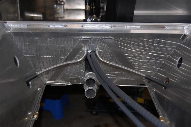

11th photo: Insulation. 1" aluminiumised foam for lower bulk head. Aluminiumised cloth for bulk head inspection cover. Also covered the coolant tubes in aluminised cloth to stop them conducting heat into chassis, should stop a few rattles as well. They are now a snug fit.

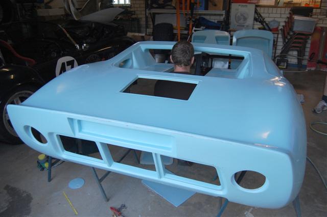

12th photo: Cut holes in rear clip for tail lights, engine vent cover & engine intake.

John's engine dyno figures from Keith Craft.

I'm pleased with how the engine has come up. Its torque curve seems pretty broad. The dyno results were with 750 carb and victor intake, so with the multi-throttle body injection, it should go a bit harder.
