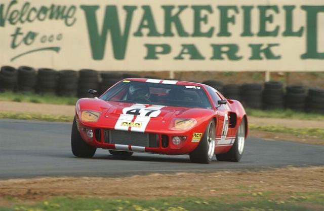

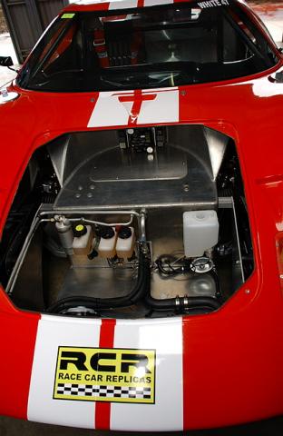

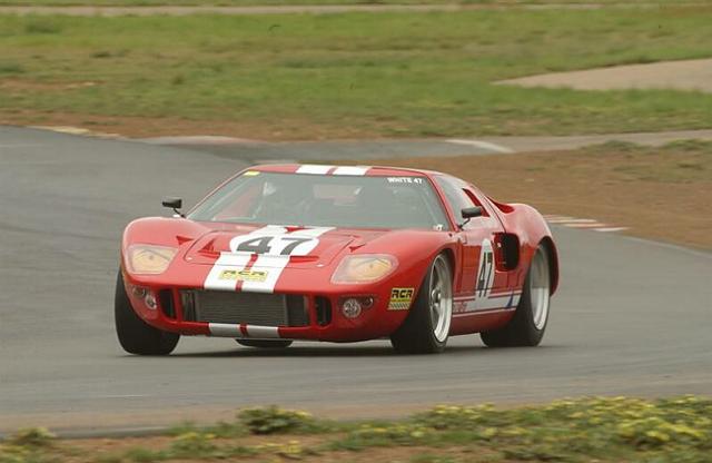

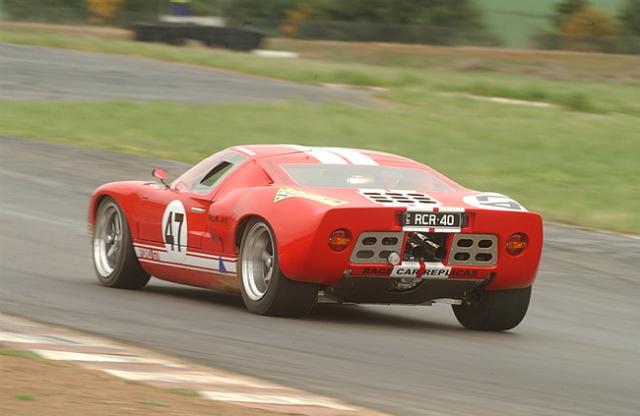

I thought I better post an update to the build site. I haven't been very good at keeping it uptodate. Quite a bit has happened over the last few months and we did manage to get the car finished enough to race at the Aussie Cobra Nationals. Its really not very finished (no headlights yet), but did go on the track much better than expected, even with some considerable engine troubles that left the car with very little hp.
Currently running the stock engine, but its down on hp which was tracked down to a faulty fuel regulator, which was replaced. After changing it I had to completely remap the ECU (Autronic), which we did on the track with each session that I went out. Still didn't get it going that well, needs some dyno time to sort out the map completely.
But the handling was really good, for a new car, first outing on the track. With the engine issues, I didn't get much of a chance to adjust shock settings yet.
I'll try to fill in some of the middle parts of the build in the next few weeks. But for now I'll just put some of the latest photos in this post.
