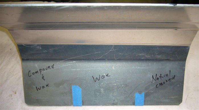

Hey guys....Time for an update from my 07-26-06 posting earlier in this string. Well... much to my wife's pleasure I have removed the aluminum test panel from our back deck. It has been sitting there now since April. Bottom line: There is no visible difference between the three sections of the panel.
Once again, details: I took a sample panel divided into three equal sizes and treated one with brake clean only, another brake clean and rubbing compound and a third brake clean rubbing compound and a good coat of wax. I set the panel on my back deck on April 15th.
I am sold......do nothing and enjoy that sexy aloooominium!!!

Here's what an aircraft mechanic (A&P / IA), would do......
1. Decide what weather and what elements the car will be subject to.
2. Find out exactly what aluminum alloy and heat treat the tub is fabricated from, and if its been stress relieved after fabrication, as this info. will help determine what parts of the chassis need the most attention.
3. If you constantly operate the car within 0-15 mile distance from salt water, i.e. the left or right coast, at a minimum wash the car with fresh water frequently to get the salt residue off the bare aluminum. Especially in hot and humid climates.
4. Don't install a liquid cell lead acid battery, unless its in its own sealed and vented box, use a sealed gell cell. If you must use a lead acid, coat the batt box with "PAR-AL-KETONE" or similar corrosion protection.
5. Disconnect the batt. after each use, so all the chassis parts are the same electrical potential.
6. If not done from the mfg. shot peen suspension pickup points and prime with zinc chromate then topcoat with 2 part epoxy paint (Alumigrip,Jet Glow, Imron)
7. Coat all dissimilar metal contact points, where steel and aluminum are in contact with each other.
8. Fill a tumbler 1/2 full with "Knob Creek", sit back and enjoy Fran's masterpiece.
