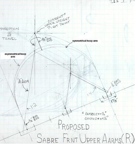

Going by the pic you provided with the -8 7/8"- measurement & the pic from John Ross there appears to be enough of the threaded bush outboard of the weld area to allow you to simply remove enough material to accomodate the locknut. That should allow peace of mind in regard to the 'loose' thread while you investigate the actual settings and means of obtaining them.

Thanks for the input! Russ, your explanation really helped clear the cobwebs for me. My understanding of KPI was exactly as you have describe it: something that I couldn't alter; short of shimming the bearing mounts which I wouldn't even consider doing. But with all of the talk about KPI, I thought that there was some arcane aspect of suspension theory/tuning that had completely escaped me. (Not an uncommon viewpoint, methinks.)
Scott, I can see the value of the eccentrically bored bushes as well! The more I look at the A arms, the more I fear that there is no way to get enough negative camber by moving the mounts foreward to avoid taking the camber positive by the time caster is set using the rod end. So, to use the existing arms while determining the proper geometry for new ones, either machining the far end as Jac Mac says or using eccentric bushes would seem to be the two workable alternatives. The trick to using the bushes would be keeping the eccentrics in phase to avoid binding the hinge action of the A arm.

I agree with Randy. You must have a jam nut on the rod end. Modify the UCAs as he suggested and you will eliminate the noise and get some piece of mind. With the extra thread and jam nut you can achieve the same alignment you have today with a much more stable rod end.

Jac Mac,
I think you are spot on and this forms the basis for what I am going to choose to believe happened with the design and production of at least some of the Sabre upper A arms. I made some measurements and did some scale sketches of what some different designed A arms would look like. (See sketch below.) They all have ½" rod ends at the chassis pickup points. Two of the arms (A frame arm and asymmetrical hoop arm) set the 3/4" rod end that attaches to the upright in line with the camber adjustment (perpendicular to the direction of travel.) In the A frame version, you can see that the leading leg is very close to perpendicular to the line of travel and it would be even closer when a bush is used as in the Sabre design. Indeed in the Sabre design, the length of DOM tubing is just right: with the design one would have been able to get there (proper alignment settings with lock nut) if the bung had been flush with the end of the DOM tubing as you recognized. I am guessing that the shoulder width of the weld in bung was overlooked until some number of arms had been fabricated such that the cost correcting or recreating the arms was more than Donnelley could bear. (He was already having severe cash flow issues by this time as it turns out.) This is not much of a stretch when one considers that even chasing the threads in the bungs after welding was overlooked also indicating that quality control was not a huge priority at the time.

Lynn
Could you turn your A arms over?
At present your end rod end looks to go rearwards
If you turn it through 180 degrees (the top of the arm becomes the bottom) does that put the wheel in the correct location? It could then be that you can get the nut on without new arms being made (May need to him the unit bacl or forwards to get correct point.
That said I do not know if that would put excess stresses on the units
DAX GT40. Rover 3.9 EFi, Worked by John Eales.
Renault Box, Always makes me smile!
IanAnderson is offline
Old 06-10-07, 01:43 PM   #60 (permalink)
Scott Calabro's Avatar
Scott Calabro
Join Date: Oct 2006
Location: MA. USA
GT40: TS40 # 875
Posts: 1,186
Re: What would you do?
Ian that's a good idea !
Although its hard for me to visualize from the pictures if it would give Lynn the room, he doesn't need much for the jam nut. It looks like it might also give him increased positive caster. If it does work, he would kill two birds with one stone.
Any strength issues could be easily solved with a simple gusset.
Its certainly worth a try.
