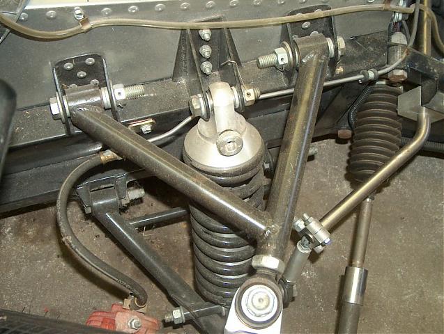

Lynn, i get the same length as you. maybe I will have the same problem when I try to align.

Going by the pic you provided with the -8 7/8"- measurement & the pic from John Ross there appears to be enough of the threaded bush outboard of the weld area to allow you to simply remove enough material to accomodate the locknut. That should allow peace of mind in regard to the 'loose' thread while you investigate the actual settings and means of obtaining them.

While it turns out that the "stock" alignment settings for the DRB are very similar to those recommended for the Sabre, it doesn't appear that I can leverage any experience that DRB owners may have developed with their use of 'Vette uprights. See this thread: Lynn's post in the GT40 Australia Owner's Forum
Lynn
