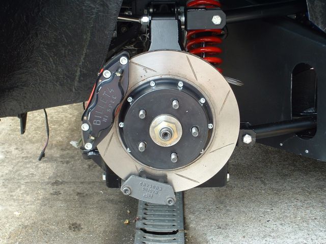

Spoke to SVA in Kent this pm . The calliper must be mechanical only therefore the monster 4 is out (I think they had been getting through but an SVA guy spotted that they were not strictly mechanical only and SVA engineers in the UK have been told to fail them).
However HiSpec have just launched a mechanical spot calliper which will meets the regs. They are emailing details this afternoon and I will post them to the site.

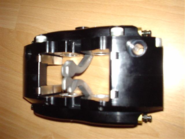

I am going to try the Wilwood Handbrake caliper. Ofcourse it isn't roven on a 40 yet, but it is only mechanical.
Brett

This is them attached to the hubs running a standard Granada Cosworth 278mm vented disc (pic taken when I was having Mick's rear end put on last week)

Originally Posted by brettmcc View Post
John,
Brett
brett, ad wilwood they told me that the calipers mechanical handbrake is up to +/_ 800kg cars.............. so unless you are making a 2/3rd model don't park on top a hill
lotus-62 is offline
Interesting, would like to see how they measure their figures to say it is only good for 800Kg. Not that I can rubbish the data, I just would like to understand how they get there.
Anyway, if I can get it to holdfor SVA I won't worry. If I have to park on a hill, I'll just use it and 1st gear
Brett
Rick,
Which model where they talking about when you asked. I know the US site, don't show the Powerlite version that I have, as it is soley licenced through Rally Design. Was it this one: Wilwood Engineering - GM*Metric Caliper ?
Brett

This caliper is "hydra/mechanical". Not sure if SVA would pass it (the HiSpec monster 4 seems to use the same technology) Of course they may not notice as the HiSpec has only recently gone onto a "verboten" list having been passed on earlier occasions.
John

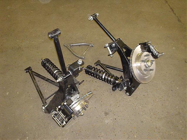

John, another picture option, Frank
