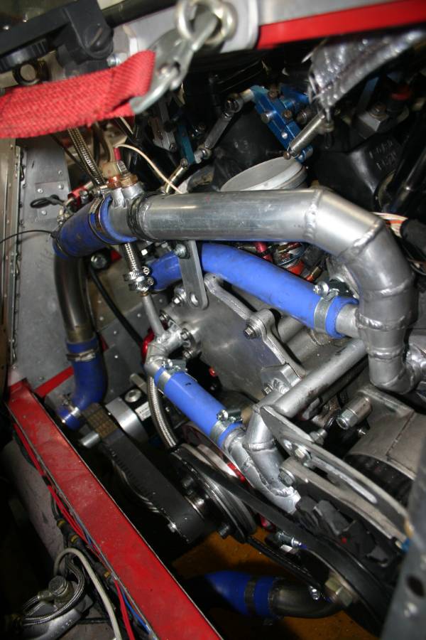

Re: Dry Sumping and Lowering the engine
Hi Joe / all -
If you ever run slicks on your car on track - dry sumping is a must in my opinion.. We log the oil pressure and even with supposed 'state of the art' baffled sump with trapdoors etc etc, the oil fluctuated a lot during excessive cornering/braking.
With the dry sump fitted, the motor gets 60 to 80 psi, regardless of G forces we've thrown at it. Remember most people would suggest 10psi per 1000rpm and you'd be amazed how low it can go without the d-sump.
When pushing hard, and concentrating on things other than your oil pressure guage, the oil can dramatically drop and in any case, the capilliary guages are generally fairly slow to respond. If you are unsure, fit a pressure switch to the block set it light a light if the pressure drops below about 30 psi - then see if it lights up during hard driving.
The pic below shows where Roy placed the pump on his GTD, together with the relocation of Alternator and loss of water pump (electric now).
