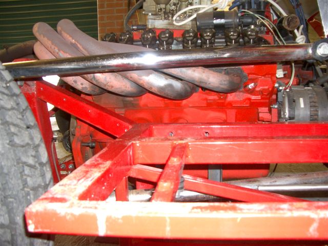

Working within the constraints of the GTD chassis & R21T trans, the engine & trans can be lowered & levelled so the crank C/L is 205mm from the chassis floor. To do this 'some' chassis mods are needed, but you can keep the engine, trans, bellhousing, clutch, suspension, etc 'standard'.
If you want to go lower than 205mm, you need to do alot more engineering & look harder at either cutting into the bellhousing, or inverting the transaxle, shortening the A-arms, and/or heavy mods to the chassis, probably a combination of all of theses items will be needed. As Gary points out, you could even engineer in smaller flywheel/clutch assemblies with reduction gear starters.
The GTD chassis has a transverse member right under the flywheel which makes things a bit tricky. Not all GT40 reps have this member, so if you want to go with a super low engine & trans it may be easier to start with a different chassis.
here's a side on view of the standard GTD setup;

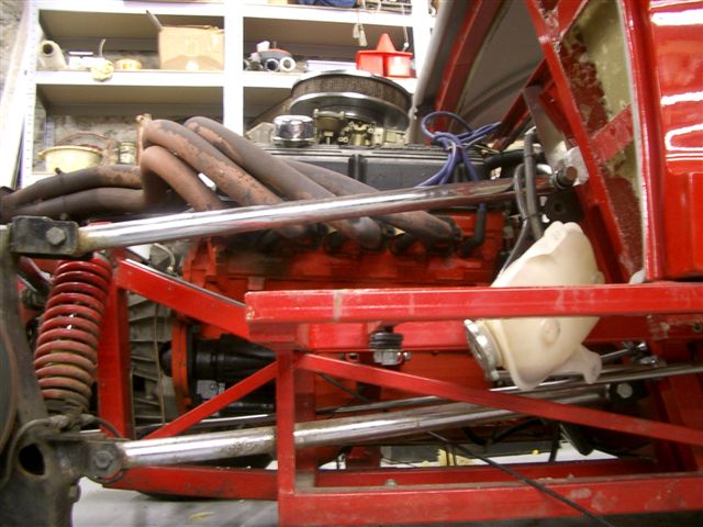

Here's a similar view with the engine sitting level in the chassis with the crank centerline 165mm from the chassis floor.
I'm sure it's possible to sit the engine & trans this low, but I'll probably raise it 40mm to reduce the amount of engineering needed & also to reduce the driveshaft angles.
I'm using a GT40 pattern sump from Armandos oil pans. It's 165mm deep.
With the engine mounted as shown in the second picture the crank centerline is 165mm from the underside of the chassis & hence the sump would be flush with the underside of the chassis.
As I'll probably be mounting the engine with the crank C/L 205mm from the chassis floor, the sump will be 40mm higher than the chassis underside.
