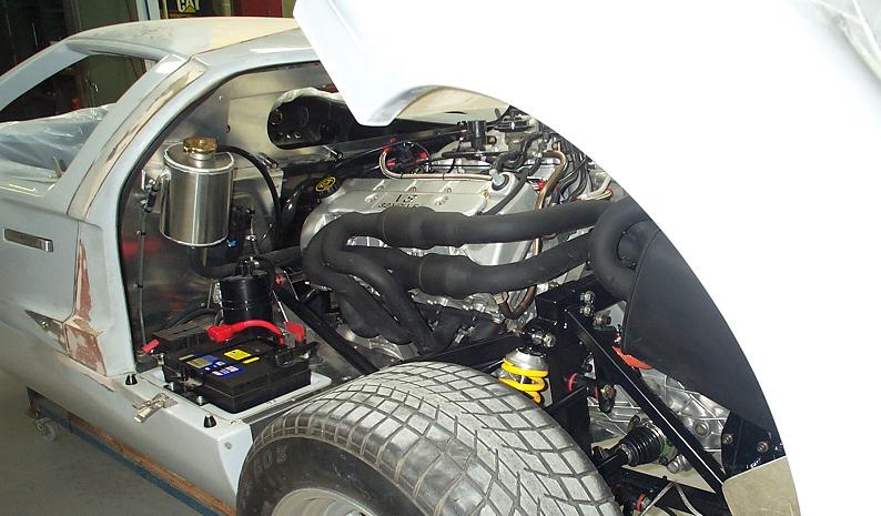

Roaring Forties have done a very neat job of fitting pipes to my car. The "testing set" actually had two catalytic converters squeezed in there. The final version will be even neater, without all those cats, and "silver" jet-hot coated.
