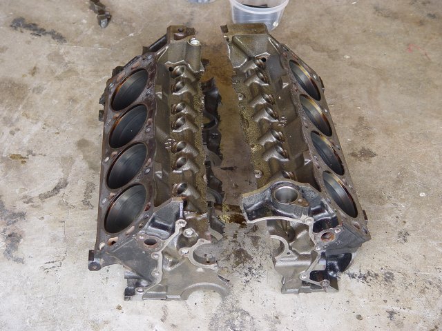

Ross,
The issue Drew was referring to, re: cracking, is not necessarily an issue that 4 bolt vs 2 bolt main caps is going to resolve. It is an issue with the meatiness of the webbing that holds the whole block together. Below is a picture of the result of too much power and not enough webbing strength:

That is crazy, I have never seen something like that. How common is that picture for the stock blocks?

Sandy,
I don't think that happens that frequently since not many stock blocks don't get taken to the >600 hp level. But it does happen as is witnessed by the fact that the guys in Scott's post are making girdles to add strength. Also, those that have seen it happen say that is happens exactly like the block in the photo.

This will help make more power as well I believe. Because of less cyl. distortion. My engine's cylinders will be honed with a cyl. deck torque plate, mains torqued & valley girdle installed. This should go a long way to keeping the bores round during operation.
Oh and Sandy a 80's -90's vintage SBF will do this sometimes as low as 450 HP, depending on how loaded the engine block gets. Meaning a drag race holeshot where the tires really hook good.

The SBF engine forums are full of photos like Lynns the consensus seems to be 450 hp as the max safe limit for the stock 302 block although some have been documented at less than that. No doubt if the tune is way out, that's not going to help.
Some guys maintain that girdles are only good for stopping your parts falling onto the road after the block has split. I wouldn't know, but I'm sure an engine builder will comment. Personally, unless the regs say you have to run the stock block, I'd rather save the money and complication of the girdles and put it towards a stronger block. Whatever the V8 Supercars run seem to be pretty reliable.

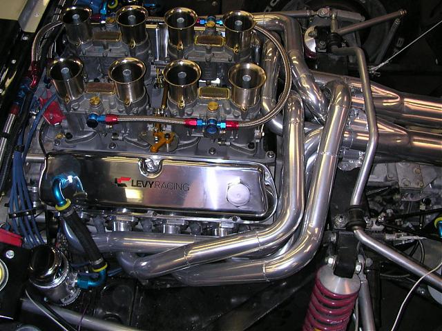

302 R Block, billit rotoating assy, 10.3-1 compression. 536hp/422lbft of torque. 8100 rpm shift point 9000 rpm red line.

Gordo...
What CID ?

I'd say it's a 302 with a 9000 rpm rev limit and the 422 torque.Nice motor!
What size are the carbies? they look like IDA webers.Russ I'll keep an eye on that mustang site. I think when the guy says the cracked B50 blocks were only 400hp motors there is more to it,abuse was mentioned but possible poor assembly wasn't.

It's a 306, (.030" over). Everything in it was designed by me. None of it is off the shelf.
Those are IDA's. It dynoed with an 830 Holley pro series on a super Victor intake. I have having a custom EFI stack intake made for it with 52mm t-bodies.
The only time I have seen a 5.0 block break like that is when they try to put 17lbs of boost to it for to long.
