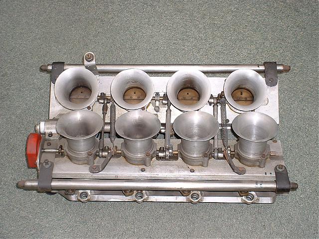

I have a fuel injection manifold from an aluminium GT40 race car. See pic. The engine this came from was a 289 which made 525bhp on the dyno at EDA in Castleford. The engine apparently ran to very high rpm!
