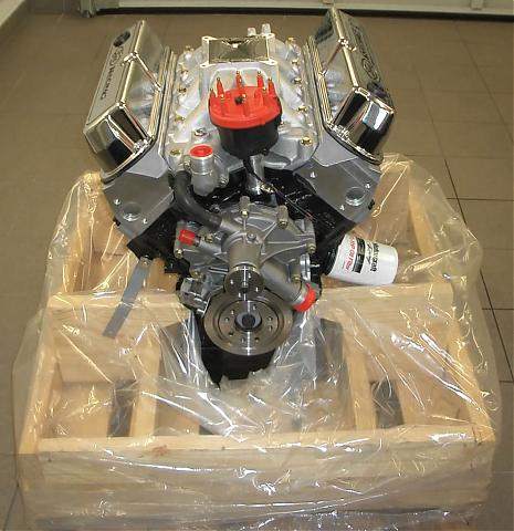

Hi,
after long waiting Santa Claus came and brought me through Sean Hyland Motorsport the largest christmas gift, which I ever got.
So I can start with the next steps for the building.
I need pulleys and brackets for the Ford crate engine 392 (351). Ford no. is M-6007-C392FT.
