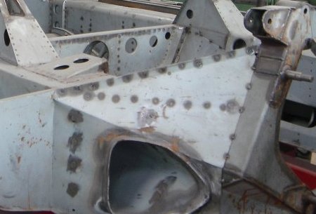

Oh you mean this lawnmower....... yes I understand now......
