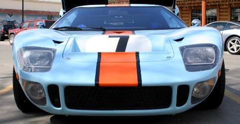

Round Driving Light Option?

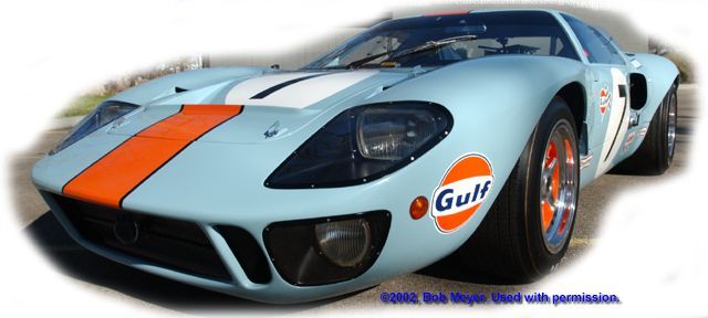

Has anyone successfully replaced the standard fog light/turn signal array located under the headlights with the larger, round driving lights found on several of the Mk I cars (e.g., P/1076)? I thought I had read somewhere that one of our colleagues had located these driving lights with built-in turn signal bulbs.
Whatever the solution, I'd very much like to explore this as a final modification before I take delivery of my car next month. Any recommendations?
You can see P/1076 with these lights below:

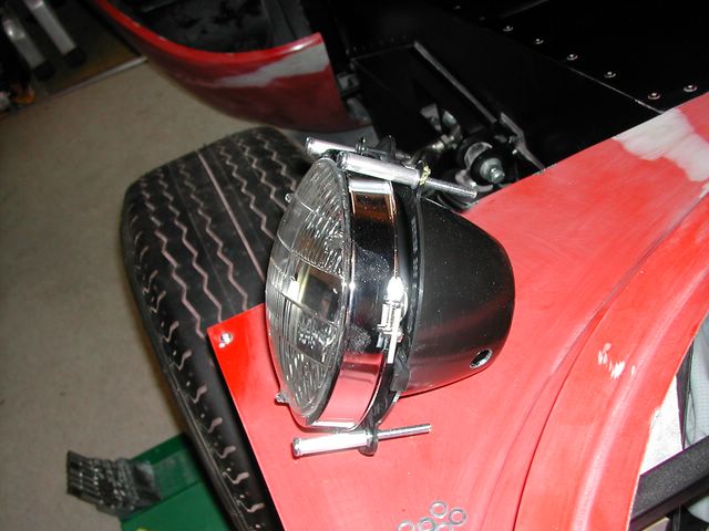

Hi Kim,
I wanted the same look and found Triumph Vittesse lamps were a perfect fit (5 3/4"). You can purchase them in the U.K together with all the mounting hardware. Not sure where you would get them in the U.S but I think there are specialists over there for old triumphs.
Cheers,
Martin

For any vintage lighting solution, Aardvark International is my first stop:
http://www.talbotco.com/
They have a bunch of different mirrors and lights, and probably have just what you need. They do have some 5.75 inch headlights with integrated parking lights, which is probably what was fitted to 1076 and the cars like it.

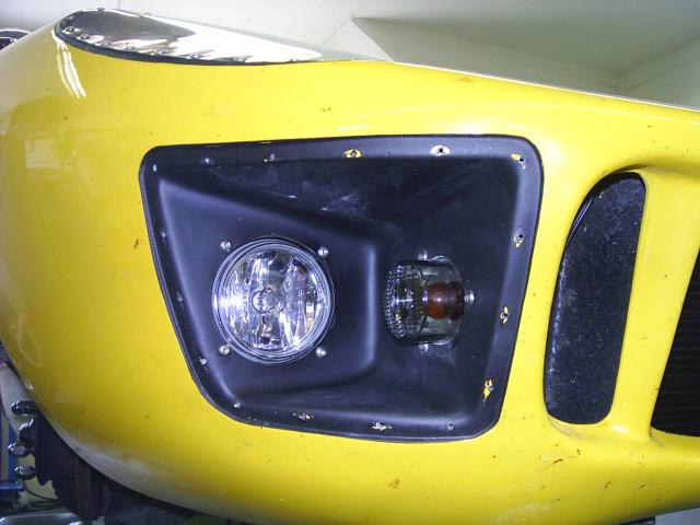

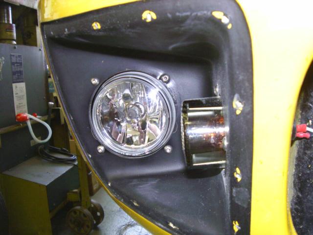

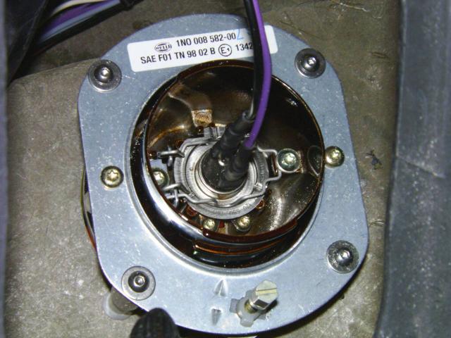

Hello,
Well, try HELLA....
Some pics....
Cheers Mike

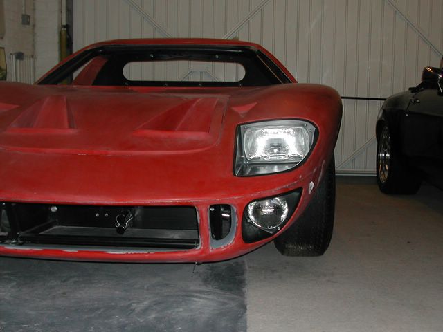

Hi Kim,
On John's 1076 CAV we fitted Cibie (Valeo) 5 3/4 lamps with mounting rings and hardware from Europa Specialist Spares www.europaspares.com
You can choose from hi/low/turn or just high beam units. Nice addition to the car and really not any more fiddly than ten thousand other things you can do.
