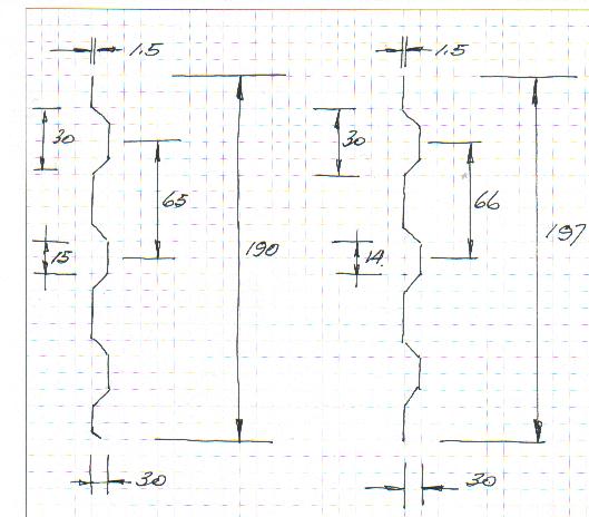

you could add a flat to the channel you have already made and turn it into a box section. Allow the flat to protrude say 15-20 mm each side.
The wavy section ASIB is a very good energy absorber flattening out all the depressions.
See attached for typical section. The 197 wide section is ex Mitsubishi Cordia, Good for a 1100 kg car and door length of approx 1200 mm. The 190 wide section is ex Nissan S13. Cant recall material spec but about 350MPa yield.
You could cut one out of a door at the junk yard.
The proposed method of attaching hinge and striker sounds ok, The A pillar is very sturdy and the mount to roll bar is a good idea. The 0.125" thick matl may be a bit light particularly if the pin /striker is bolted thru it. Some local reinforcement would be a good idea , perhaps a large washer with a different diameter to the one supplied with the striker/pin.
Here is another wild idea-- fill the door with foam -- you would be amazed at how strong and energy absorbing that will be.
Please understand the foregoing is considered informative only, it is no guarantee that it will materially reduce the risk of injury.

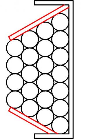

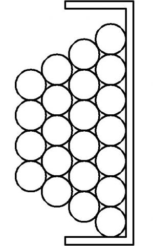

What about a honeycomb system? Flip the channel over so the flanges hold a series of long steel tubes (1/2" conduit?) on the doorskin side of the channel. You could weld in a couple of flat plates to hold everything together. I guess my thought is this would be, in essense, similar to the "highway barrels" used to slow down cars that would otherwise fully impact bridge stantions. The honeycomb would collapse and absorb energy before the channel begins to deflect. Just a thought.
If I can figure out how to add images, I'll add a couple of sketches.
Eric

Anti-Intrusion Beam
Modern cars have intrusion beams but they are made of H.S.S. High Strength Steel. It is completly different from mild steel. You are not suppose to ever try straightening or welding this material for repair or modification for it wil become weakened and useless. The chemical composition and heat treating is incredably more ridgid than mild steel. In all respect I think the mild steel will offer very little protection. When I have worked with similar C-channel I have been able to change the form with a simple 5 pound dead blow hammer. The C-channel is also a weak design for the way in which one would expect it to be hit in the event of an accident. If mild steel would be used I would find something with more beam height for strength on impact. Just my opinion, please take no offense.
