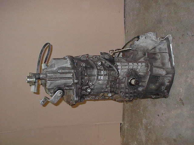

Thanks for the help. I have a NG9 that came from a 88 Eagle Medallion. I will take some pictures tonight and post them. I found car-parts.com could supply Medallion transaxles for about the same price as the Audi. $75 to $450. I paid $250 for one with 42k miles on it. I made a mistake last time when I said jw engineering, it is as Howard says wcengineering.com.
I had the photo of a UN1 / 369 with me when I bought this one. It certainly looks similar to my untrained / inexperienced eye. I'll be interested to see what everyone can tell from the pictures. I did notice that the case casting has some numbers. Maybe they'll match something.

Now to the pictures. I shot all sides and both ends. I included one in normal, laying on the floor attitude and one with the Medallion cast aluminum mounts.
The casting numbers are only on the left side (7700598990) and end cap / shifter (7700598829). They are probably only Medallion #'s and mean nothing.
And the last picture is of the id tag, typically Renault.
(Sorry everyone, but I didn't realize the pictures had to be website based. I don't have a place to post them. Email me and I'll send them to you.) <font color="blue"> </font>

Ken, you can use the forum to host pictures, like the one you attached to your post. If you want to attach multiple pictures then you need to do so with multiple posts - one per picture attachment.
