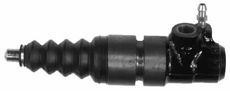

Car Parts.com serach for Audi 5000S Clutch Parts, Scroll Down

They look to be cheap Paul, $60 to $90. I'll be happy to order one and post it over to you, just let me know. My local shop can have them in 24 hours and it'd be about 4 days post.

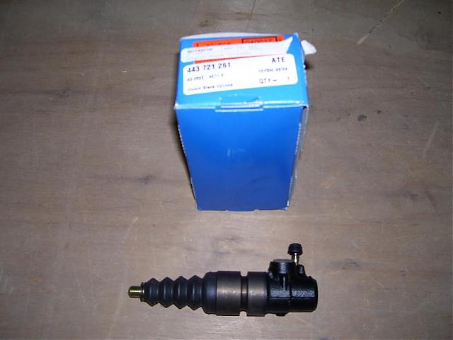

I'm sure several companies make these....mine was made by ATE in Germany.
Box says pn 443-721-261....may or may not be ATE #.
www.contiteves-am.com
