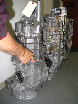

The gearbox id number is typically found in the middle of the gearbox on the midsection or bellhousing section at the bottom of the gearbox installed rear-engine, or if inverted for mid-engine it would now be on top. See the picture for referance, it is a shot of a G50-52 heading out for delivery. Notice where Stan's finger is pointing. Your id # should be in the same location, and should start with a G50 and followed by a type and id #.

That is a casting number, some times the id#'s are hard to read because of their location on the bottom of the gearbox. They get a lot of grime and road debris due to their location and sometimes can be partially worn from scraping.
Double check that you are looking at the same part of the gearbox that is in my reference picture.
