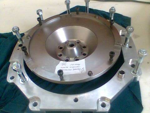

The 1uzfe is a great little motor --go the 01E (or 012 )
better still is the G50 / 01 --these should be readily available from Germany , not too far away?
Name:	Lexus Audi 01E adapter and flywheel.jpg
The Trans Adapter Man
