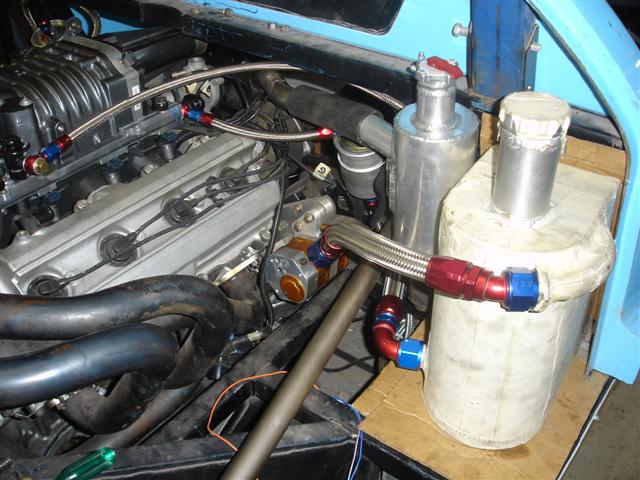

Mostly engine related as it's *wide* and high in comparison to the SBF due to the DOHC, it's not _as_ wide as some DOHC V8's but still pretty wide. In common with all other DOHC's and unlike the SBF it also has the cam gear on top of the heads which with the slope of the firewall causes problems.
It is mostly the gearbox however that has caused me grief, I'd still have a bit of an issue on the rear exhaust ports but dropping the engine an inch would make my life an 'easy' case of moving two tubes and adding two more.
I will add though that as you're planning on making your chassis you wouldn't run into the same problems, some very simple modifications and it's an easy fit but if you're planning on building in the US I wouldn't even consider the 1UZ-FE, go SBF every time.

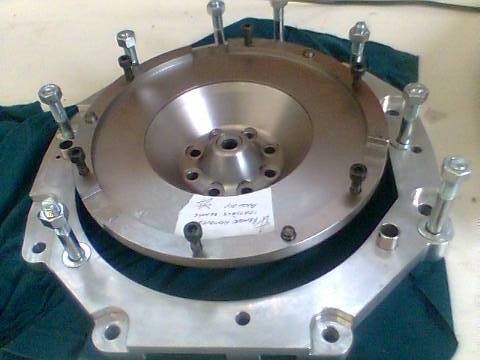

The 1uzfe is a great little motor --go the 01E (or 012 )
better still is the G50 / 01 --these should be readily available from Germany , not too far away?

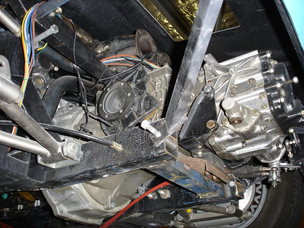

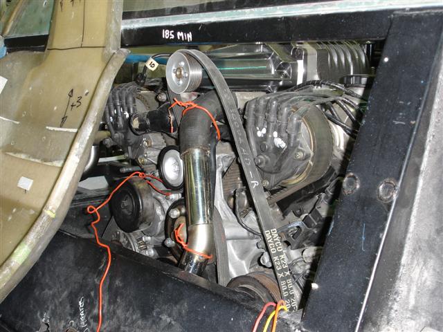

I really wish I'd taken a later picture (or at least moved that box first!) as its not in this position any more but here we go.
That's with the engine sitting nose down by roughly 3 degrees, currently the engine is level which means the cam covers are roughly level with the rear seatbelt mounting bar/roll cage bar, to give you an idea of where that is the water outlet from the front bridge is up against the bar. That's as low as it gets and requires lots of the standard stuff removing and being custom to fit. If you're not careful you'll end up with the supercharger out the rear window!
Hoo-Dawgies!
Well, I guess that does it for that idea :) As much as I'd like a good view of the supercharger belt, having one located between me and the passenger wasn't exactly what I was looking for. Besides the wife's hair might catch in the pulley...
Back to the drawing board then...
