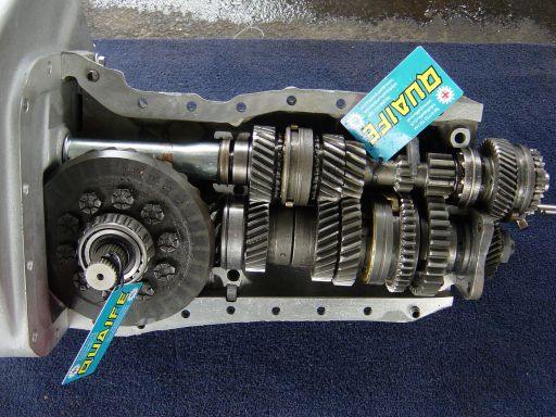

You all need to speak to Chris Coles nicely...

I second Brett's comment: Chris Cole is the man.
