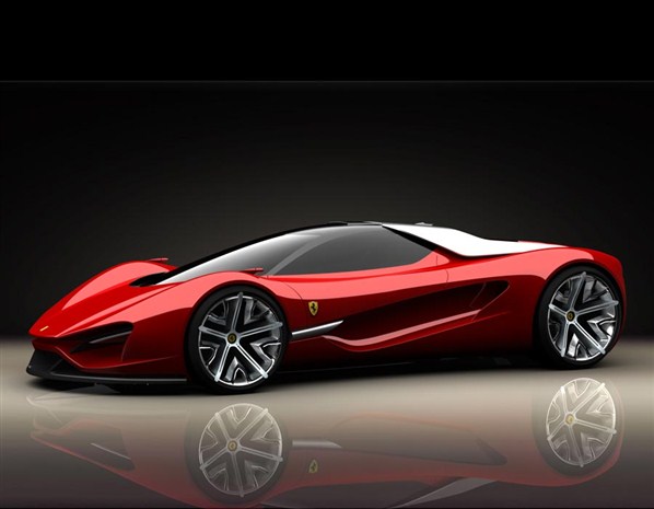

I would have liked to have tried to do the upper rear scoops like on this Ferrari but I don't think it would be possible, not sure how they would have done it either but they do look cool.
I started looking into doing something along those lines, problem is with the fuel filler area. You would have to have a big hole in it to access and try to shoot the fuel in from a distance, or, extend filler neck out, which would also be visible from the inside and couldn't open clam.
You would have to start them past the filler neck, which almost puts them too far back.
