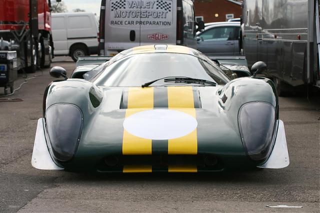

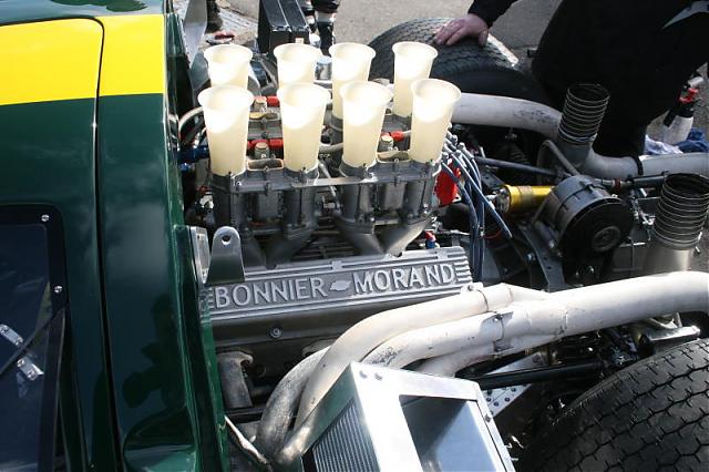

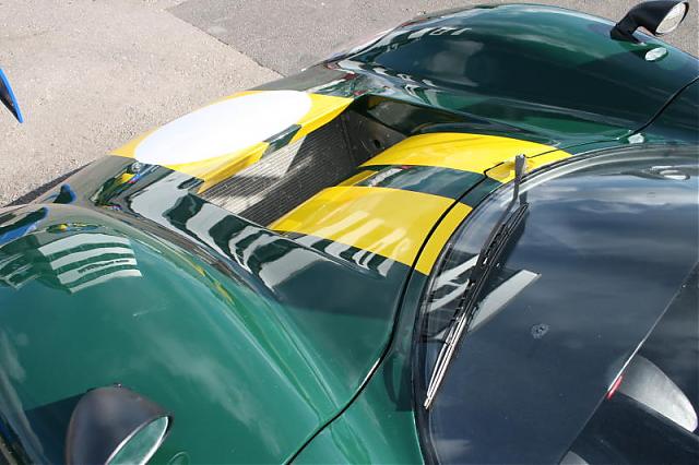

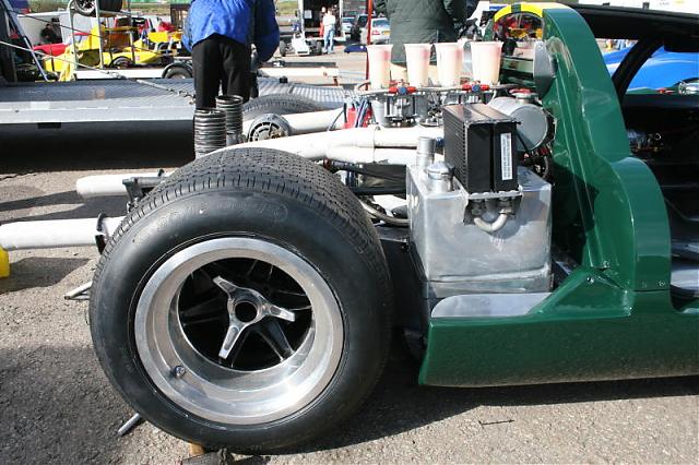

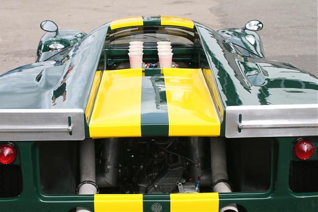

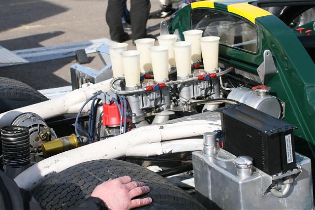

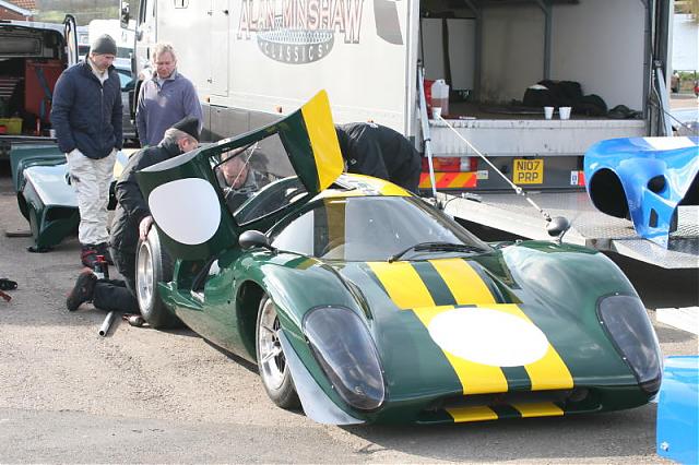

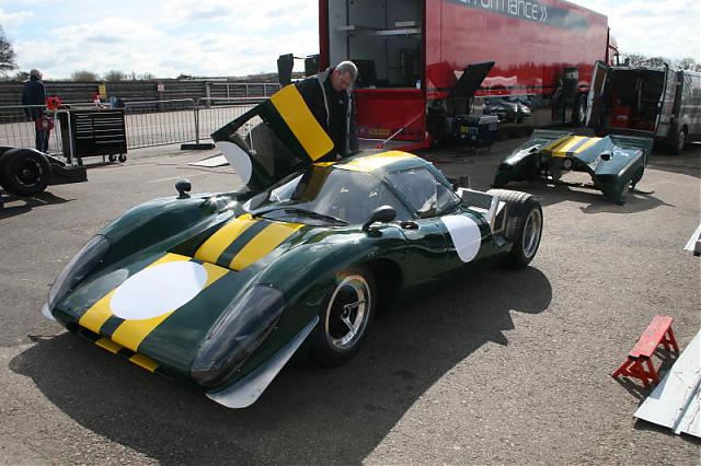

Hi all -

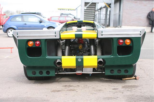

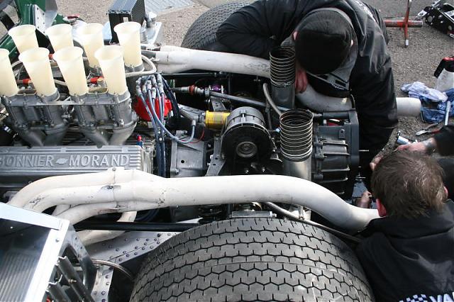

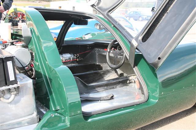

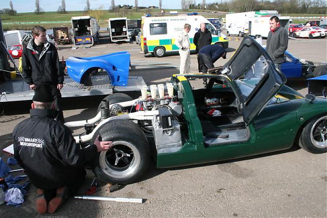

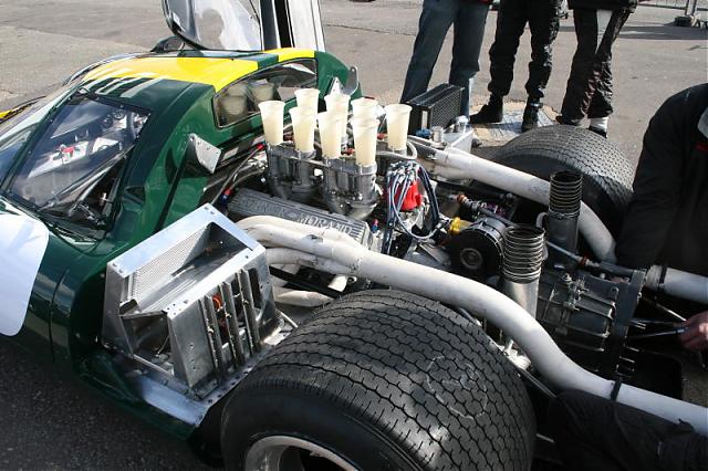

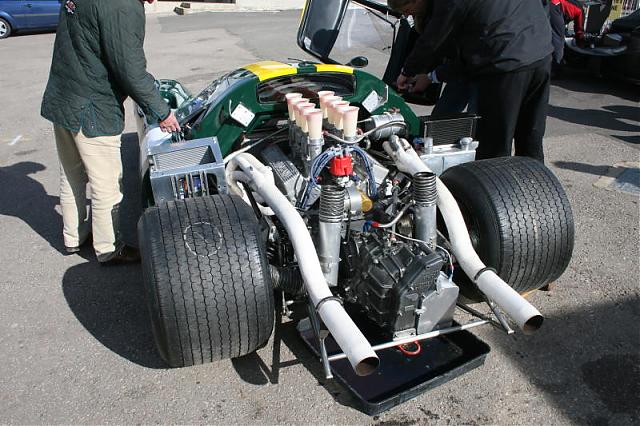

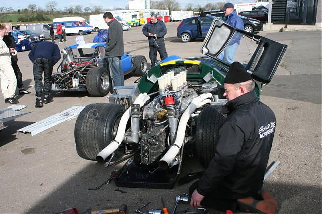

I was at a test day today, supporting some friends and came across this in the paddock amongst some other 'nice' machinery...rockonsmile
It looked and sounded awesome having just been "rebuilt from a bare chassis in the last 14 days"...
But, alas, it was not hooning around the track as there was a transmission issue. Speaking to the engineers, it would appear that there was possibly a shimming issue that left it stuck in second once driven (trans had also been rebuilt). All the gears selected ok prior to today, but this would have been the first driven test... Still, better to identify on a test day rather than a race day, after all, that's what test days are for...
A few pics...

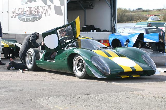

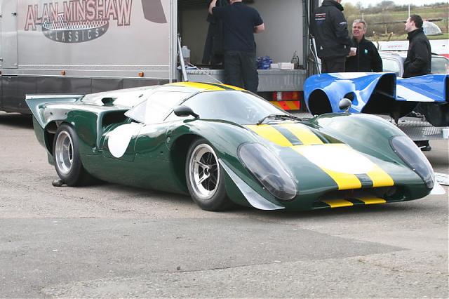

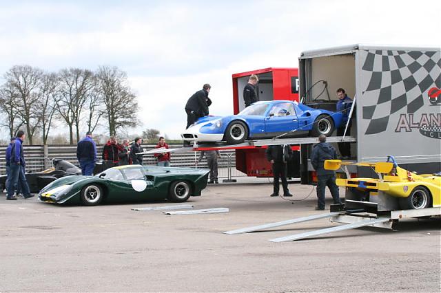

Couldnt help noticing the Allan Minshaw name on the Chevron Transporter, looks like the same car that was out here in NZ @ SFOS about 4 years ago ( albeit in darker blue). Tell him to come back again, JO needs the competition.:)
Yes, SL76/147..
It used to have red around the nose inlet. I love the color of that car.

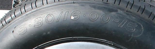

My eyes are not so good but I think those are big Dunlops...

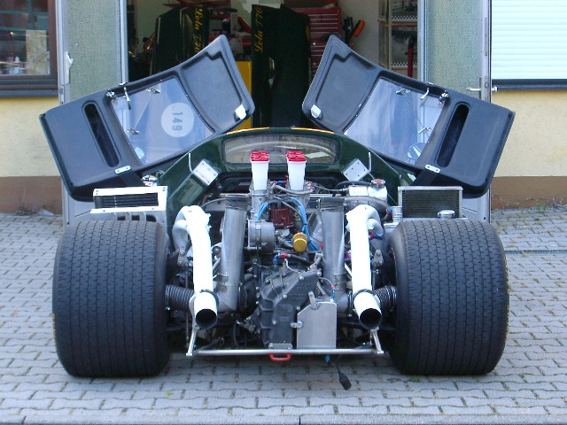

Good old SL 76/147...note that it still even carries its original oil tank,
quite different from the one utilised in Lola´s continuation cars nowadays.
Here´s a pic of the car parking around the corner from my office:

Hi Paul
You will be pleased to know we found the problem with gearbox, new dog rings , new hubs , they were just to tight, the gearbox guy had to lap them in with valve grinding paste !!
Back at Mallory this wednesday !! Hopefully she will turn a wheel this time.

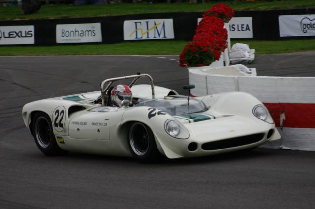

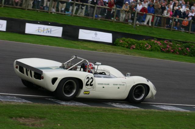

Thought you might like to see the other Lola I am lucky enough to own.
SL71/31 . The Denny Hulme spyder.
