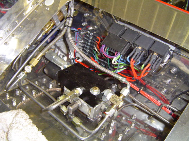

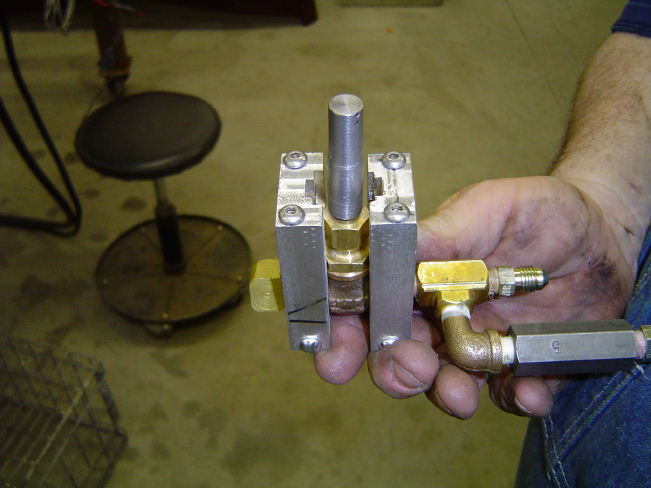

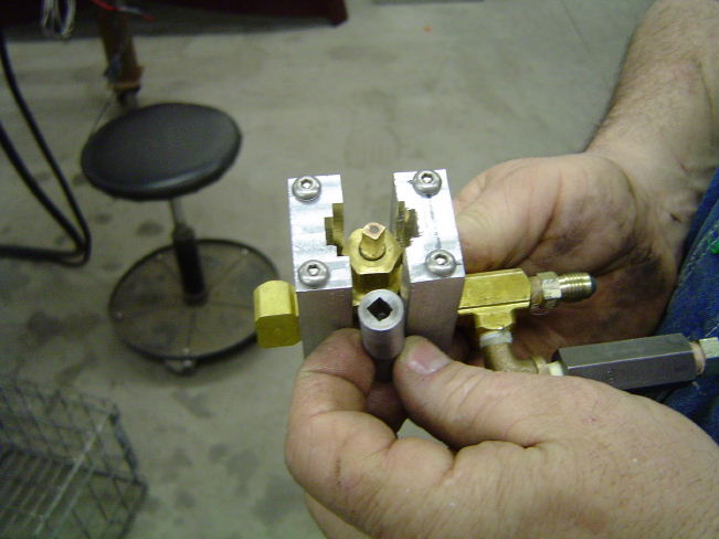

We designed and built remote operating gull wing doors that are controlled by these valves. If the system freezes in the up position we made a tool that can release the doors and is accessible through cockpit.

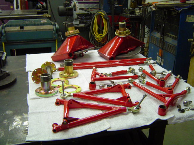

Note suspension parts. We've plated as much as possible to avoid corrosion.

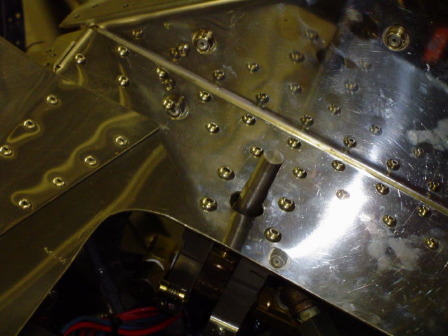

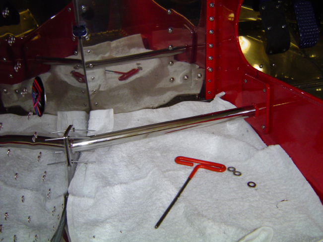

Tool port

Jim, did you paint or powder coat the suspension pieces; I am thinking about what we will do with mine...
jimbo is offline

Uprights paint. Other parts plated. Some powder coated. The trick is to plate as much as possible. (Gold) Esp. parts that are steel.

Is the plating yellow cad or some other hybrid?

Yellow Cad.

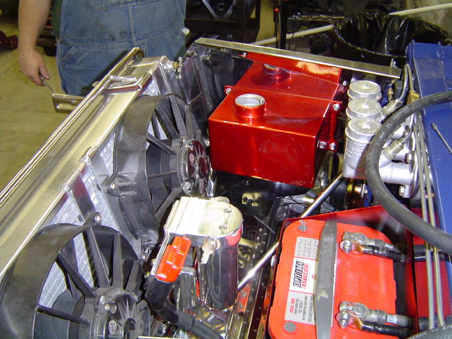

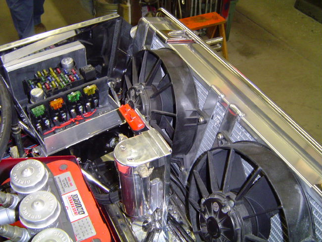

Note red window washer tank.

Not me Custom Fab and Welding. Note plug in near battery for Charger/Jump. (I told Joe Kern that if they don't finish before 4/10 you're going to...)

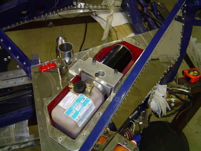

Hydraulic pump for gullwing doors.

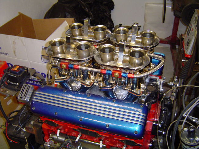

Engine going on start up stand to be tested and dropped in.

Previously you pictured your valve to release the doors if stuck in the up position. What I am curious about, is what happens if you can't get the door open ?? You have the electric pull down latch at the bottom, and the hydraulic cylinders also, if memory serves me right. Do you have an emergency release to get the doors up ?? If I remember correctly, you have a valve to hold them up, while at a show for extended periods of time. It sounds like you have all the bases covered, but I hadn't seen anything about the up situation. You have a beautiful car, with excellent craftsmanship. I hope to see it April 10th.
