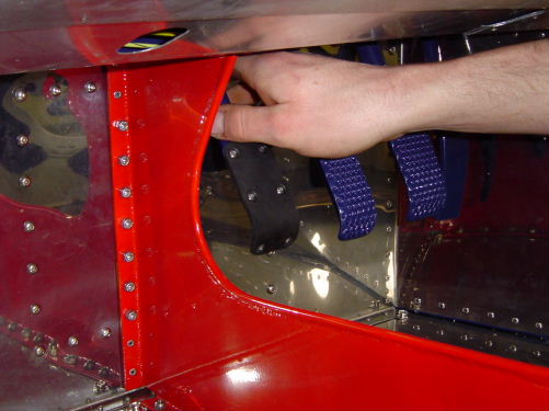

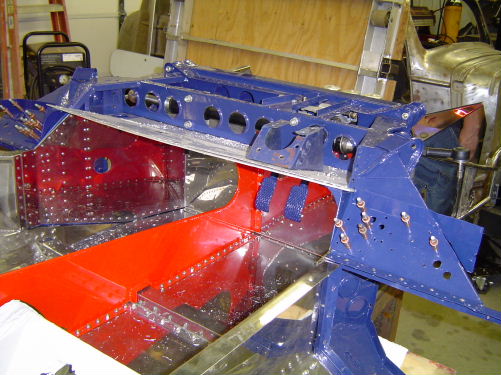

Donohue/Pensky often "tarted up" their cars esp. tubs and this fits in with the lipstick red interior. The exterior remains metalflake Sunoco Blue with a touch of Pearl. When the structure is all one color you don't notice how it's put together as much which I enjoy so I went this way note restored footbox.

What a fabulous series of photographs! The workmanship is absolutely superb.I only wish that I could be there to see it in real life. Please keep posting the pictures, it is great to see it all coming together.

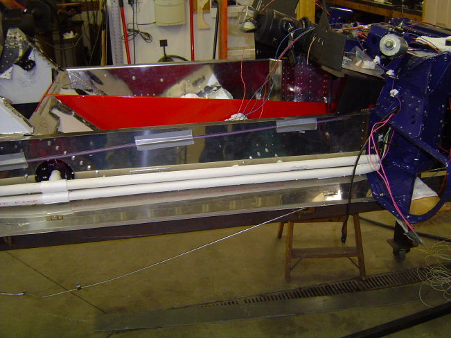

Lola simply ran wires through this area right up against the fuel cell. We're running them through pvc.
Wow, that's amazing that Penske/Donohue would have the wiring run like that. Jim, in the Penske spirit don't you think you ought to change that PVC out for some alloy tubing, mirror-polished and drilled for lightness?

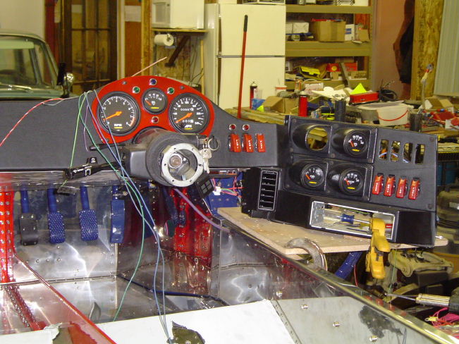

GM steering column complete with tilt and wiper controls? That's a trip.
There's a bunch more footroom in there than in a GT40, isn't there?
Scott
The tilt makes it much easier to get in. The radio is also an in dash CD player. It's hard to see but we screened Lola emblems onto the gauge faces. We made a 240mph speedo from a 120mph unit by making a new face and changing the calibration. A bit trick. The car now uses a standard GM wiring harness which is nice.
