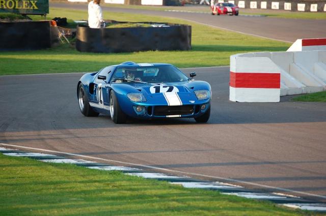

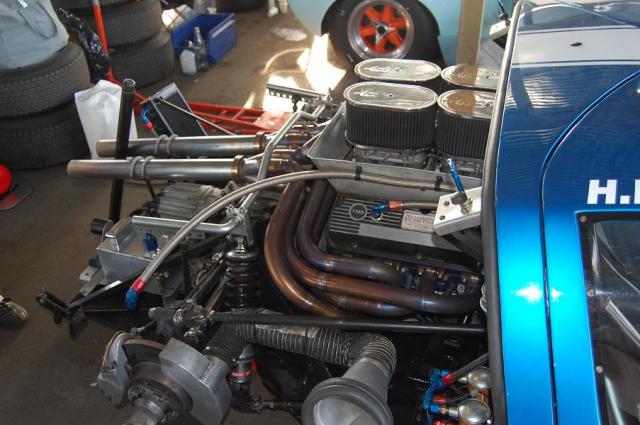

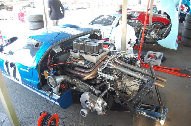

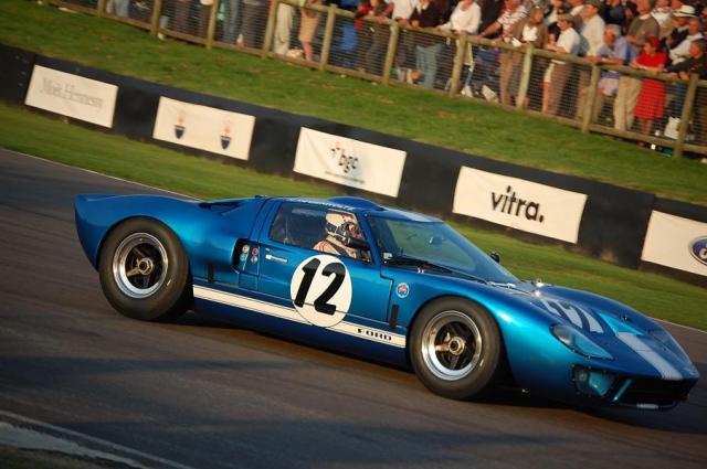

Some Goodwood Revival pics of 1062, showing the new exhaust system.

Re: pics of 1062 rebuild
Interesting rear brake ducts. Do they work better than the original set up?
FRPGUY is offline
Old 10-27-08, 07:52 PM   #17 (permalink)
HHH
hhh's Avatar
hhh
France
Join Date: Dec 2005
Location: Belgium
GT40: '65 GT40
Posts: 24
Rep Power: 4 hhh is on a distinguished road
With the original discs being solid and the speeds we are running, you can never get enough air to the discs. They are effective.
