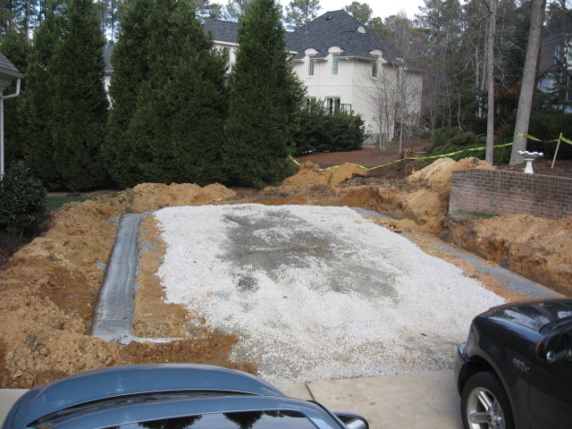

Finally!!!! Some progress. The builders have started with the footings being dug and shored up, hopefully next week the foundation will start. Maybe this thing will actually come to pass!!

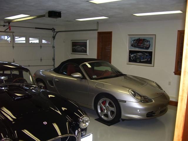

Ron,

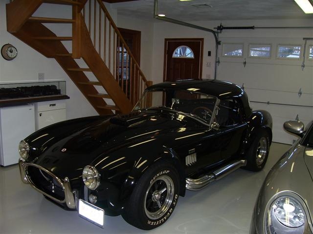

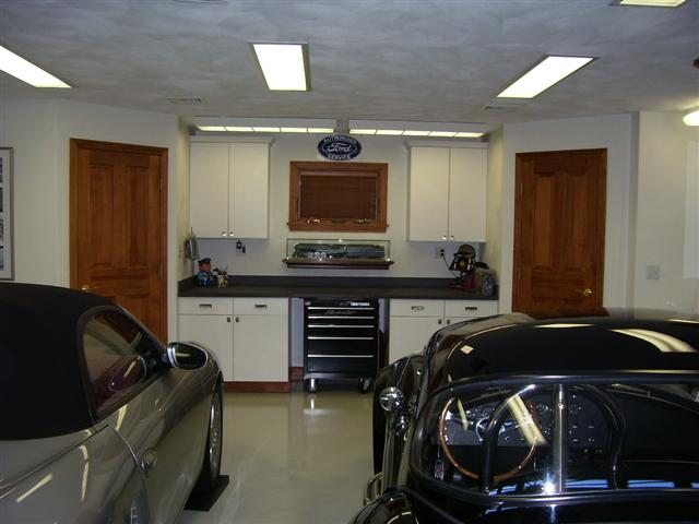

I don't understand how the tiles can work out but, many use them ( doesn't water run off from wet car or even condensate drain from A/C ,oil, ect seep between the cracks or into the open mesh of some types and accumulate under the tiles causing dirt and mildew build up?
Well due to that concern when I built the new garage 8 yrs ago went with Benj Moore industrial epoxy and as you can see from pics below after lots of engine, tranny, suspension work to the Cobra over the yrs the floor just needs a sweep or quick wash and it's clean. I do use plywood under jack stands and cardboard if a major job but, no real day to day precautions.
Steve P2125

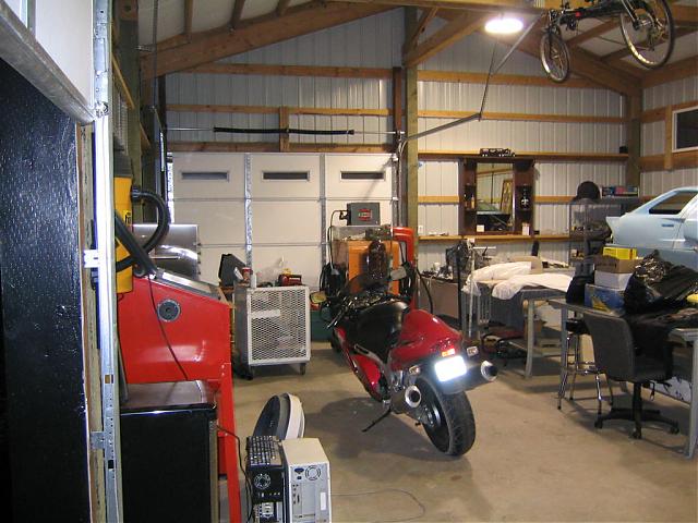

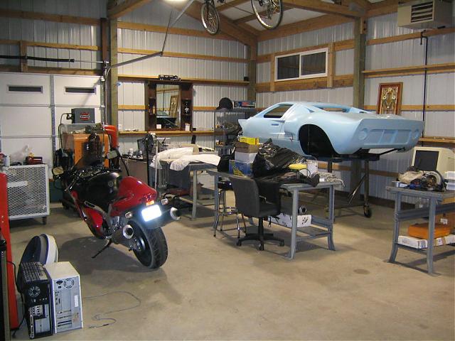

Ron,

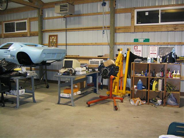

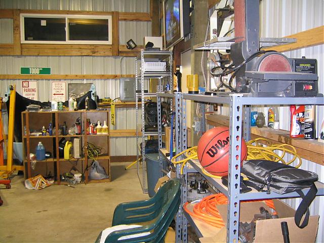

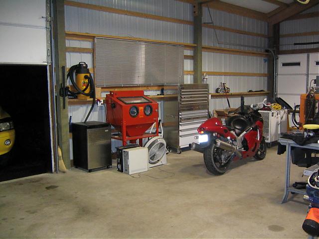

My shop is 24 x 36 x 14 ceiling. These pics should give you an idea of space usage. I can still get a 21 foot boat and trailer in the door where the bike is and my truck in the other. I put a lot of things on wheels to help move things around if needed. I'm right in the middle of shifting things around as these pictures were taken.
Pete

Originally Posted by steve c View Post
Ron,
Steve P2125
From what I have seen all of these tiles have feet, so to speak, so the full tiles doesn't sit on the floor and there is an air gap. This is one reason why you can't put high preasure loads within a small area on these floors, such as a trolley jack or a unsecured 4 post lift. The air gap is supposed to keep the subfloor dry as any amount of fluid spilt should just run under the tiles, if the tiles are the perforated type, and out of the doorways. By code garage floors, that are within close proximity to a house must have a pitch towards the doors to allow gasoline etc. a place to exit rather than pooling. The non-perforated tiles, according to the manufacturers, have a tight enough seal, when locked, that would not allow fluid to get through the connecting edges, so the fluid stays on the tile, I'd need to see that to believe it..!! I also noticed that these tile manufacturers, such as RaceTrack, push the fact that they are great for building a temporary pit area outside on dirt, sand and grass etc. more than they do as a permanent surface on a concrete floor in the garage.
