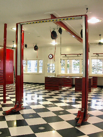

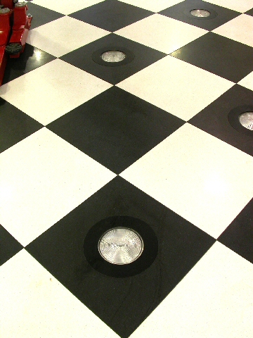

Ron,
I would mount lights in the floor under where you plan to install the lift. Makes seeing the underside easier.
