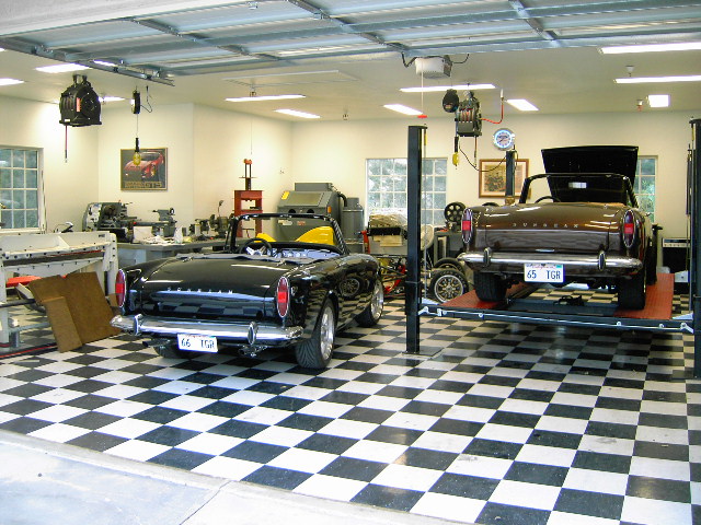

Ron. I had to deal with site limitation similar to you,but I also had to contend with a height limitation(no higher than the roof of my home. My compressor is outside in a little shed, it is a commercial grade and runs quietly. There is a sink off to the left side, the floor is Armstrong commercial tile.
Forgive the funny little British beaters, it is now jammed with the Indy car, 2 Gt40's and only one Tiger.
It is 30' by 34' 1000 sg ft was the max the county would allow me.
Lots of light, lots of power, lots of windows and well insulated.
Heavy steel work benches, one that will support 10,000 lbs.
One thing about being small, everything is close at hand!

I stand by my previous comments on this.... That's very nice Dave.

What did you use on the floor, is it vinyl tile and how long after the concrete was poured was it applied?

Tony
That is Armstrong Excelon tile, 3/32's" thick used in warehouses and grocery stores.
It is vinyl but very durable and easy to install, the design goes all the way thru so it cleans up and polishes nicely.
I put it down about 2 months after the slab was poured.

I put that flooring in my kitchen using double sided carpet tape squares in each corner so that I can easily pop out a tile. My wife likes the vitang diagonal checkerboard pattern. It wa really inexpensive. Two years later and it looks great. Cleans up easy too. I will put it in both garages I think....

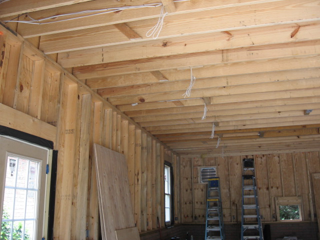

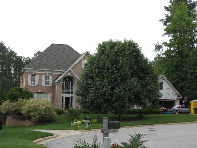

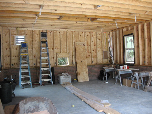

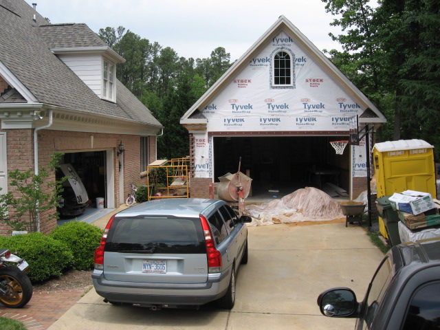

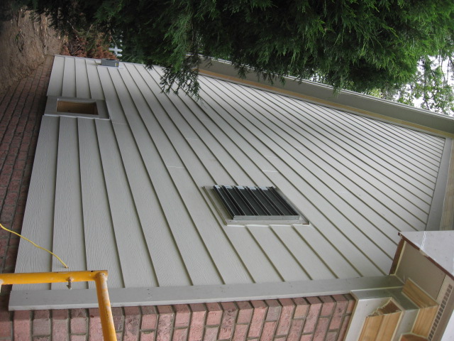

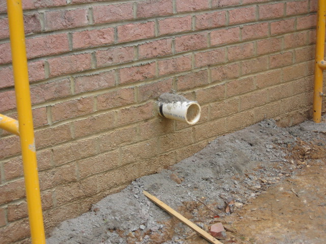

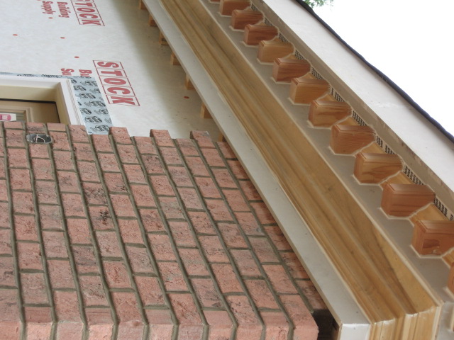

It has been a busy spring around my place. I've raced quite a bit since the last time I posted about racing, I think six times. Have had some good times with the Z, I'll try to post about them in the race area. My third floor of my house is now built out and finished, came out looking great AND - the garage is just about done.
I've enclosed a few pictures of how they are coming long. It has been a bit slow, especially for some particular aspects of it like the dental trim that goes around the garage that precisely matches the house. We wanted the garage to look like it belonged with the house and the builders have done a fantastic job. The window detail matches my house, trim, etc.
Build out inside the garage isn't finished put power is run. The garage has a separate 100amp service and has power outlets every 4 ft on the walls, or less. Three 230V outlets, has an exhaust fan with auto louvers, and a built in AC unit as well. The garage will be insulated and drywalled of course so I think it'll be a good place to hide from the 90-95F that is common in these parts from late May to early October. Water is plumbed for a good sink setup.
Lighting is speced out pretty well, we've got 12 fixtures over the length of about 34 ft, so fairly close together. Also have some deep cement floor pads that were poured with the foundation that will facilitate lift mounting. And, I've got a little pipe that goes through the wall so I can hook up a flexible exhaust pipe to that pipe and vent sound/fumes outside the garage to a external muffler, or, I can hook a funnel up to it and pee through it for convenient relief.
All in all it is coming along well and I'm looking forward to moving into it in 3-6 weeks, depending on how the brick masons get on and so on. Be good to move out of the little 2.25 car garage that now house my cars, or doesn't house them since I've got one off site (Jensen, we don't talk about that one though).
So, this is basically "where my GT40 went"....at least I'll have a place to put one should I ever manage to acquire one!

Very exciting Ron. Looking good. One thought that I figured I'd throw out there just in case you hadn't thought of it, and just in case I didn't mention it way back when. Have you considered wiring your lights on two or three switches/circuits? Then, you can turn on lights with out turning on all of them. I have done this in my shop, and regularly use only half the lights on the ceiling. Then, when I really need all of them, I have them available with out spooling up the meter all the other times.

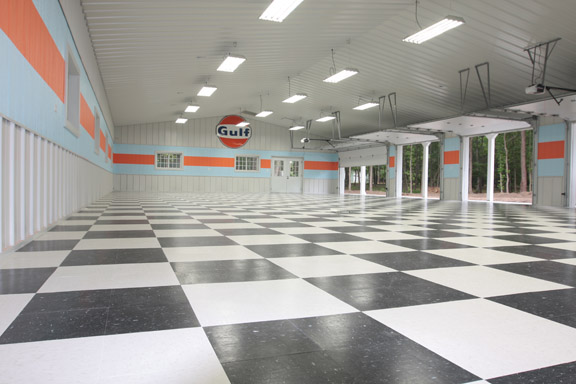

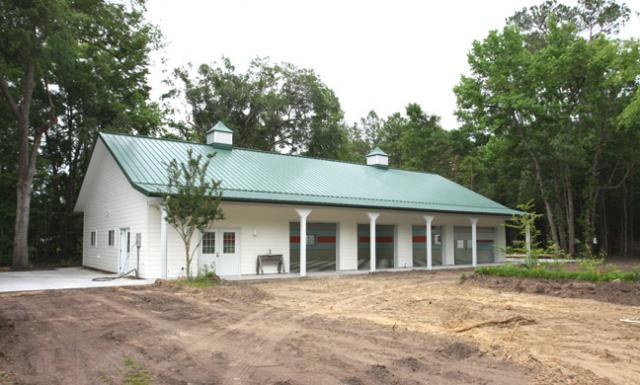

Gordo's Garage...almost done. Cars, art, tools...on the way. Stop in when in Charleston, SC.
G.
Yep, we did do that and I think it'll turn out to be a good idea. I've got multiple circuits for the power and so on as well. I hope it'll be enough light. I thought at first it was overkill, but sometimes I wonder if it'll be enough - you simply can't have enough light.
I've got a separate panel and meter for the garage so we'll see how much juice gets sucked down out there. I've got a feeling a fair amount....

Gordo, that is a fantastic space

The garage looks nice. Lots of space compared to mine. I am finding now that as I am laying out this chassis I am building that I may need a hoist to move the chassis around as it gets larger. I am working by myself most of the time so a small I- beam in the ceiling even in one area might be helpful. You can attach a comealong or chain hoist and lift with straps or chains so you can work by yourself.
Dave
P.S. Ron if you can run a 200 Amp Service in your garage I would do it now. Price wise the panel is minimal. The wire from the meterbase is more. Welder 20-30 Amps 220V, 5HP compressor 30Amp. Air 20 Amps etc. It gives you more leeway for the future.

Gordo... could i just move in to your garage???
I wouldn't take up a lot of room..
Seriously that's nice!!
