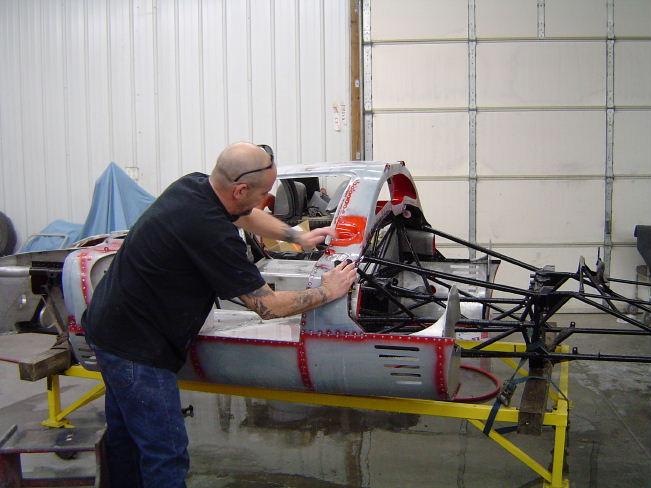

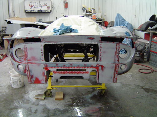

Adjusting final door gaps.

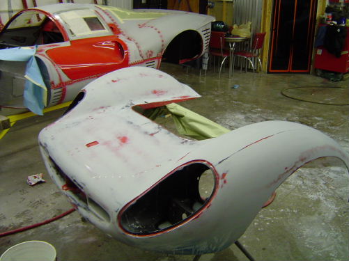

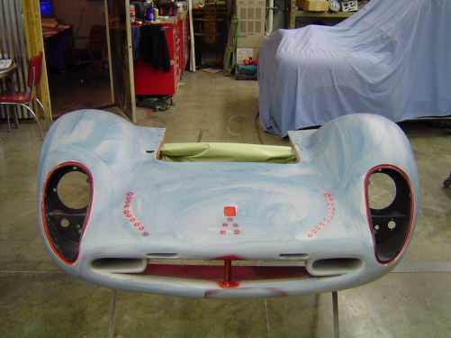

Guide coat. After sanding blue stays in scratches showing inperfections.

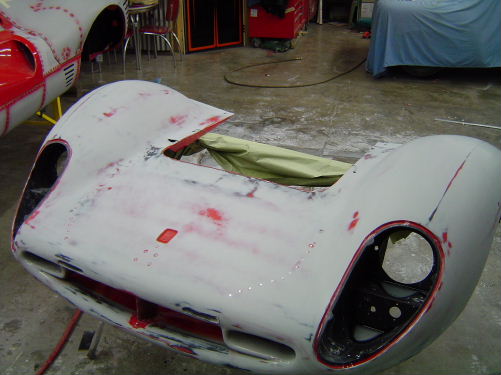

#2

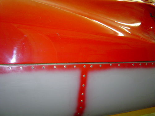

#3

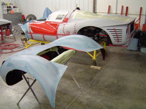

Next

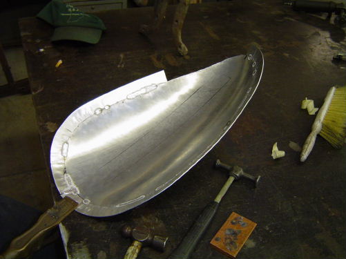

Tail and head light mold.

Head light cover mold.
MK -IV J6 is offline

Jim, does the shop actually mold the headlight covers in-house? That's interesting. I've often looked at the covers on my Lister replica and wondered where I could get replacements if the manufacturer ceased to exist.

We're trying to restore it the way we think they built it therefore we're making the headlight cover molds ourselves and taking them to some one with a big enough oven. When you see these cars in person I'm always surprized at how small they are.

that is how the headlight covers would most probably have been formed, I have made acrylic covers the same way, I have friends who used to produce windows for other race cars the same way.
You will need formers to stop distortion due to heat though.

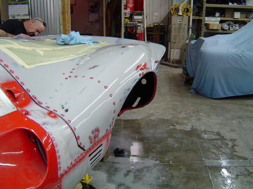

Sanding away...

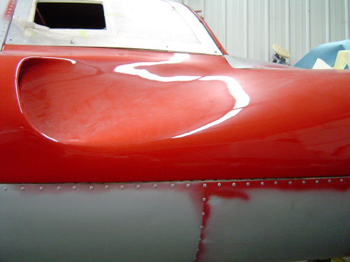

Ready for masking...
