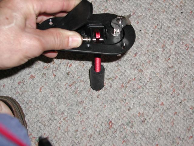

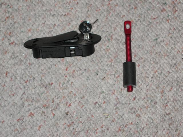

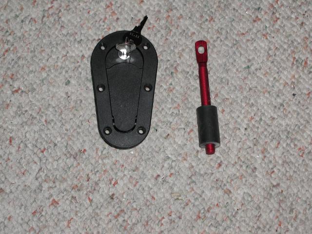

I Have the same fear as I am an ex-hyperactive. I say that because I have to force myself to slowdown so I don't forget where the socket wrench is that I have just laid down. It is a dangerous disease, and has caused me many unseen verbal attacks on myself because of it.
Seriously, it is easyier than most people know to get distracted and not know where you left off. In that vein, I have taken precautions that will not allow that to happen to me. I am installing the "Aerocatch" system to the rear clip of my 40. It is an ingenious system that "will not" allow you to overlook latching of the rear hatch.
AEROCATCH.NET
This site explains the mechanism quite nicely. I will add that the flap remains up until it is locked in place. I have the keyed version. With it you cannot remove the key until it is locked in place. It utilizes the same type of mounting as the CAVs slam lock for the rod mount. I think it is even better than the rod through the passenger compartment into the rear hatch mechanism seen elsewhere on the forum.

Old 05-04-08, 05:39 PM   #23 (permalink)
Howard Jones's Avatar
Join Date: Jun 2002

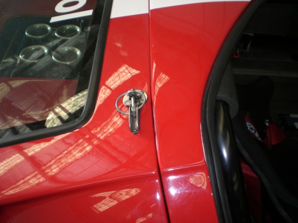

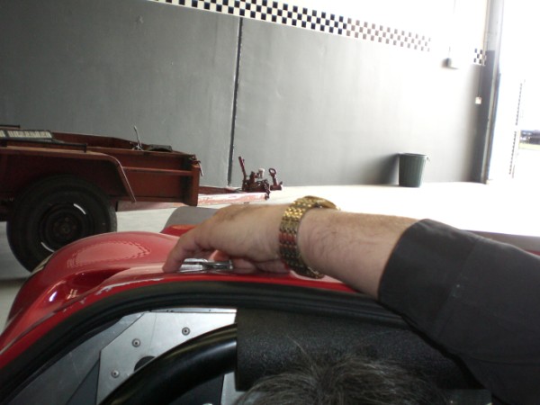

Re: Well, I wasn't going to tell anyone......
I've developed a system that works for me. Every time the rear clip is closed I fit the locking pins and over centre catches as well. I lock one side and then move around the car and lock the other. I don't entrust this job to anyone else and so far so good I haven't had a problem.I will admit to moments on the pre grid though, where I've had doubts if the catches are locked. I can, reach my arm out the door to the locking pin on the drivers side and after I have satisfied myself all is ok on this side I am happy to go racing. Glad to hear you have it fixed Dean, I get annoyed when competitors hit my car, especially when they lunge at a gap that never existed.

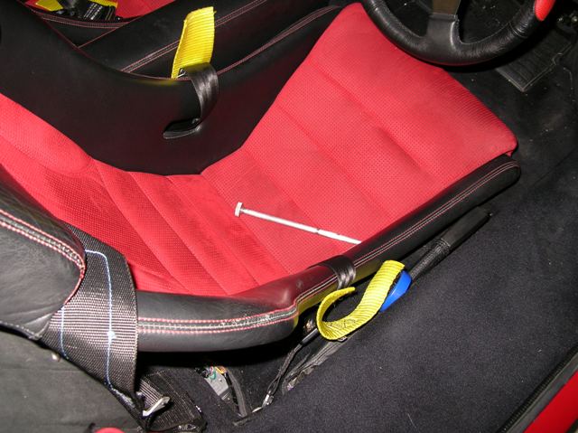

Dean, glad you were not hurt. DRB have in addition to the side locks a pin that goes through the door pillar and through the clip locking it securely.
With the door shut it cannot possibly move. When I have the clip open I throw the locking pin on the drivers seat so if I jump in without it in place it sticks me in the Khyber as a reminder to put it in.
Name:	pin outsmall.JPG

Smile Re: Well, I wasn't going to tell anyone......
That setup of Petes in the DRB, if the pin was moved outboard into the 'door cavity' and the door frame reworked in the pin area so that the door would only shut with the pin correctly fitted, plus the pin configured so it was a captive item in the pillar, would be a fail safe system then. Only issue would be if it was in a race situation & marshalls etc couldnt open rear clip without doors opened first.
I was thinking along the same lines - some sort of spring mechanism similar to hood/bonnet
releases such that the pin when not locked into place is sprung out and prevents the
driverside door from closing. The pin can only lock into the proper receptacle if the clam
is closed.
However, the issue of not being able to open the clam if the door is shut is definitely a show
stopper. Some sort of external emergency pull would be needed to disable the mechanism.
Maybe some sort of double spring action where the housing inside the clamshell can also
be locked into place by default, but have an emergency pull that releases the pin housing
and slides is rearward. So, to completely close the clam, you'd have to lock the housing
into place, close the clam, and then slide the pin in from the driverside door and lock it into
place.
I like the Aero Catches like Bill posted above - when open they are really obvious.
I also have a cu off switch mounted inside the rear clam and have to reach through the side vent to turn it on - it puts my clips directly in lin of sight.
