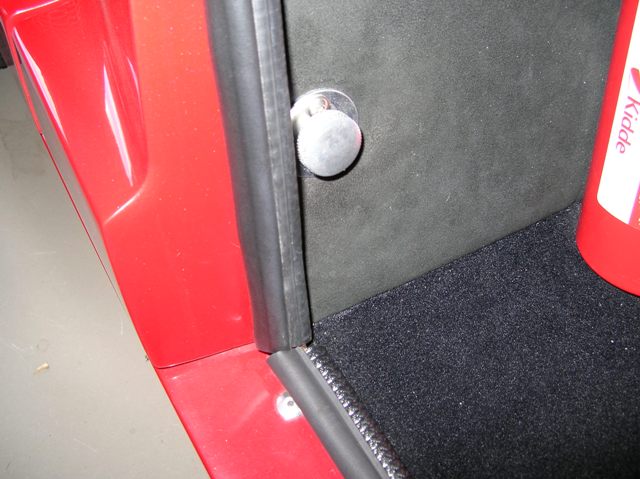

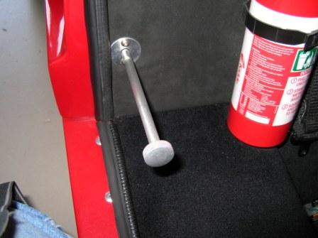

Dean, glad you were not hurt. DRB have in addition to the side locks a pin that goes through the door pillar and through the clip locking it securely.
With the door shut it cannot possibly move. When I have the clip open I throw the locking pin on the drivers seat so if I jump in without it in place it sticks me in the Khyber as a reminder to put it in.

That setup of Petes in the DRB, if the pin was moved outboard into the 'door cavity' and the door frame reworked in the pin area so that the door would only shut with the pin correctly fitted, plus the pin configured so it was a captive item in the pillar, would be a fail safe system then. Only issue would be if it was in a race situation & marshalls etc couldnt open rear clip without doors opened first.

I was thinking along the same lines - some sort of spring mechanism similar to hood/bonnet
releases such that the pin when not locked into place is sprung out and prevents the
driverside door from closing. The pin can only lock into the proper receptacle if the clam
is closed.
However, the issue of not being able to open the clam if the door is shut is definitely a show
stopper. Some sort of external emergency pull would be needed to disable the mechanism.
Maybe some sort of double spring action where the housing inside the clamshell can also
be locked into place by default, but have an emergency pull that releases the pin housing
and slides is rearward. So, to completely close the clam, you'd have to lock the housing
into place, close the clam, and then slide the pin in from the driverside door and lock it into
place.
The pin in the door frame is a good idea, but for me it would never work. I have a cutout switch on the clutch, so I couldn't crank the engine with the rear canopy open without the pin someplace else. Too much for a hyperactive person like me to keep up with.

I really like that Pete. Reminds me of the bonnet release latches on my E-type
