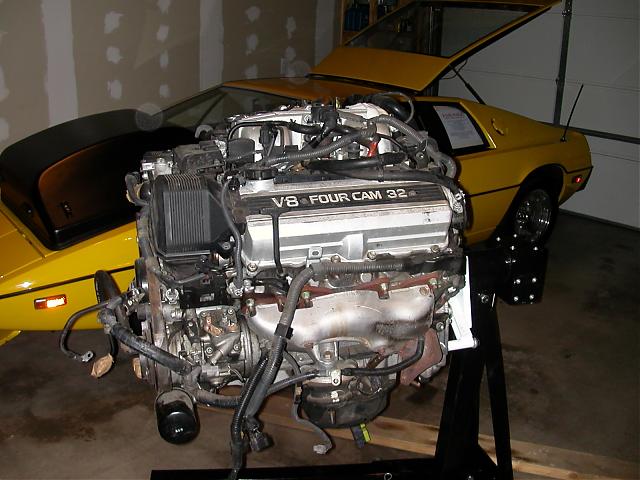

Here's the plan. RCR Superlite Coupe, G50, 1UZFE putting out 400-500 HP max. Yes, Fran I know - I need to buy the car! Still working on selling the Esprit.....please be patient. Looking for input on engine mods.
I purchased a 1UZFE on eBay for $500. It's from a 1993 SC400 with ~110K miles complete with accessories, uncut wiring harness, intake, etc. I haven't had a chance to dig into it yet but I removed ~ 38 pounds worth of flex plate and torque converter to get it on the engine stand. I'm really impressed with the engine, it's obviously been cleaned but at least the exterior looks to be in very good condition and the Toyota/Lexus workmanship and engineering is amazing. I'm not an engine person - I've rebuilt my Esprit (contracted the engine) and I'm doing a body-off restoration and engine swap on a Europa TCS. My understanding is the 1UZFE put out ~ 250 hp in stock form. I'm shooting for driveable street power in the 400-500 hp range. I'd like some ideas on modifications that will bring the power up to my goal range. My preference is to stay away from turbos and superchargers but understand I may need to be flexible. A couple of easy things to start - I figure changing the stock intake airbox and going with a set of headers will make a few HP. Not sure but I think eliminating the EGR equipment may be good for a couple more.
Any thoughts?

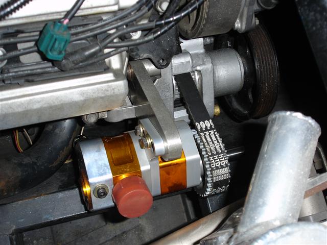

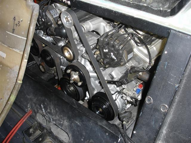

Don't lose the flex plate you may well need it for starting purposes.
On mine I'm planning to ditch the power steering pump but keep the air con, mine also came with the bizarre hydraulic radiator fan pump will will go also. I've yet to see a decent belt setup with this done as it'll need a new belt tensioner mechanism.
Anyone seen something like this done elsewhere?

Doug,
Probably not what you have in mind, but this is what mine looks like.
The Toyota Crown pulleys have some advantages over the Soarer arrangement. We didn't ditch the power steering pump, but gutted it and converted it into a layshaft for the dry sump pump.
I'd be interested to have a chat about your project sometime.

Fran -
I know you're busy and I hate to even ask - but I'd love to see a photo or two of the plumbed 1UZFE in the SLC. I've also had a chance to look at the Haltech controllers and a variety of T3/T4 hybrid turbos. It does appear they are the cost effective and logical way to more power with the 1UZFE. I'm figuring the ball bearing turbos are way to go for fast spool-up and longevity?
Thanks!
Dave L
Originally Posted by gt40fran View Post
I knew I forgot to do something today.....take those bloody pics....sorry Dave.
We dropped the DART in the back and then reinstalled the Lexus after the potential Chevy/SuperLite customer had visited....
I wil take pics tomorrow...for sure.
