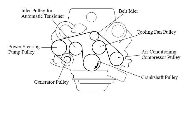

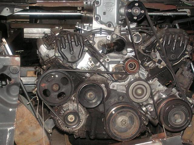

Dave, I'll be using the P/S pump, as well as the rest of the accessories. The first pic below shows how we do a S/C drive with the 1UZ, using a timing belt idler (smaller diameter than the normal serp idler so it allows the serp belt to pass around it backwards) on that bracket that I showed in the previous post. The 2nd pic shows the standard serp belt routing.
If you were supercharging instead of turbocharging, you could eliminate the P/S pump, then the belt could pass directly from the alternator to the SC, and then after the SC, the belt would pass under the idler, then go to the A/C compressor. That's not the way it's shown in these pics, but I think you can visualise it? There might be some issues with the coolant inlet/outlet connections, but nothing a good welder couldn't sort out.

My plan is to relocate the belt idler pulley in between the crank and AC pulleys to get enough belt angle on the crank and then use the adjustment on the generator to adjust the belt.
I've no idea what parts I'm going to use, I expect I'll have to make them. It'll be some months before I get around to this part of the project so hopefully another neat solution will rear its head by then.

Here's an alternative that another Lextreme member Cobber is using to drive his alternator without the P/S pump, and retaining the tensioner in the stock location. Makes the right side of the motor a bit fatter, however (pics may not be visible to non members of Lextreme.com, so I've provided links to them):
Some have also removed the A/C compressor and put the alternator in that location:
And finally, if you have space in front of the motor, you can reverse mount the alternator, but it makes the motor longer:
Lexus-Toyota alternator relocation, 1 2 3uzfe alternator relocation, lexus alternation relocation

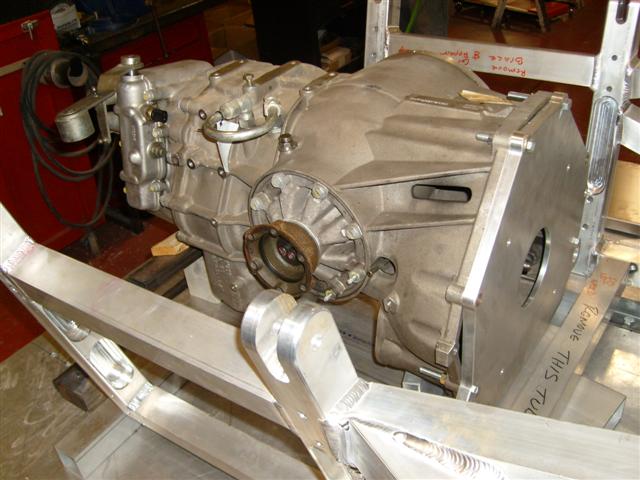

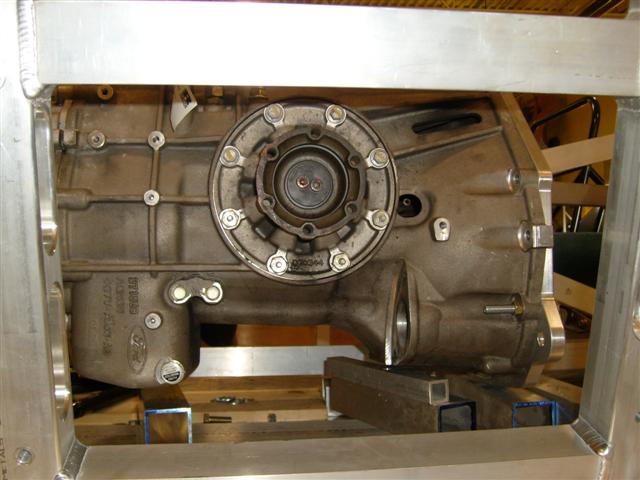

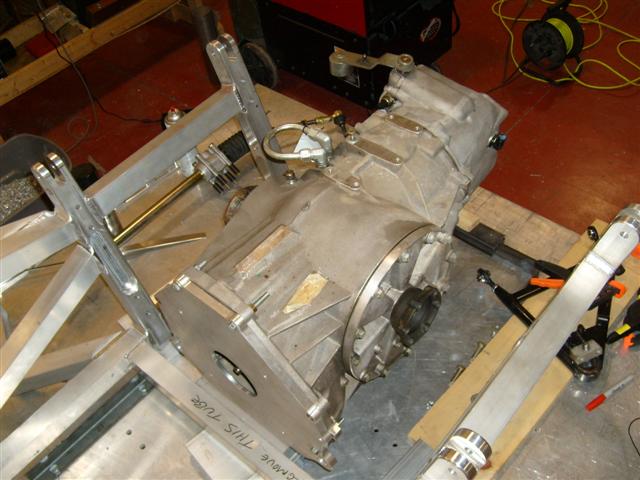

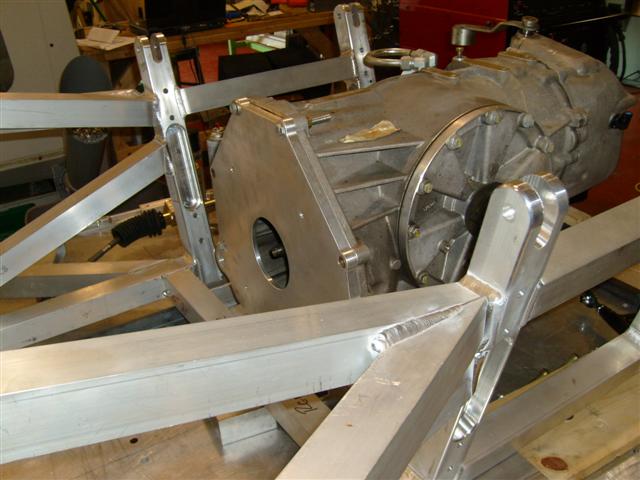

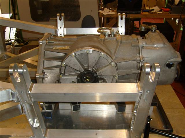

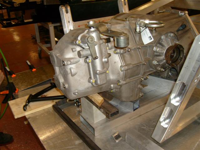

I finally got my hands on the new Ford GT transaxle....for fitment into the Superlite...
Four new units are on order from Ford racing..
The trans is a large beast to say the least but as the chassis was designed to accept a trans of this magnitude it will not be a problem...
Here are a couple of pics ...as you can see we have mapped out a trans plate and we can now finalise the engine to trans adaptation...
The first car using the GT box will be a Big Block Chevy and the next pair will be LS7 powered .....

Fran -
Looks great! That should hold up to most any HP/torque output engine someone would want to use....oh wait, I almost forgot what forum I was on! Too bad it's so far out of my price range. Oh well, can't wait for 9/24! Talk to you soon Fran.

Man, that is one beefy transaxle! How much does it weigh?
Sweet ride. Keep posting pictures, please!

Mark,
its about 200lbs and has been used in twin turbo GT's upto and above 1000hp....in stock configuration...
I will post some pics of it next to a new G50 next week....its hilarious how small the Porsche trans looks...
I am very excited to be able to use this trans for the Superlite as I am unaware of anyone else in our industry stepping outside the box to try it...
It will be the best answer for the Mega power customers we have ....its not cheap at 14k plus for retail but its new , 6 speed, lsd and cable shift like butter...next step is the solenoid activated paddle shift from Mastershift.....

Pat,
its still under 2300lbs with an LS7 and the BIG transaxle....
especially when you could potentially install 1000hp....so whats an extra cheeseburger or two among friends...
