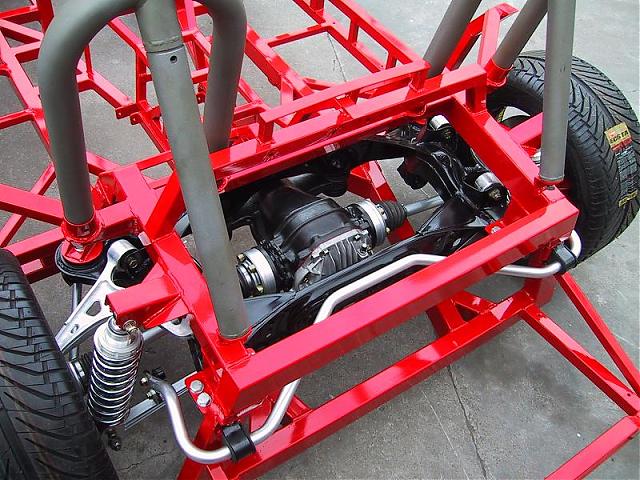

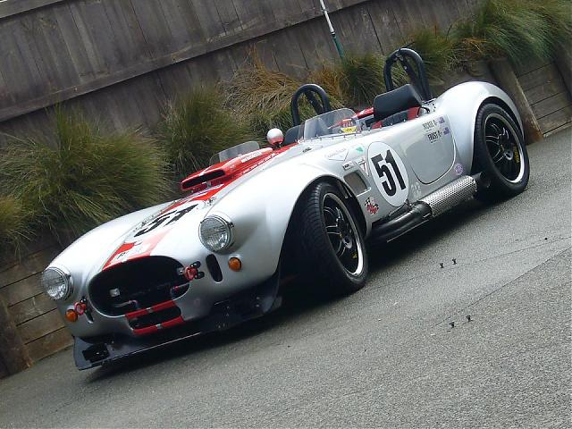

Howdy, Gents.
Just sold my 1UZFE powered Cobra. About to contact Fran and place an order for a MK2.
Cobra weighed 2000lbs dry and had a modest 350hp, running tuned length headers and two banks of 4AGE EFI throttle bodies on custom manifolds. Toyota supra indepent suspension front and back, supra 5-speed manual, custom space frame. Unbaffled side pipes and a lazy 7000rpm redline. Oh, the sound when running through the hills......!
Later, Chaps.
Gaz (Gary Frost)

Gaz....thats a cracking looking package.... did you build the chassis too??

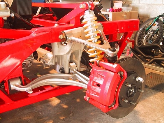

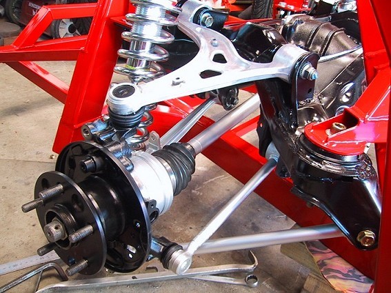

Thanks for the kind words. Yep, we fabricated the chassis ourselves out of thin wall Duragalv RHS. 70 metres of material! Light enough for two to carry easily. The design was mostly completed late at night under the influence of kentucky bourbon! Didn't make too many mistakes. Our most creative solutions occured around 3am....
The toyota suspension is simply awesome. Front upper and lower double wishbone a-arms, rear upper arms and a trick factory 3-link lower. All on factory eccentrics for alignment adjustment. Torsen LSD diff. The list goes on. We simply (!) built the chassis up around the factory suspension subframes.
The car is still in Chch, Russ. Purchased by a friend of mine. Give me a call and we'll organise a visit. 021-330-662.

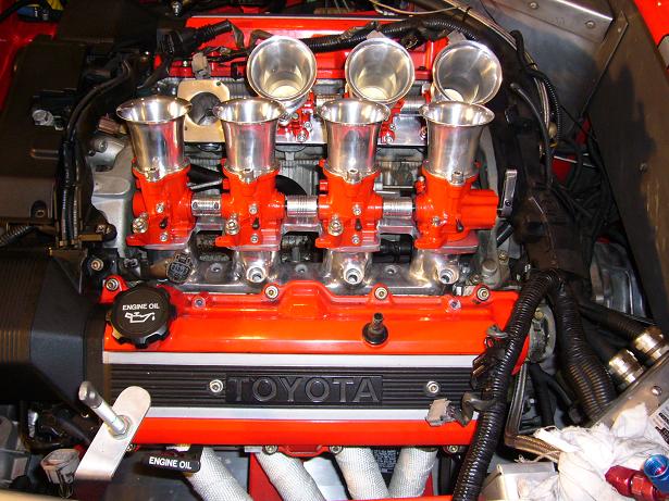

Here's a pic of my 1UZ ready for the dyno. As it sits, it needs only a battery and 3 control wires (1 for the ignition power, and 2 for the starter relay) connected for it to start & run. Gotta love the simplicity of carbs sometimes. (BTW, that's the EDIS8 module sitting just behind the Holley)
The loom is not exactly a work of art, but it's a single use loom, it's functional, and will be trashed after the dyno runs. The COP's will be sitting on ally plate in the finished version, and I hope to conceal their wiring, as well as the injectors' wiring much better in the final version.
Those are 3/4" garden hose connections on the coolant in/out - we'll circulate 150 degree coolant through the motor to bring it up to near operating temperature prior to firing it, and will do the same with the lube oil.

Dave they're Toyota Supra coilpacks, but are wearing Camry extension boots which can be purchased from Beck-Arnley. Many people with these COP setups prefer to hide the coils in the valley of the valve cover, and cover them up with the OEM plastic covers. I decided I wanted mine to be exposed, and mounted on aluminum flatbar where they could be cooled better, and I didn't really mind the way they look either. It's just that gawdawful split loom that detracts from them, IMO.
I did some comparison fitting and testing of different coilpacks, including Honda car & motorcycle, Chrysler, Suzuki, and 4 different Toyotas and decided I liked this arrangement best. I took all the pertinent dimensions for the different coilpacks with plugs, and will be putting up the results over on Lextreme, hopefully in the next month or two.
These coilpacks are the two wire type, which require external ignitors. Coilpacks with four or more connections, typically have the ignitors built in. I preferred these as some "smart" coilpack/ignitor combinations require to give feedback to the ECU on how much dwell current to give them, however my aftermarket ECU prefers to decide this itself, so it needs a fairly "dumb" ignitor setup.
