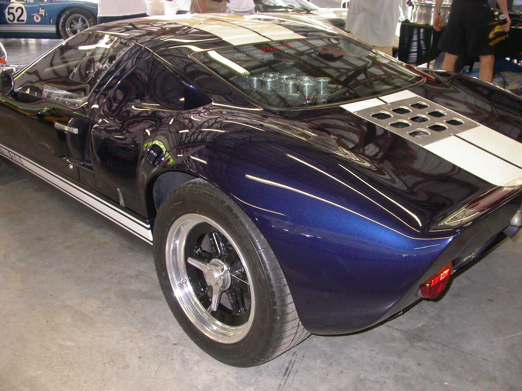

Re: Help for those RF40 owners at the build stage
Oliver,
This shot was taken at carliel in 04, it's not completely clear but I don't think one is there.
My Bad, upon looking at the blown up picture, yes the light is there.
Peter
