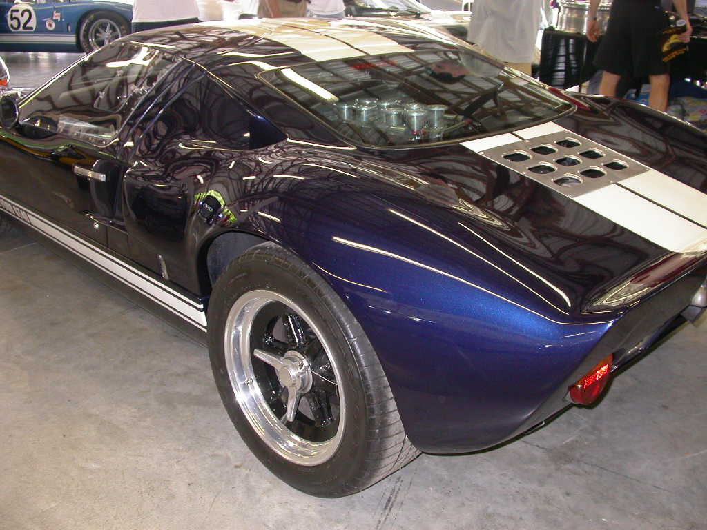

My car (Chassis #36) has the center-mounted brake light. I thought all RFs had this feature.
I am still in my build and would be happy to assist anyone with their build in any way I can.
Oliver,
This shot was taken at carliel in 04, it's not completely clear but I don't think one is there.
