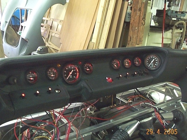

Installed a MINI SLIM LINE from Vintage Air in mine. Works great, just had to modify the front to accept hoses.
http://www.vintageair.com/catalog.asp
Simon
