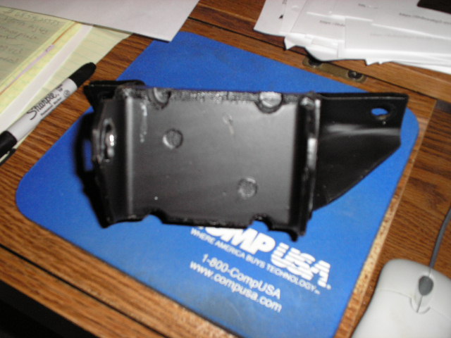

What did you guys use for motor mounts? I did not see them referenced in the manual. I bought a 302 block and I want to begin mocking up the engine and transaxle.

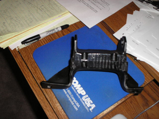

Dan the engine mounts donot have a part number on either, I just checked. They are 1 and 1/4 inches thick (tall) at the rubber bonded area. I would think you could look at moustang ones and see if they are the same ??

another, sorry the pics are not very good, these things just kinda shoot like a blob , LOL

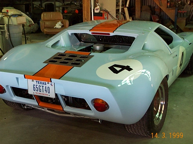

I will also be Happy to help in any way I can. I bought the basic kit (body, frame and some suspension parts) that was only offered for a few months. I have ordered some of the parts from RF and sourced the rest myself so if someone needs some help in figuring what will work just let me know.
I was getting ready to put in one more order for the rear deck louver and side windows when I read the news about RF. I made the rear deck louver last night so all I need now is the side windows.
I think I'll give Fran a call and see if he can help me out. I bet he is going to be one busy dude.
Simon
SPHameka is offline

Simon, nice touch on the additional brake light.

Hey Dan,
Thanks for the pictures.
Did the mounts come with your kit or did you buy them aftermarket?

The mounts, as I recall, are for a 67 Mustang, which is probably the same for many Mustangs in that era. I didn't have motor mounts and bought some at Autozone, fit like a champ. Look like the ones in the picture above. Just get some for a 67-68 302 and see if they work, I think they do. If not go for another year, but I bet they are all the same. Dan, I can send you mine - doesn't look like I'll be needing them!

They look like the replacement engine mounts I got a while ago for for the '65 mustang. If they are about 14 bucks each. The other thing is to check is TCP (Total control products) and one other fellow makes some nice fabricated adjustable mounts with a urethane bushing. I don't have the link for the other guy but I think the were a bit more adjustable and maybe less expensive.
Here is the link TCP version for 65'-70'.
TCP Mustang Mounts
They are a bit expensive and will not clear SVO Blocks screw in freeze plugs without some grinding.

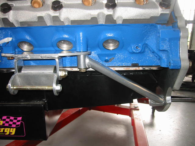

This is what is used at the DRB factory -- just fits in the same place the OEM ones do and much better for the GT40 IMHO

Very COOL 3rd Brake Light!
I want one!
Did you make it of buy it.I will be gladely to pay for another one to be made up.This is a very serious SAFTY matter being so low to the ground driving on the streets.

That 3rd break light was 'standard' on the latest series of RF's. If you look on their website (while it's still up) you'll see it. Looks like it was integral to the rear clip; doesn't appear to be a 'bolt-on' accessory.

It is molded into the rear clip.

It is molded and has been around since at 2000. My car I bought over then had one back then.

Jerry is out of town and i don't have a picture of the back end.. Ron do you know if 015 had one.
