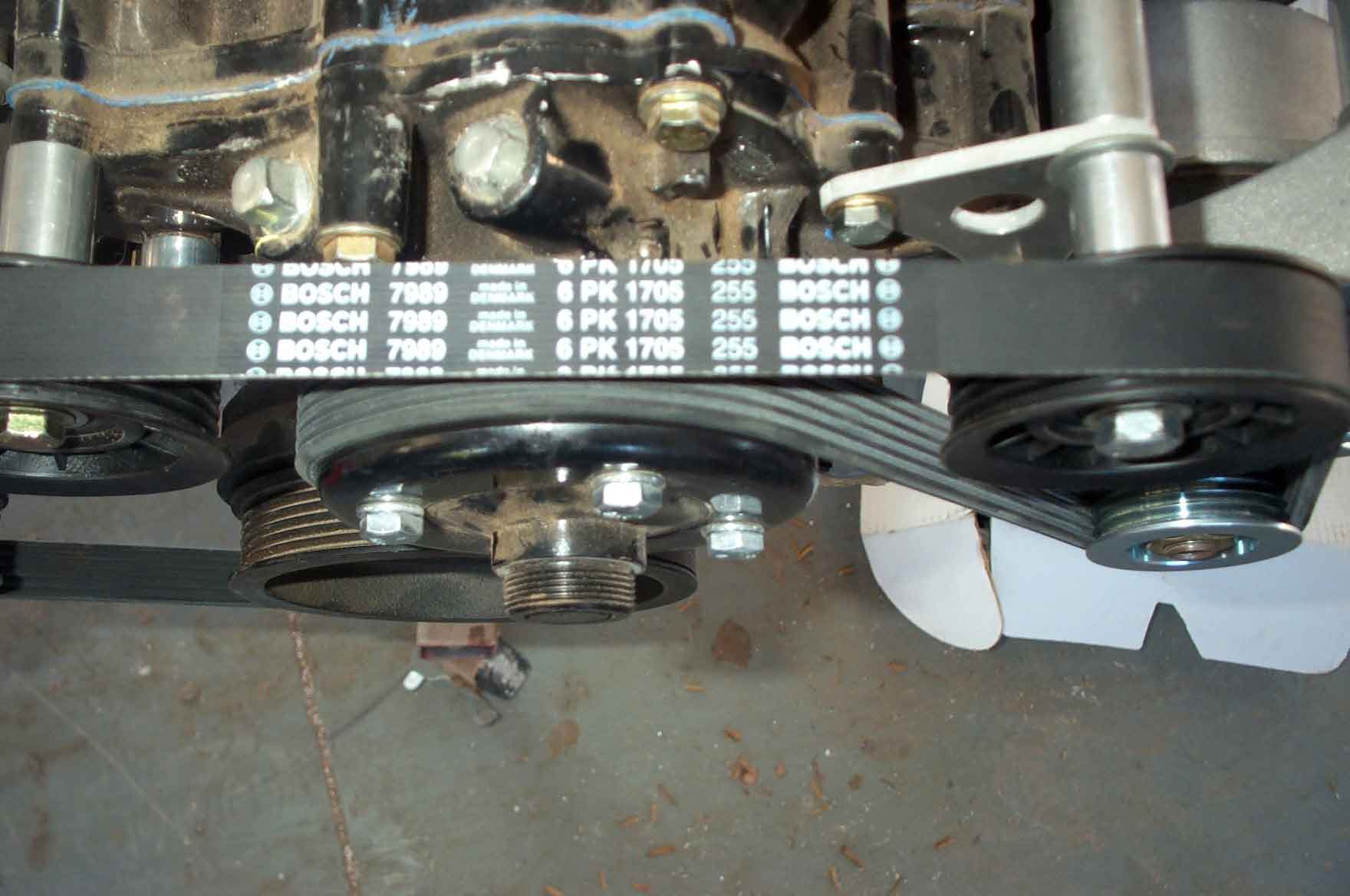

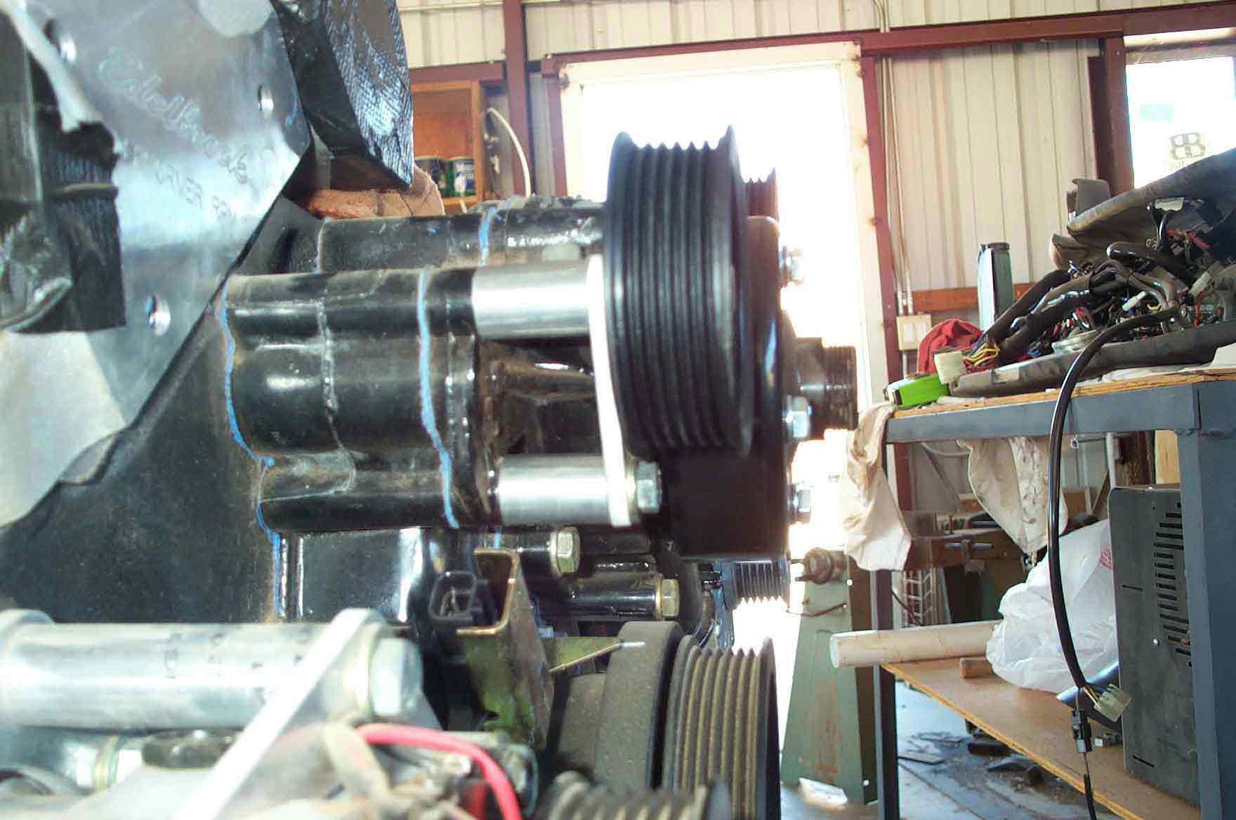

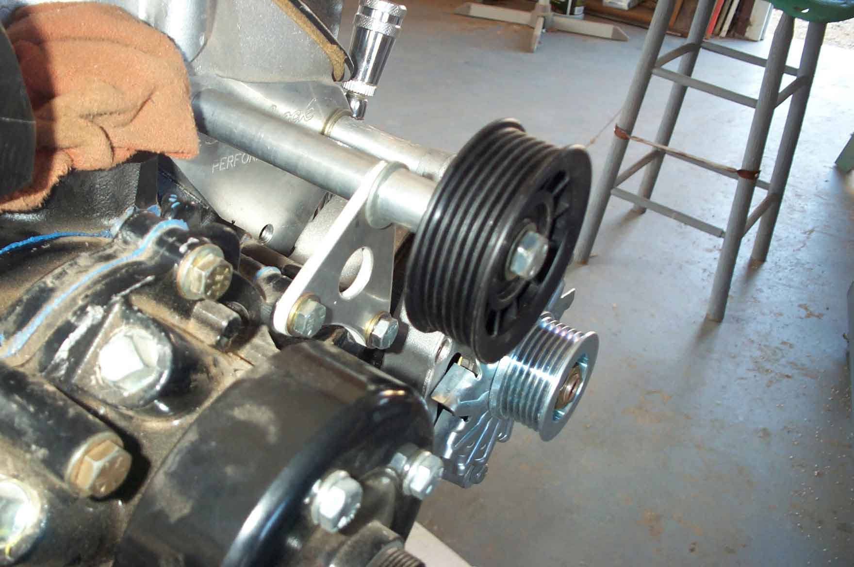

I think John Schneider has some close up photos of the pulley application. I'll see if he can post them. As far as the spacers go, I bought the extra ones I needed at the local hardware. Believe it or not they had them in chrome too.
I got it last night after varrious combinations - it was a bit like a puzzel. As Ron said I had to bore out the long alternator spacing.
Thanks all
I know you said you've got irt now but maybe this will help the next guy out.
I only had to shave and shime a few spacers. Not easy but not all that bad either.

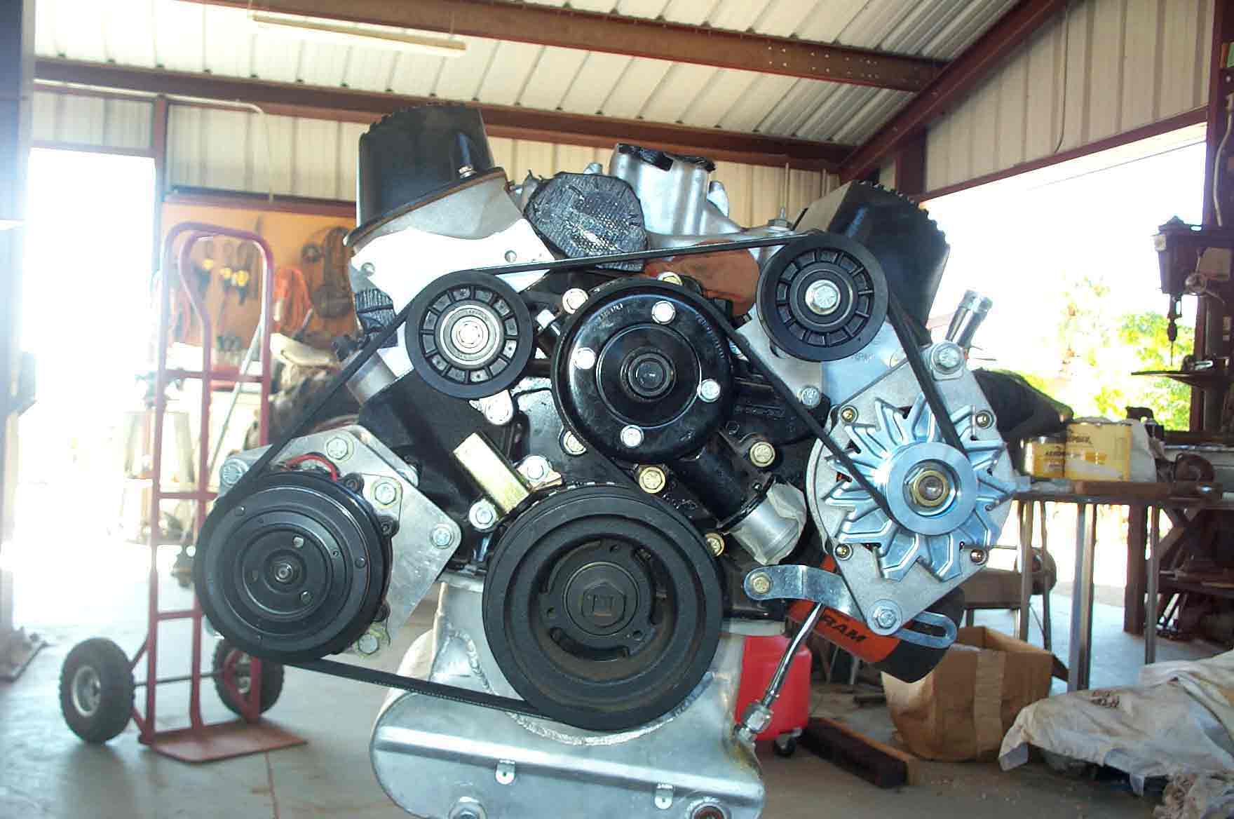

John, thank you very much. One thing that I also found while looking at the pictures for the MoTec wiring instalation was a bracket from the upper iddler wheel to the top of the alternator. It only shows upon on the photo of the front of the engine sent with the MoTec kit.
Mike,
Me and John removed those ugly hose pipes and then we did tap them and installed a plug.
