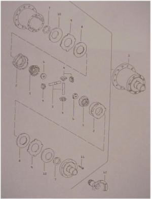

OK, great information here. One point of clarification so there's no uncertainty: the LSD from a 944 fits into an Audi derived 016 without machining - that I understand - how about the spider gears? In other words, the 944 LSD replaces the (weak) Audi spider gears with a different arrangement?? Something like some slip plates and 4 spider gears instead of 2?
The reason I post the above is that it seems from related posts that the Audi spider gears are a particular weak point that can break with the torque of a SBF.
Thanks.

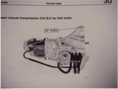

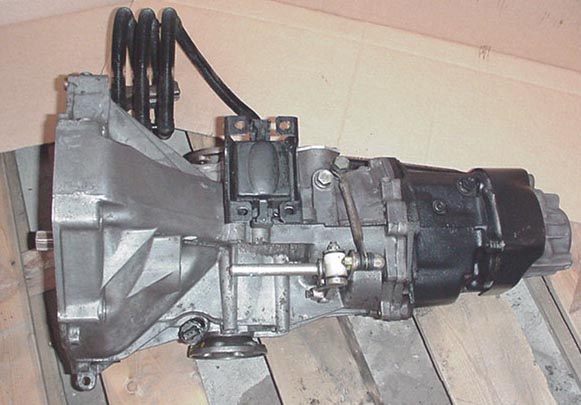

The 944 turbo LSD has 4 pinion gears and different spider gears. Hter is an exploded picture of one. Also, I attached a picture of a 944 turbo transaxle so everyone can see the input shaft and the oil coller.
I'll try again. I don't know what happened to the pictures.

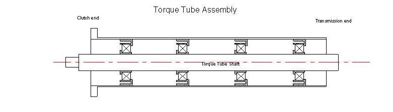

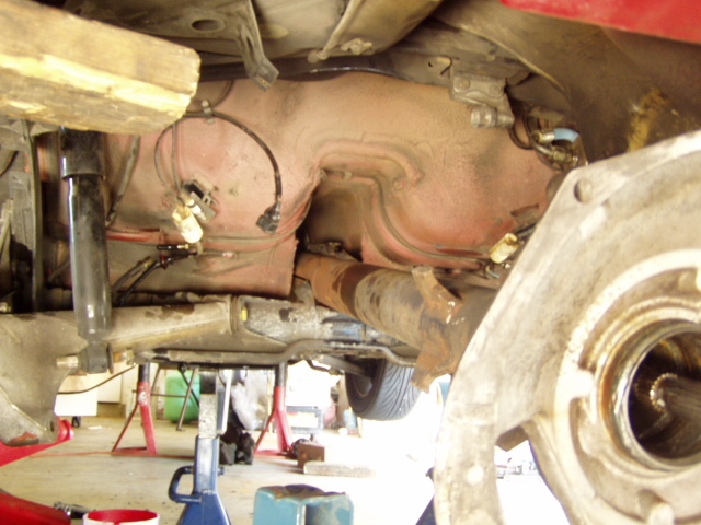

What I should have said is that there is a substantial amount of older posts that talked about the 944 transaxle and these indicated that the major stumbling block to using it in the 40 was the fact that they had a torque tube that connected the front engined Posche 944 to its rear mounted transaxle. From a "Experts: Porsche Repair" forum, I got the following information
- "The torque tube is basically a rigid housing connecting the 944's bellhousing (clutch housing) to the transaxle at the rear wheels. Inside the housing is a driveshaft supported by three or four ball bearings"
I'll attach some photos, hope they clarify things.
Regards
