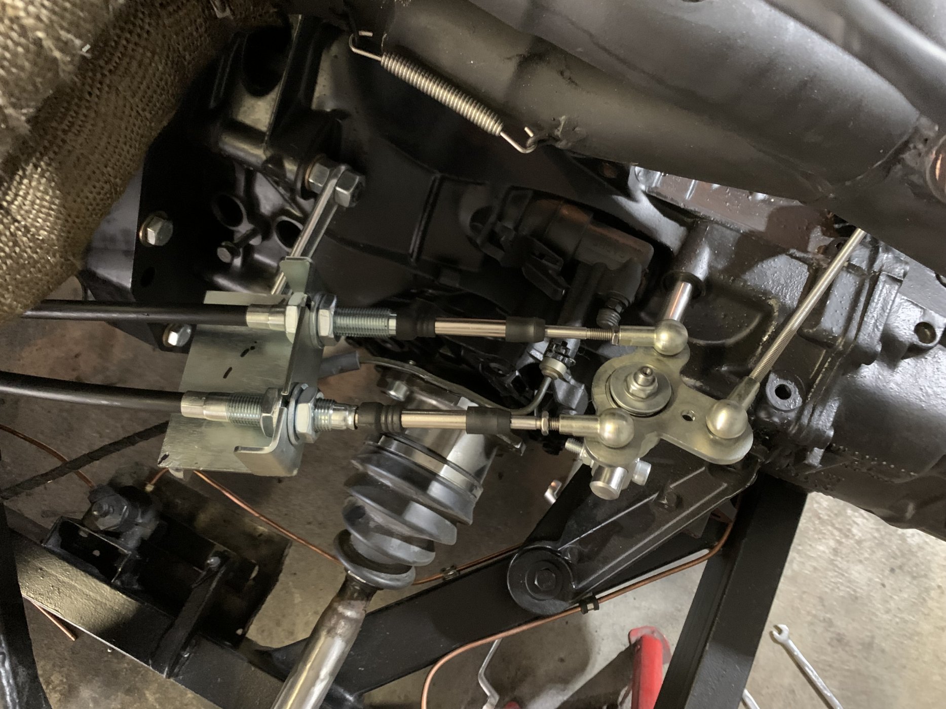

i have the shifter system from GTracing uk for my 01e gearbox. But no real idea how to set this thing up right to get it running the way it should… The great thing is you dont get any informations from the selling Company.
Anyone get the system dialed in right ??

I have the same setup at my garage table at the moment waiting to be installed, I could need some details of the assembly.

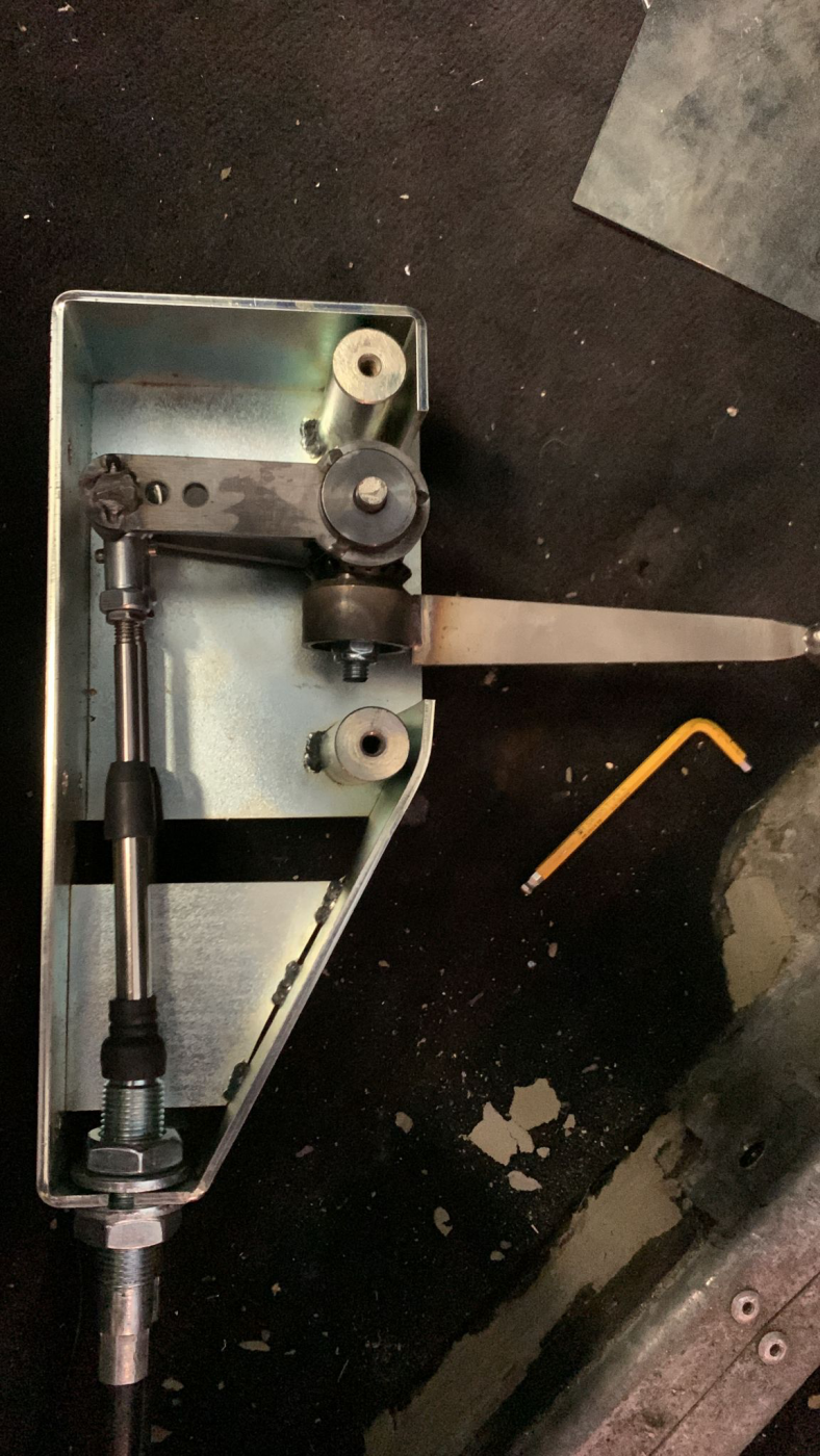

Ironically this is the very same product I bought from mark - it doesn’t work ( unless I’m missing something? ) there simply doesn’t seem to be enough side to side play to accurately select the 1to 2slot 3-4 slot etc-
I binned that shifter short after I bought it, couldn't throw it from left to right without bending the shifter.
