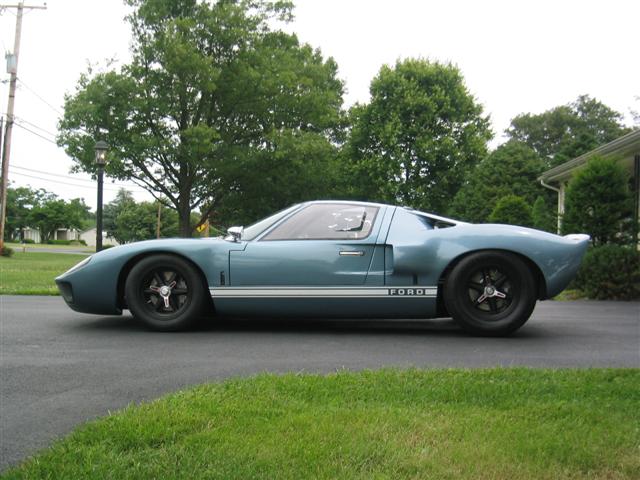

My front tires are as big as I would go. They are very close the body
Ron McCall
I ahve 225/50/15s on the front and 295/50/15s on the rear. They fit perfectly!

ahirsbrunner said:
Hi Ron,
Did you need to trim the rear lip for the 295s, or the fronts, or both?
Thanks & Regards,
Al
Only the rear. NOt very much at all.I could have probably gotten away with not trimming them,but I wanted to be sure.
